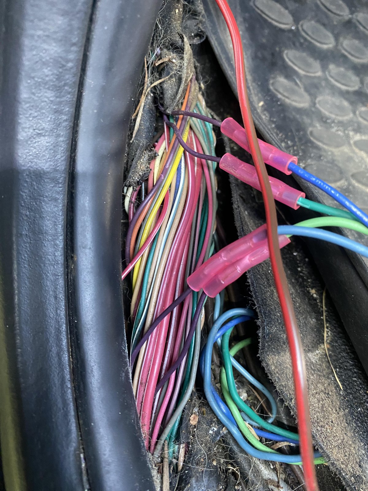

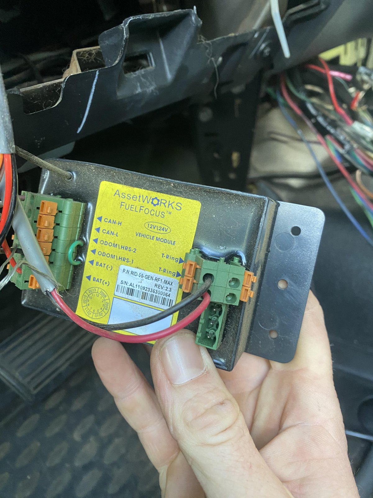

Digging around underneath steering wheel, anyone recognize these purple wires or this device? Maybe rear speaker or door lock wiring? The spliced out thicker gauge wires lead to nowhere (device is not hotted up and bypassed)unnamed (1).jpgunnamed.jpg

Digging around underneath steering wheel, anyone recognize these purple wires or this device? Maybe rear speaker or door lock wiring? The spliced out thicker gauge wires lead to nowhere (device is not hotted up and bypassed)View attachment 413449View attachment 413450
Hell no lol. Why didn't they solder those wires. That department probably paid them thousands of dollars for that
The purple wires are in the OEM harness. The device is probably some aftermarket fuel system thing.
Seems to aggregate fuel related data - consumption, MPG, etc for asset management.
