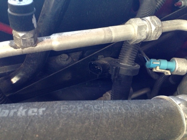

on the 07+ we have this regulating system (Regulated Voltage Control or RVC) that basically controls the alternator when it sees more/less drain on the battery.
Being that I have a decent sized stereo as well as HIDs (with the relay harness) on my truck, I looked for a way to turn the RVC off. There would be points while driving that my HIDs would start to flicker because the ballast weren't getting 12 volts. I thought it was the ballast and swapped sides and even purchased new ballast with the same results.

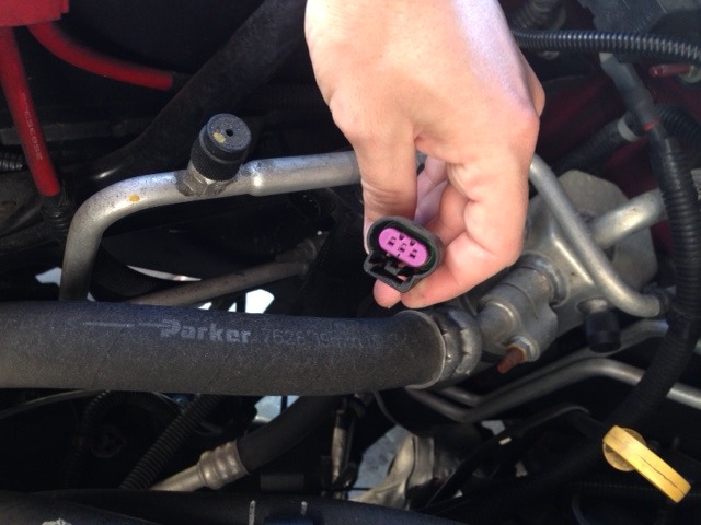

Well, there is a wire connection on the negative side of the battery that controls this system. If you unplug it, your alternator will continue to charge and will stay around 14v while driving. I've had this unplugged for almost a month now with no issues what so ever. No more stereo drain, no more flashing of my HIDs, nothing. I haven't seen any consequences of disconnecting it either.
Here's a few pics you can see the plug and the wiring to disconnect. I put some electrical tape over the connections so they don't rust or get corroded or anything.

Awesome! I'm going to do this when I get home tonight. I experience some slight flickering as well when I have everything running and my stereo up

Nathan,
I do Fire & EMS with my 08 Chevy Truck and have been having a lot of issues with this system while attempting to transmit on my radio. Today I finally researched this and found this thread. I unplugged the sensor and it appears to be working perfectly for me. I realize this thread is two years old...but have you had any issues with it being unplugged?

Nathan,
Never had any issues with it at all while I had my Yukon
