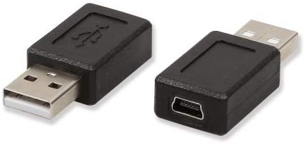

Also ordered a USB 2.0 A Male to USB B Mini 5 Pin Female Adapter Converter: https://www.amazon.com/gp/product/B015PGGUWA/ref=ppx_yo_dt_b_asin_title_o02_s00?ie=UTF8&psc=1
For the mini that came off the old radio (Pictured below)
Mini male USB B unplugged from radio:
Adapter from Amazon (coming tomorrow):

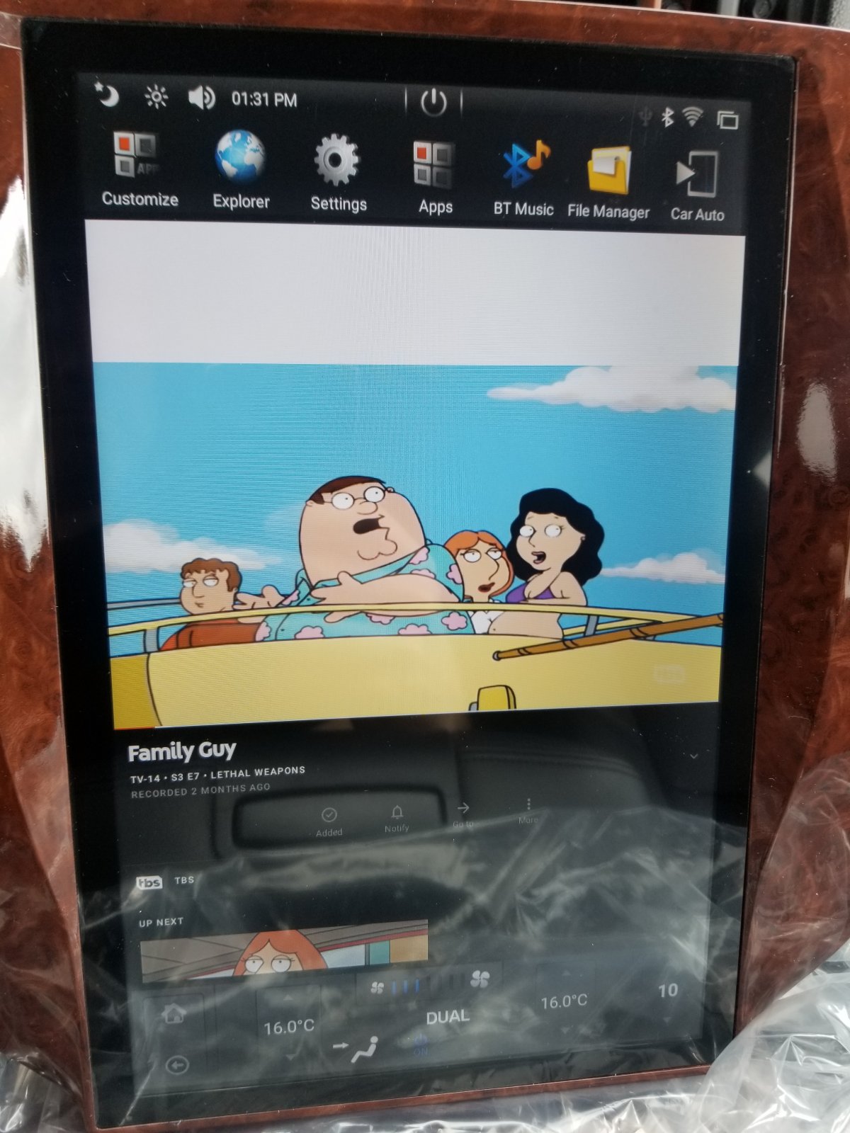

All of the complaints about it being slow with annoying turn signal noises and other nonsense don't exist with this model or software update. It's snappy, even when hard booted from a dead start.
Video is unobstructed by the interface in Youtube or Plex:

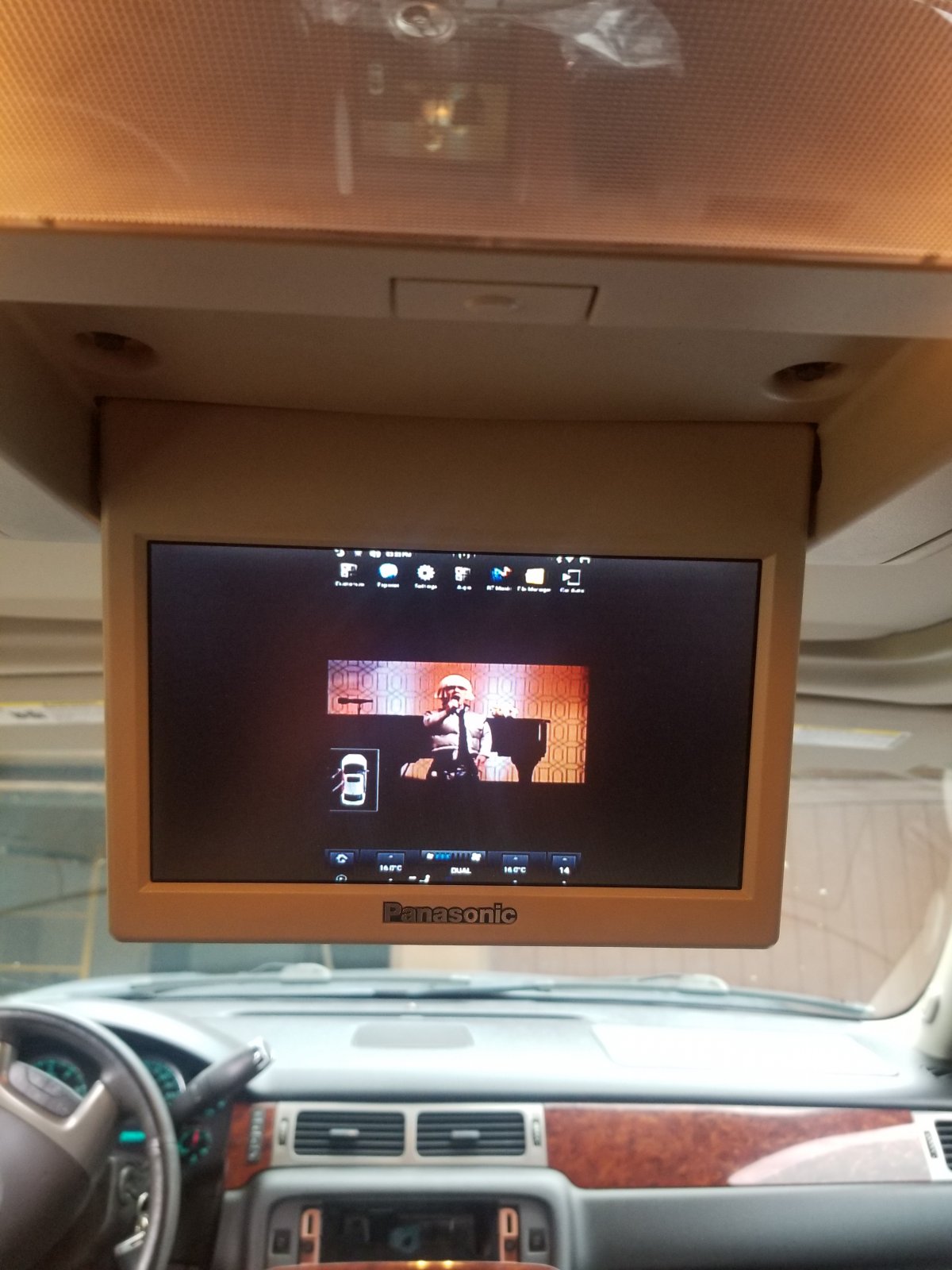

Rear entertainment is useless. It's a literal full-screen portrait mode of the unit, reducing the actual video content (see pic). I'll keep it connected for novelty reasons only. It's obsolete tech anyway. IR headphones and drop down low res screen is replaced by tablets and bluetooth, imo.

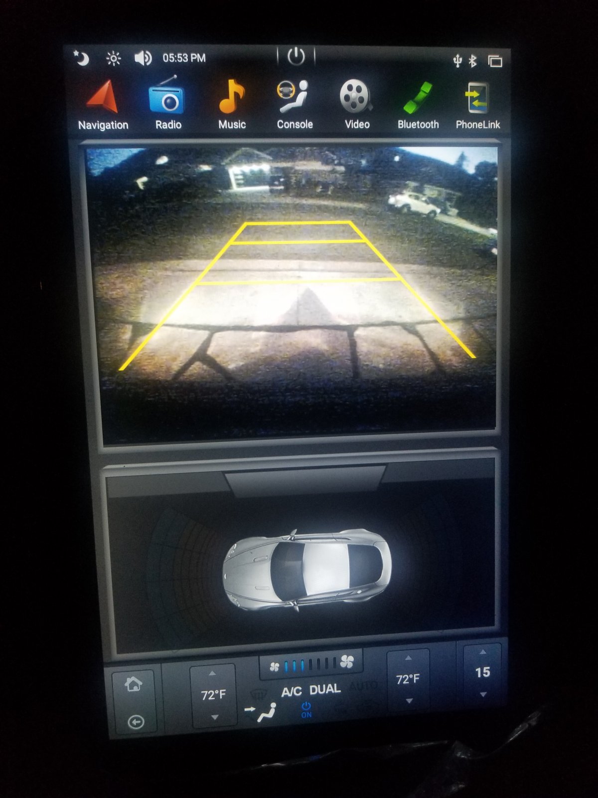

My biggest complaint is about the factory reverse cam. I cannot get it to show me anything. This link was of some help, https://phoenixautomotivellc.freshd...les/36000180870-px6-backup-camera-not-working in that I can enable interface 8836, which means it went from displaying "no signal" text to just black. It might be some kind of codec issue.

Ok, the cable came and I got the factory backup cam operational. And I had to re-disable interface 8836 to make it work.
And that's it! It's a keeper.
