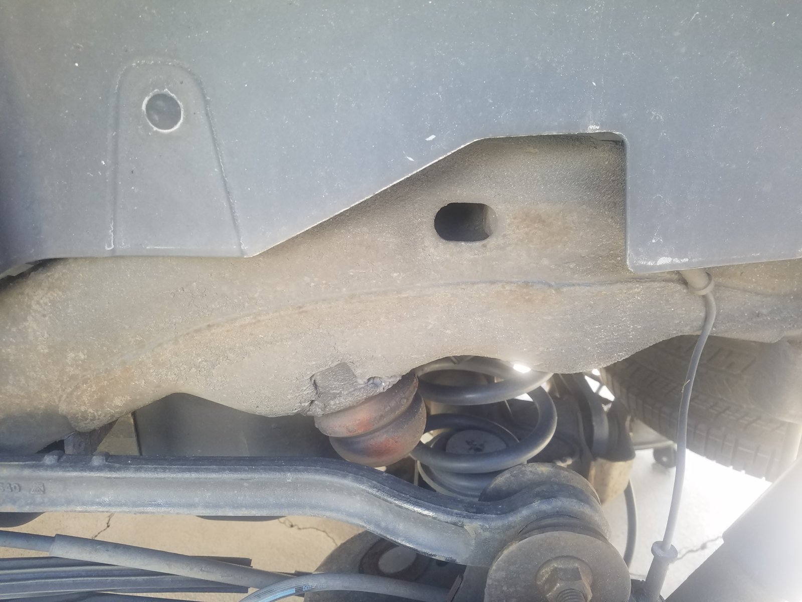

The way I do it I would charge atleast $200. If I wasn't lowering their Tahoe at the same time it'd probably be closer to $300. I do quite a bit more then just simply cutting the bracket off like the pictures show.
waxworkz
Aug 9, 2010
689

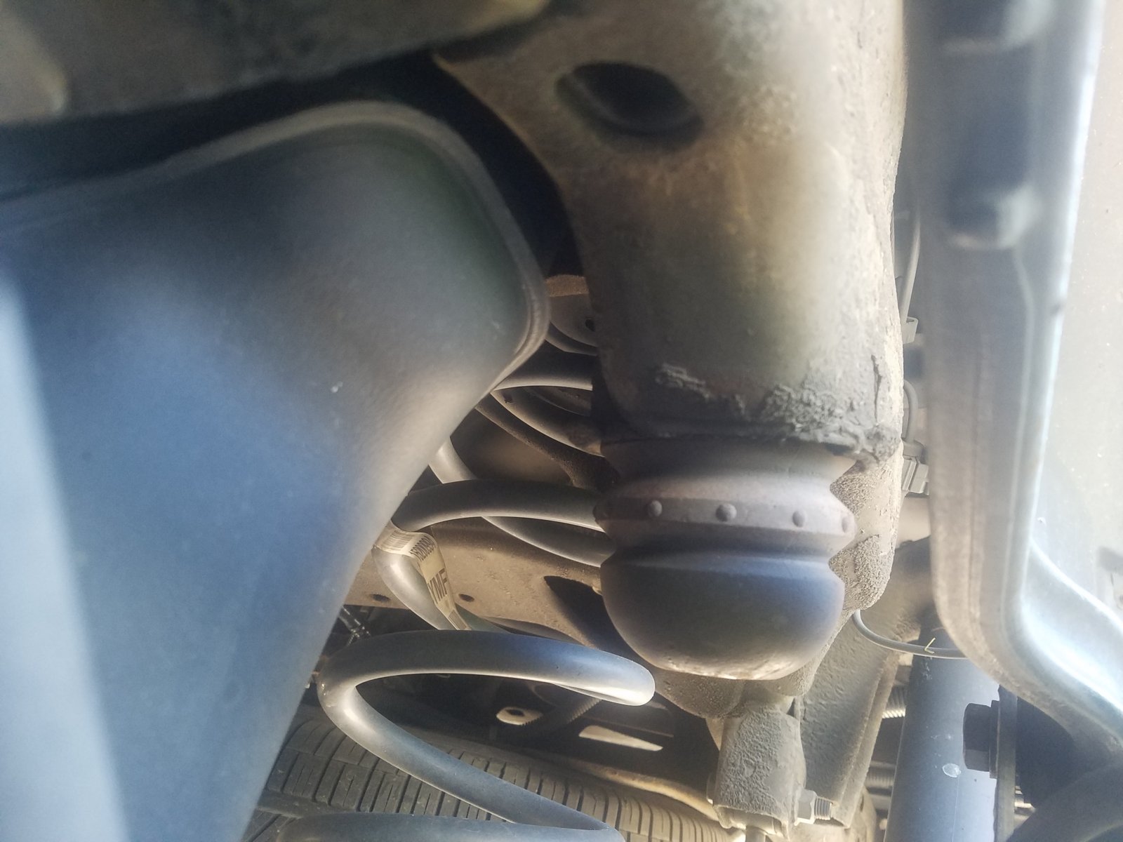

seriously, 30 mins?? took me the better part of a day to do both sides. but i have a burban and the drivers side runs so damn close to the tank. that and on the inside the bracket goes into the spring pocket so i couldnt even grind down the welds all the way. does ride a hell of a lot better now!

I was charged $150, not sure what the going rate for this is. Your in Houston, there's alot of air ride shops in your area I would call around and see who gives you the best price..
Thanks, I will have to look into it and the only problem I can see is if no shops know what the free travel mod is.

i had that problem but just print these pictures out and tell them exactly how u want.

I did the pass side with a sawzall and the drivers side with a plasma. Just be sure for the drivers side to put something thick enough or a piece of fire blanket between that and the tank.
Ask me how I know????!?!!?!! LOL
