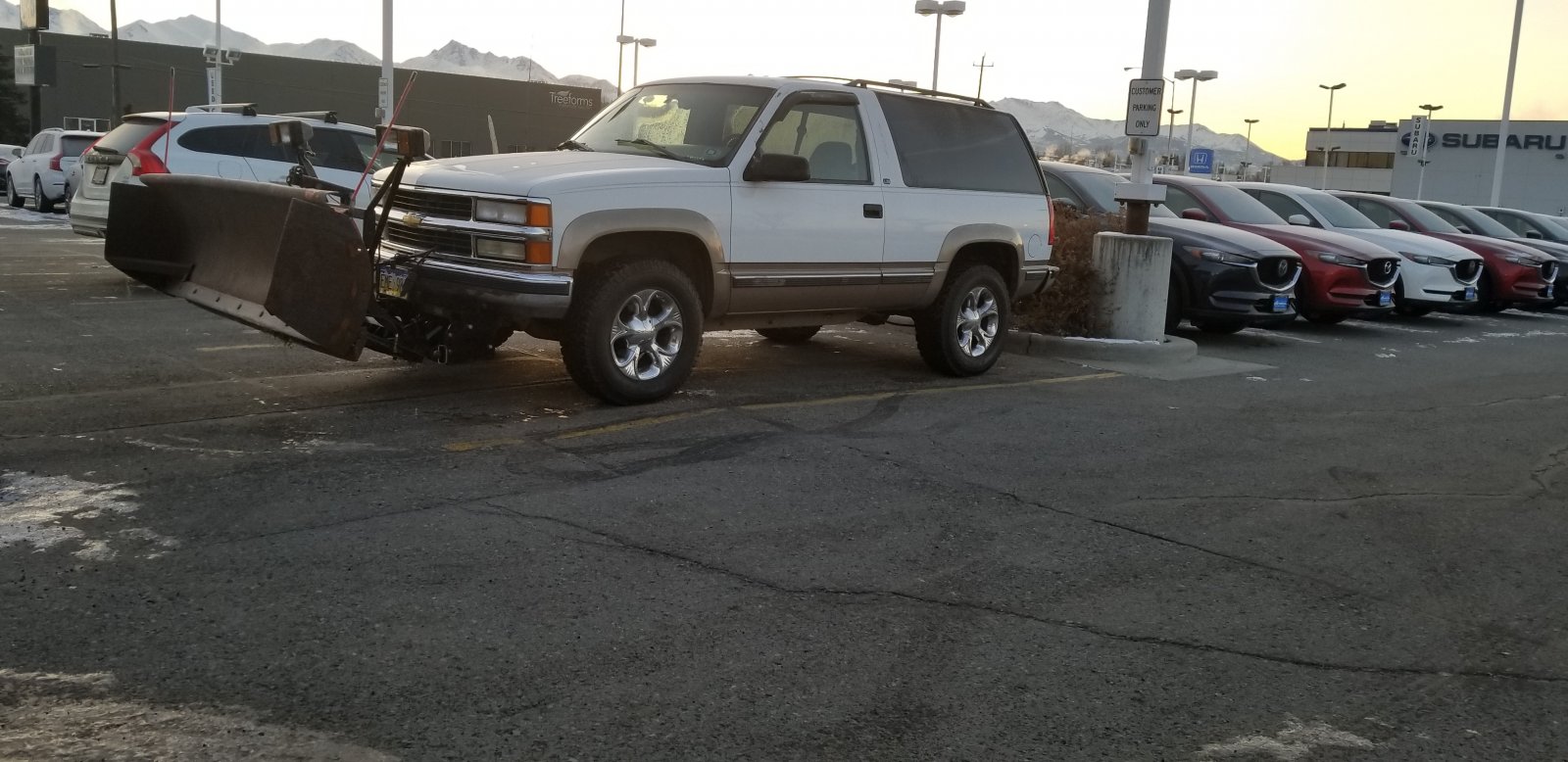

I just picked up a 1999 Yukon for the sole purpose of plowing the 1-mile dirt lane I live on. The Yukon came with a 7.5’ Western plow with poly blade. The previous owner purchased the Yukon with the plow, and removed the plow for the 3 years that he used the Yukon as a daily driver. I put the plow back onto the Yukon yesterday and it completely crushed the front suspension, to the point that the lower plow frame was dragging the ground along the high spots on my lane. My guess is that the coil springs wore out during the time it was used without the plow attached. The Yukon shows signs of having had at least 2 different plows mounted to it over the years, so it's probably been rode pretty hard.
I am looking for a solution that is the best combination of low cost and ease of install. I can get heavy duty coil springs for around $100, but not sure how big of a job that will be when you take into consideration rusted bolts and such. Another option I found is the Timbren Front Suspension Enhancement System, which replaces the front bump stops with a hollow rubber “spring” that would act sort of like a ride-rite airbag on a leaf spring setup. The Timbren setup is around $250, but the install looks to be super-simple.

I did jack the front up to get the weight off before cranking the keys. My guess is that the front end is just flat wore out - but that's ok, I'm just going to beat it up worse anyway. I basically bought the plow and got the Yuk for free, so whatever use I get out of it is a bonus.
I'm going to look into finding air shocks that will fit. I don't see any listed anywhere to fit the front, so I'm going to pull one of the current front shocks off, get some measurements and see what I can find that will work. I will take the groups advice and reach out to Monroe, but I have never had much luck with customer service folk.
My plow does have wheels that pivot up out of the way when the plow is in use - if that's what you're talking about I can't imagine those holding up to the ruts and rocks along my lane.
