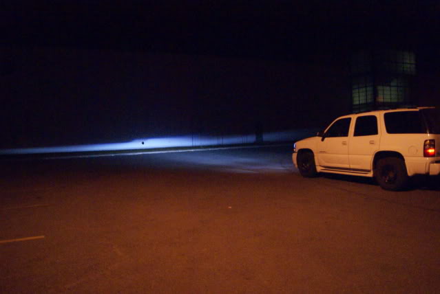

Yeah, I don't have a Tahoe but the TSX's barely fit the Denali headlights, at least without having to completely tear apart and custom fab the mounting brackets. I had to shave mine down a little bit to fit the bigger projector bowl in there. Just don't know if you'd have the clearance.
As it was it basically didn't fit from the added depth. I had to heat and mold the washer fluid reservoir around the ignition end of the bulb to fit it in.
I will say if it does work, the end result will kick ass, though. I absolutely love my headlights now, and often find myself wanting to drive in the dark for no apparent reason.
