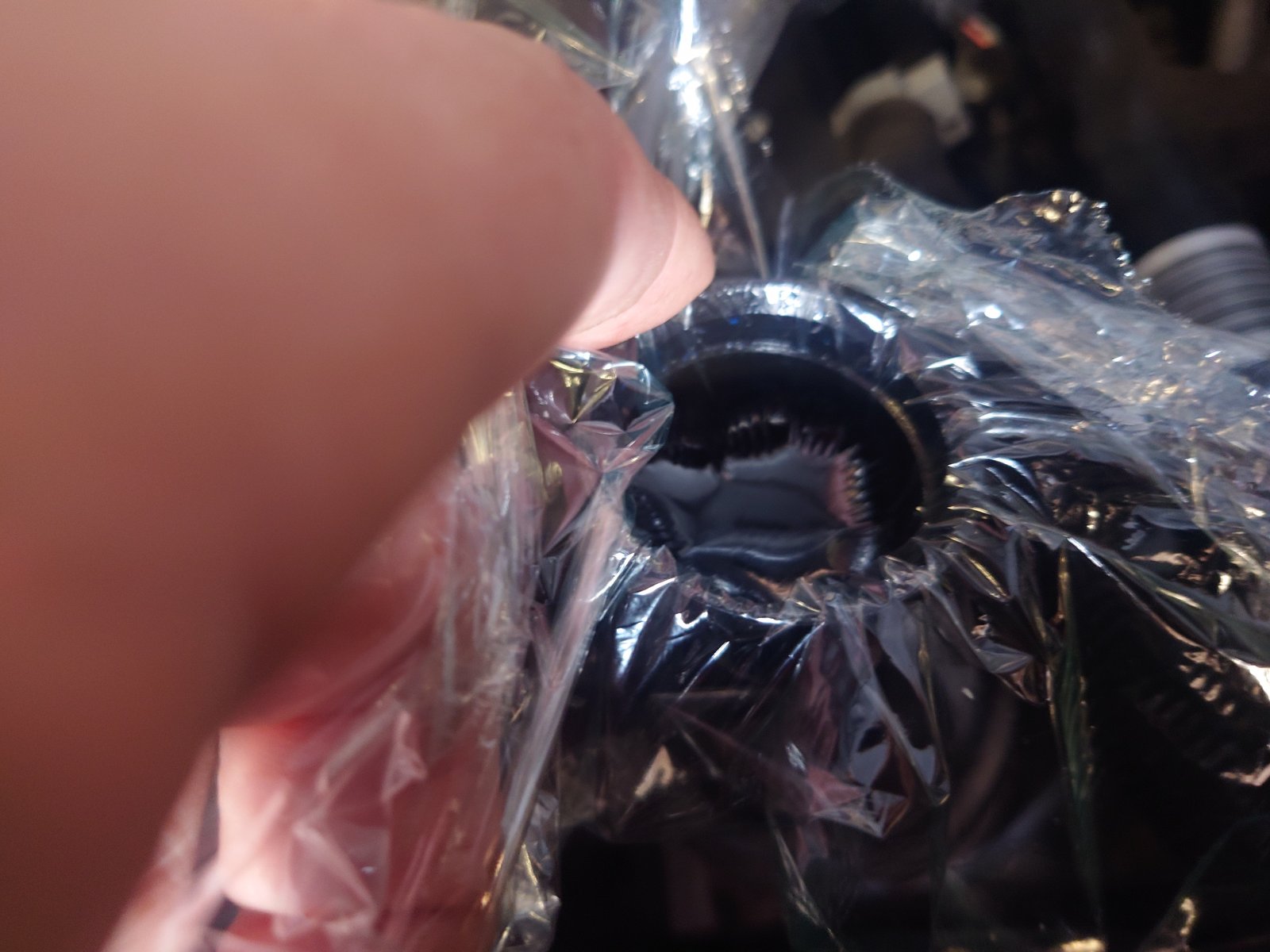

The engine has 130.000 Miles, but sometimes a rough idle and it had ticking from the hydros. But I think it was getting better, after the second oil change with good oil and after i flushed with 1 liter diesel, before oil change and swapped the O-Ring from the oil pump, which lead into a slightly better oil pressure.
Now the ticking from the hydro is completely gone and and the idle is way better.
Until the next oil change I'm not sure if the oil consumption is as well better, but I read so much negative about the PCV valve that I checked that.
As i wrote, I pult down the hose and touched the PCV while the engine was running, but there was no blow out, what is probably a good sign for a good piston and cylinder condition.
There was vacuum at the hose and when I connected the hose again, I open the oil cap but I felt no pressure or vakuum.
But I did the test again with some cling film and you can clearly see that there is a vacuum, so I think that should be fine. I pulled the hose off the PCV valve again and checked if there was any oil. There was only a tiny little bit.
