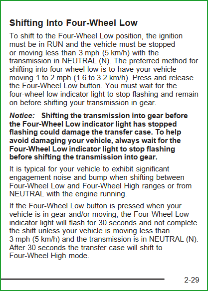

For the mode switch in and out of 4LO, the truck can be rolling up to 3mph (and rolling can help it engage smoother, although there will still be an audible clunk when it happens). Check the owner's manual for your rig.
