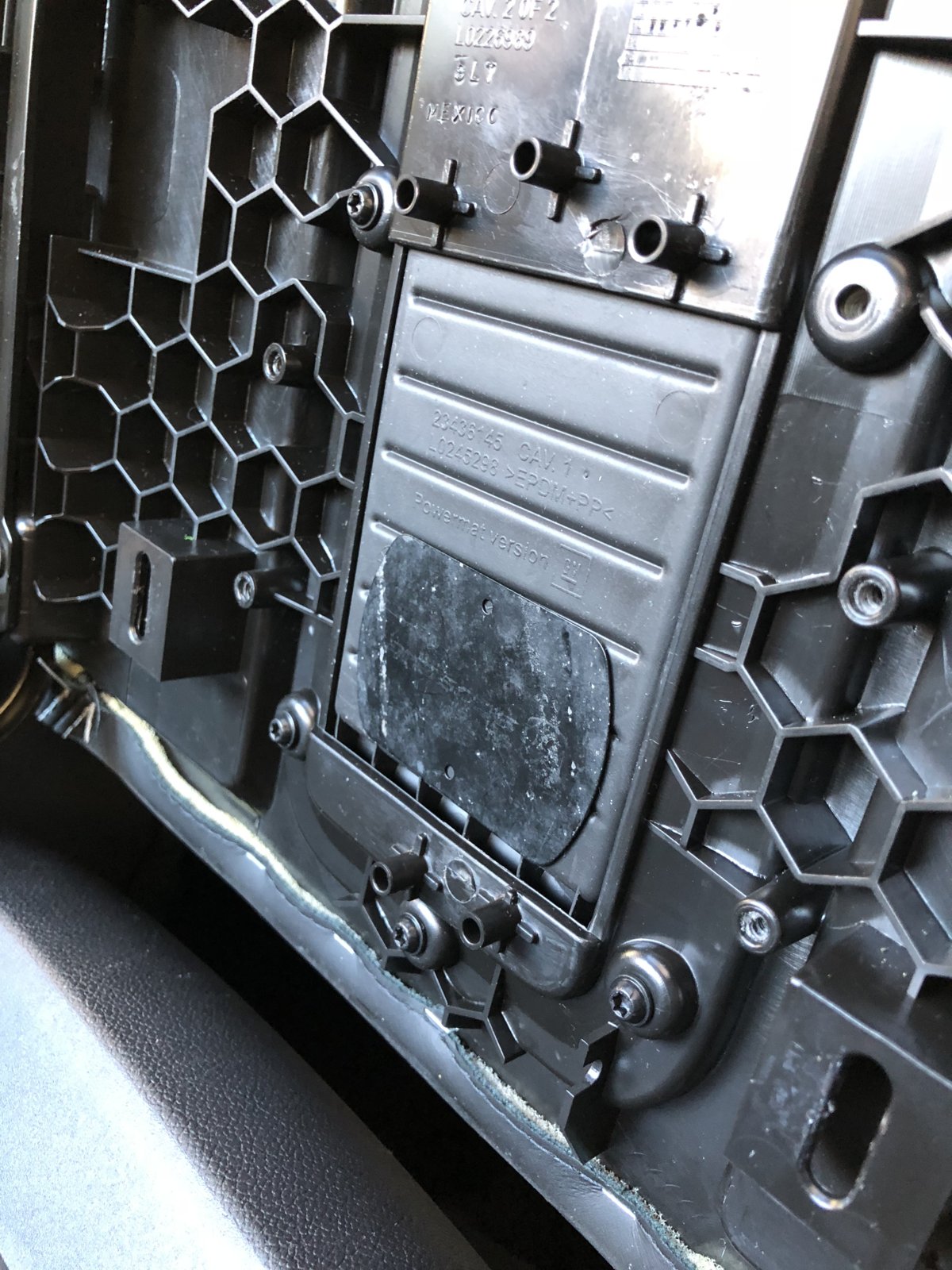

the GM wireless charger has 2 distinct problems, which can be fixed.
#1 the GM pad is nearly 2 mm thick, this greatly reduces charging capability especially if you have a case. I replace GM pad with a thin leather or leather like fabric.
#2 the GM pad is not made big enough to support the larger phones, S7-S8 and Iphone8.
by removing the center GM pad you can enlarge the area by removing the GM pad.
Mine fits my S8 with a case on it perfectly now.
