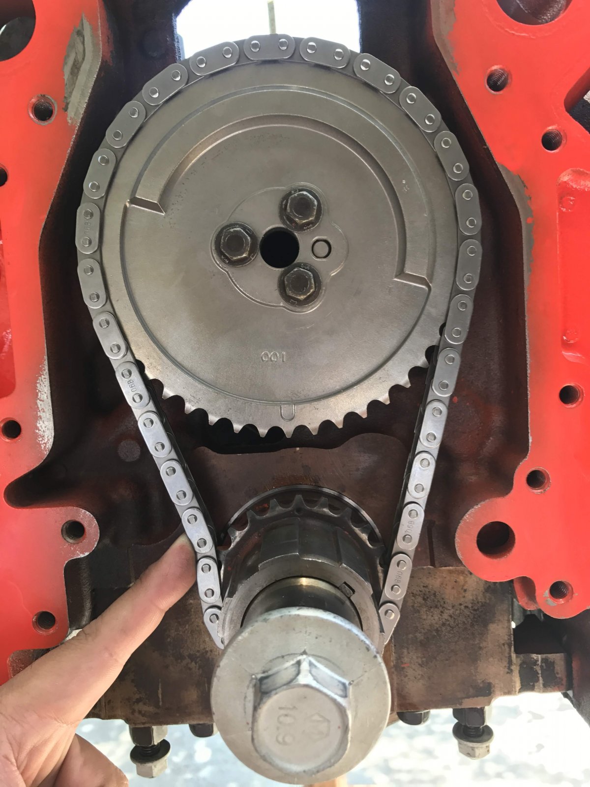

So I looked back at my old pictures of when I rebuilt this engine and if you look closely the sprockets are off by a tiny bit. So I wanted to ask some more talented people on here should I bite the bullet and reopen the front to realign?

all aftermarket cams need the p0300 code deleted as the lope you hear is actually misfires. so they will misfire at idle and throw that code. part of the cam game. seems like you need it tuned. timing marks look ok to me.
