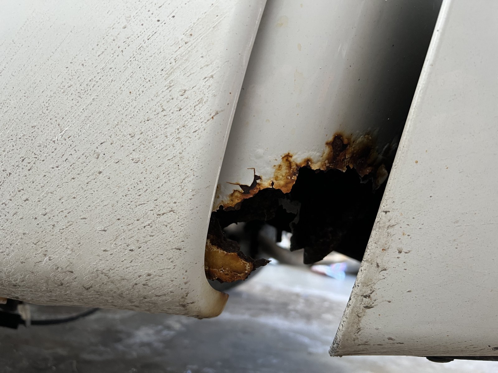

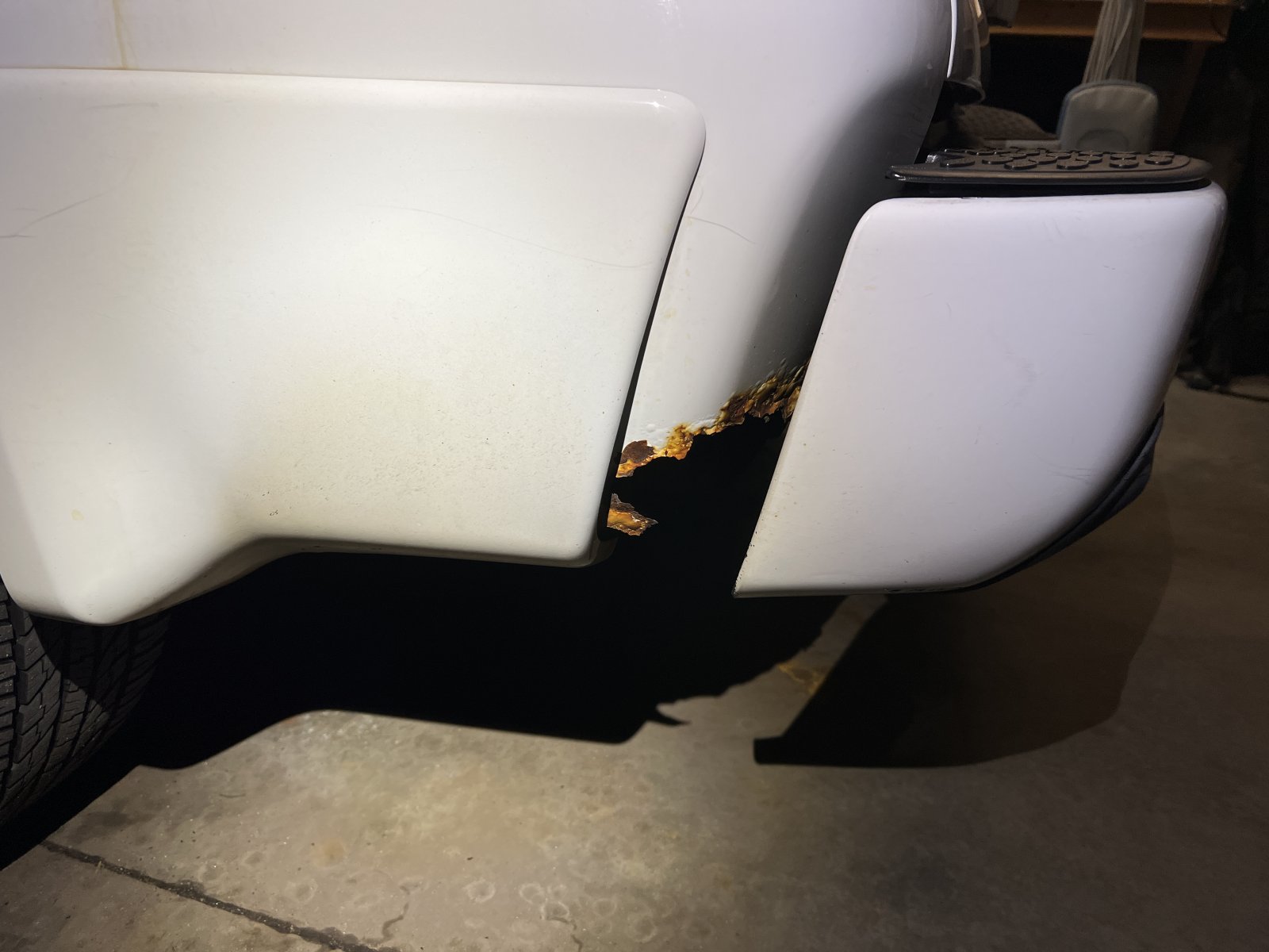

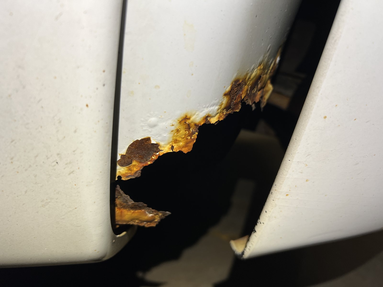

2004 Yukon Denali - Is damage of this type repairable? Found a bunch of sand/dirt/salt stuck up in the rear quarter panel - threw a hose on it at moderate pressure and it gave out.
Seems like the GMT800 kicks debris up in this panel as well inside the actual rear bumper. Any hope to repair this or am I getting into some serious body work?
Minnesota winter snow/salt is tough to deal with on a vehicle this old but thankfully this is the first major body item i have had to deal with. Any input would be appreciated.

you can buy the quarter panel and have it welded in/painted yes
91RS
Nov 15, 2009
2,587
2,033
GA
Anything is repairable if you want to spend enough money on it.
tom3
Jul 15, 2019
1,051
1,622
Pretty easy repair for a body shop actually. But I'd crawl under the machine and have a good look at other areas and parts for advanced rust too.
TollKeeper
Feb 21, 2010
3,026
5,992
Brighton, CO
Check the door jams specifically. Also be sure to check your frame to cab mounts.
But yes, very repairable. Assuming its nothing more than what we are seeing (and thats never the case), it can be easily sectioned.
JCODOHERTY
Jul 22, 2020
62
31
SE Connecticut
they sell a cheater panel that you can seam in yourself. Use real bondo products and rivet/self tap the panel in place to hold it together, with clamps.
