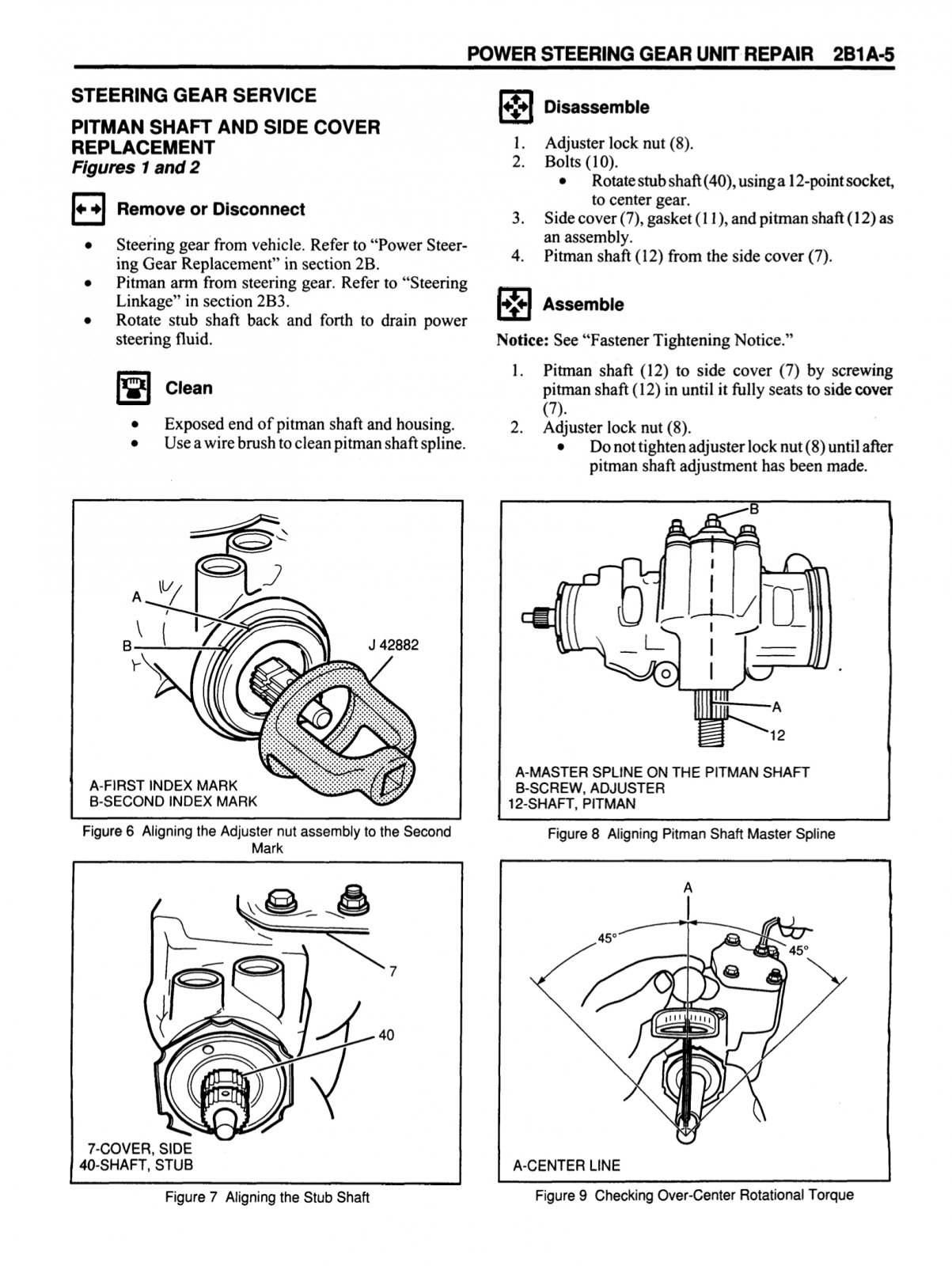

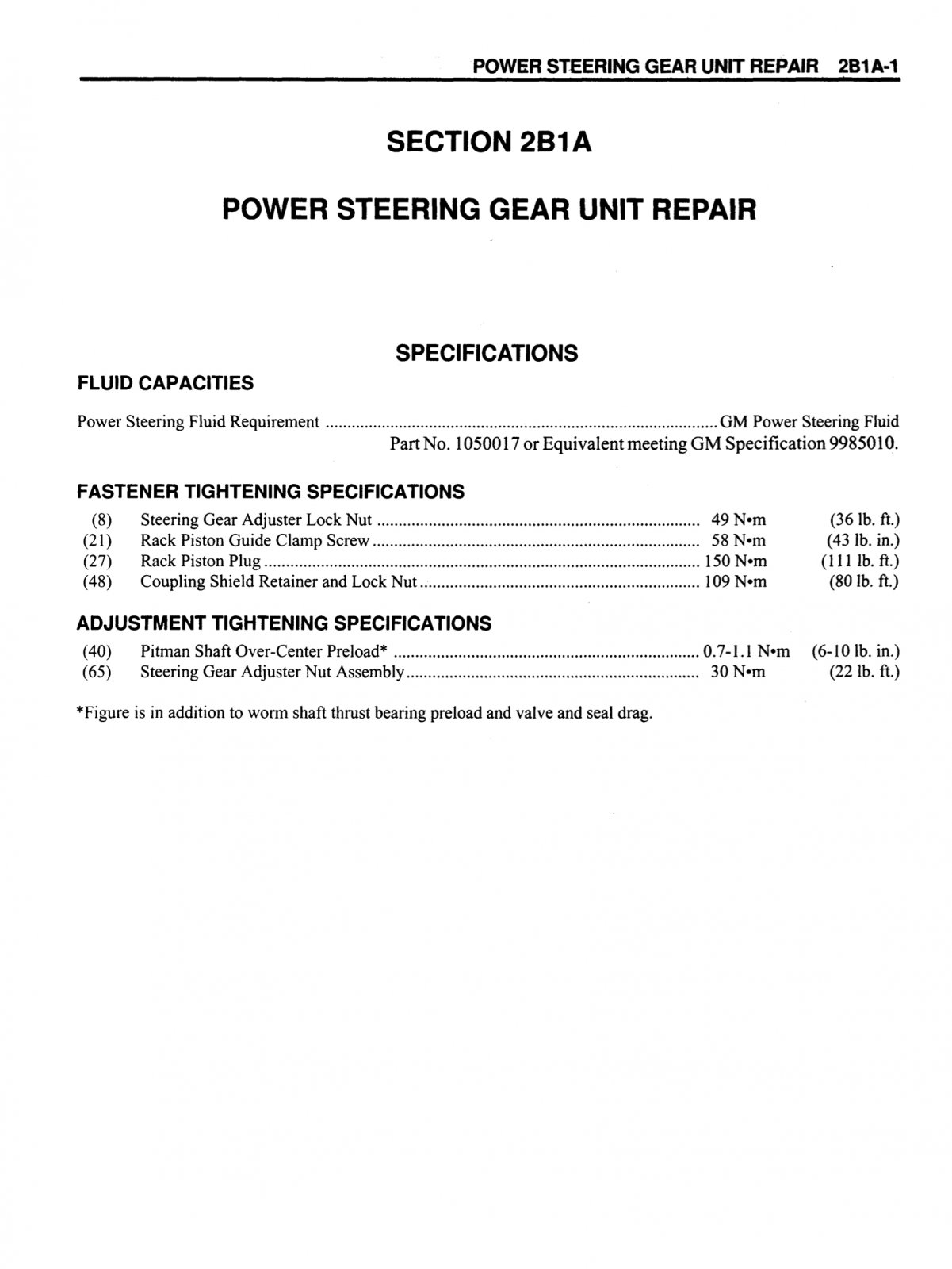

Here is the adjustment that the aftermarket companies should be following. Aside from a paint job and some seals, I doubt that many do, though.
