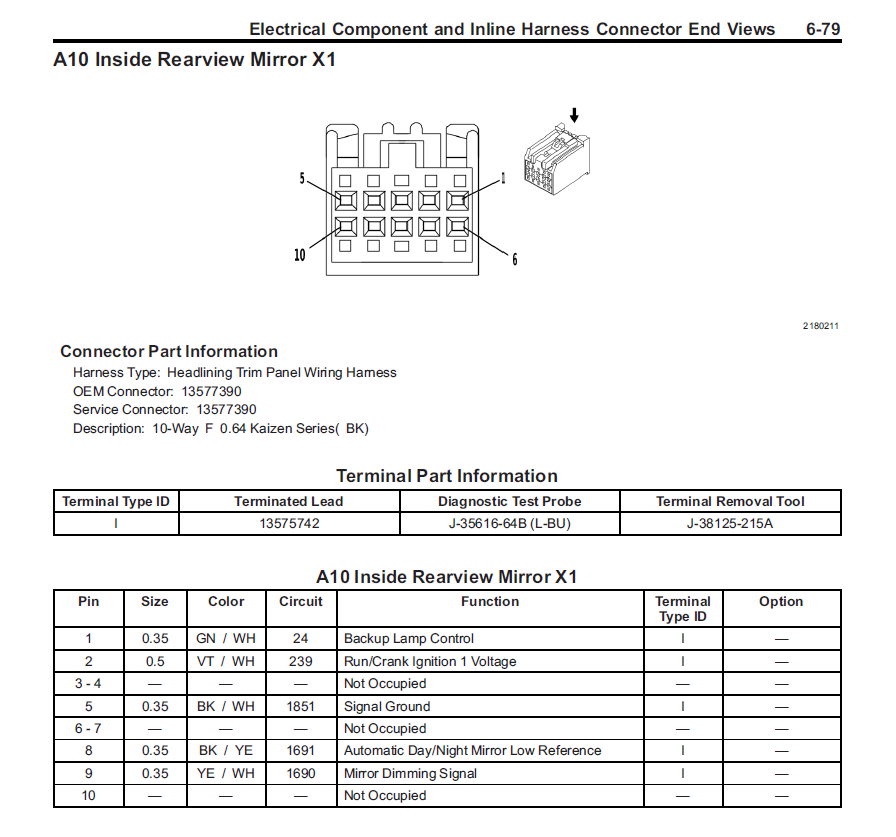

Here is the Mirror connector pinout for Yukons on the 2022, should be the same for the 21 and 23. Pin 2 (Violet) should be your ignition wire at 12V and pin 5 (Black) should be your ground. You would need to step down the 12V from the vehicle to 5V 1A (dashcams are basically glorified webcams) using something like this.

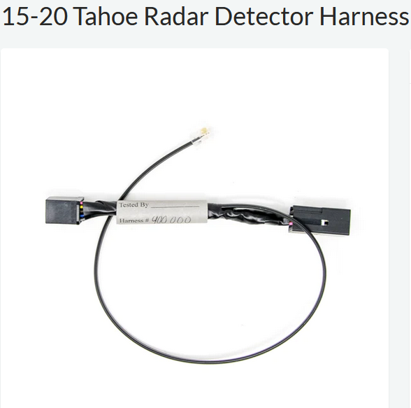

Try this...just search for your year. i use it in my '22 Tahoe for my radar detector.
