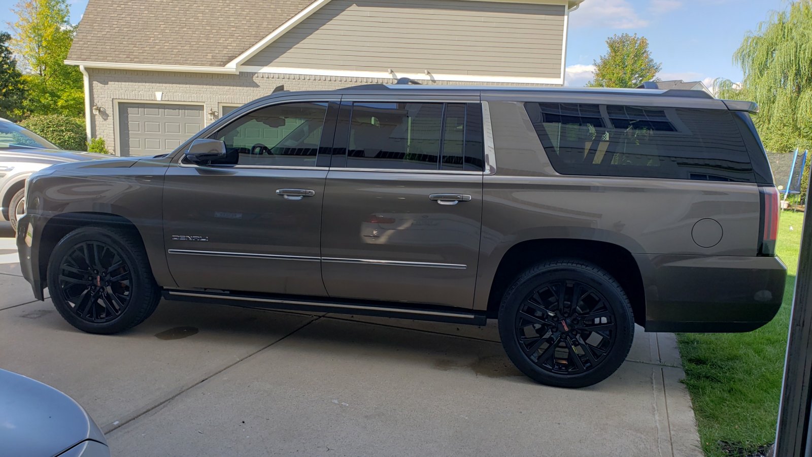

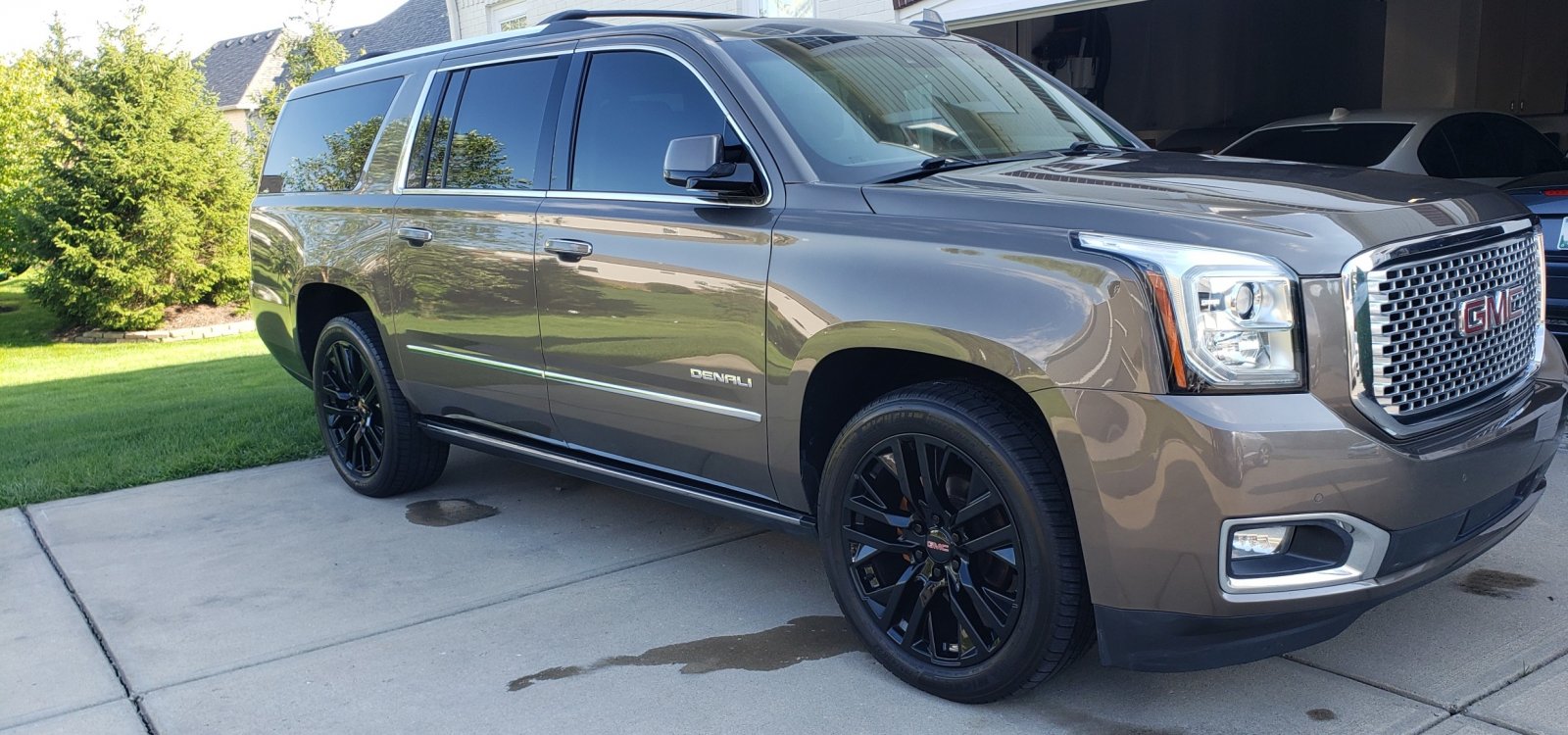

Should have posted some pics of the ride, still happy! She has never let me down or left me stranded...
