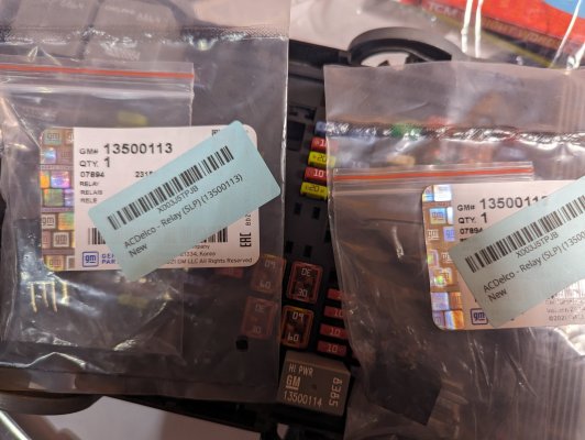

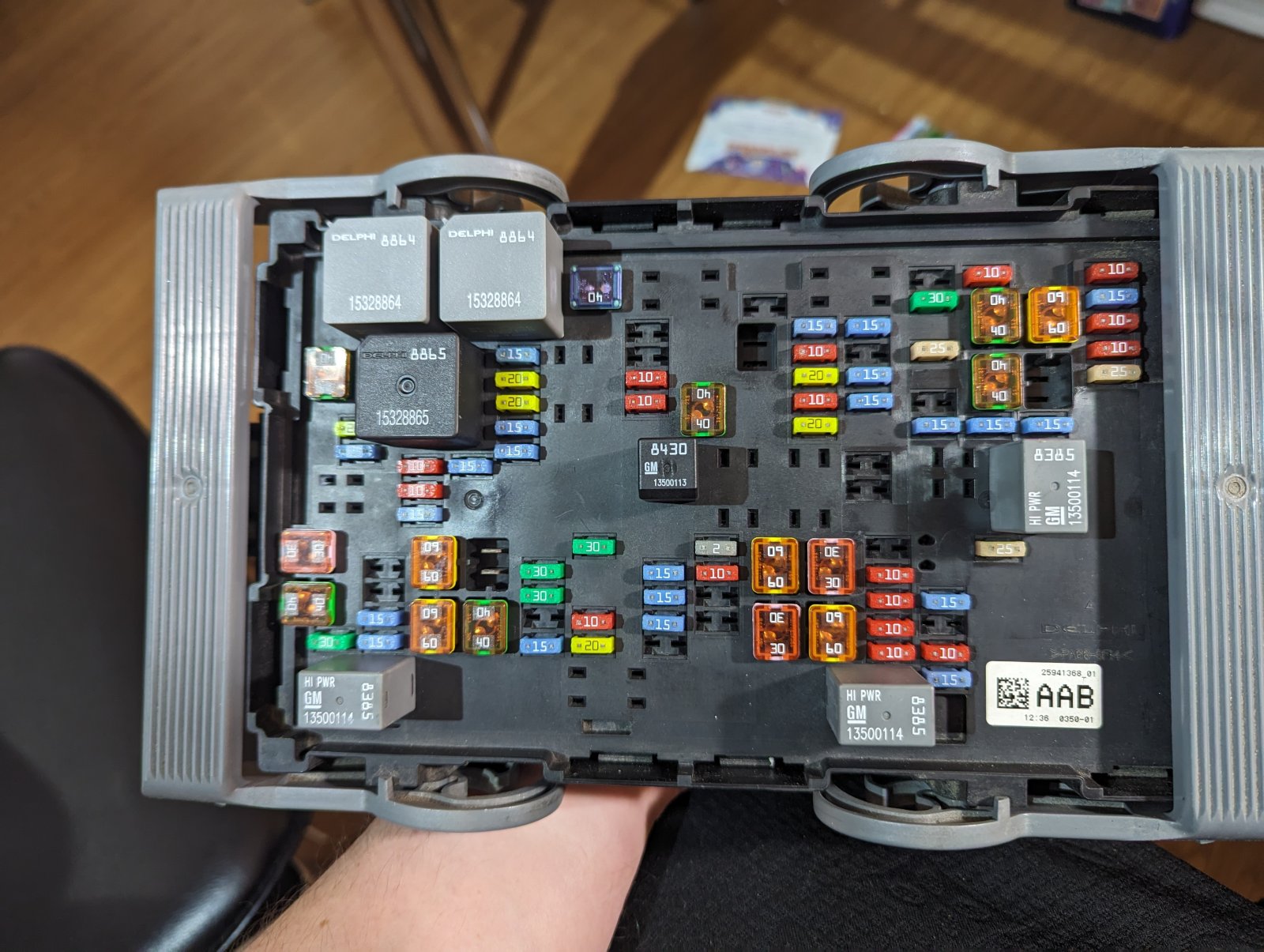

Ok, I took that fuse box inside of my apartment, and too it apart, piece by piece. I had some really bad corrosion, I cleaned fuses with alcohol and some 500grid sponge, also I cleaned board with CRC Contact cleaner.
And assembled it, I'm missing 3 relays 13500114, which I ordered from Amazon, I think Delfy is manufacturer, also I replaced 2 relays 15328864 , just simply because they were Old and were wet.

I don't know about the black ones, but if you pull the 4 pin Grey ones, make sure what way they go back in. I had an issue with my heater pump wasn't running, after some trouble shooting it ended up being the relay in backwards. must have been something done before I got it.
if you need, I can take a pic of mine for you before you put it back on if you might have mixed any up.
and yeah, that fuse looks like it's definitely had a bad connection.
