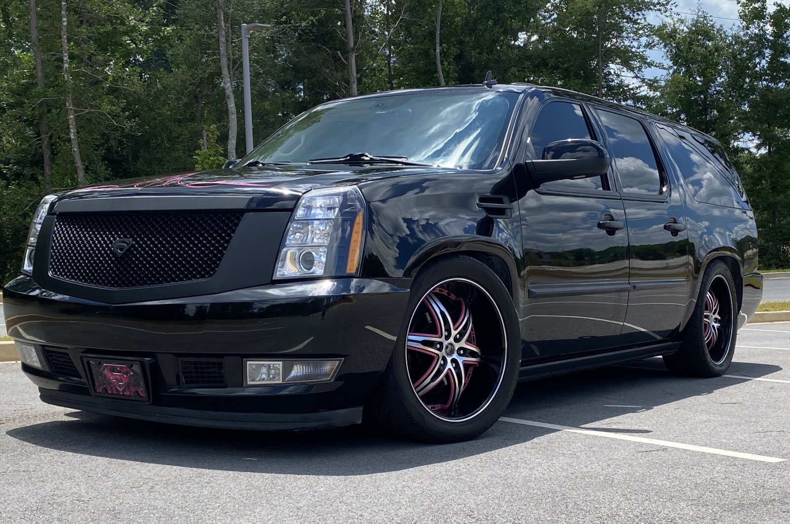

That looks great! Might have to move to a 285/40. I was concerned about ride quality going to a shorter sidewall - how is it? The 285/45 is even a bit taller than the 305/40 which I didn't care for. Here's the only pic I have of her truck right now - 2008 Escalade ESV
The wheels are 2Crave 22x9.5 but the wide lip makes it look like it's smaller than a 22 (to me at least.)

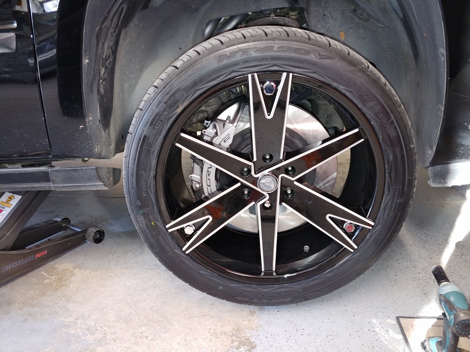

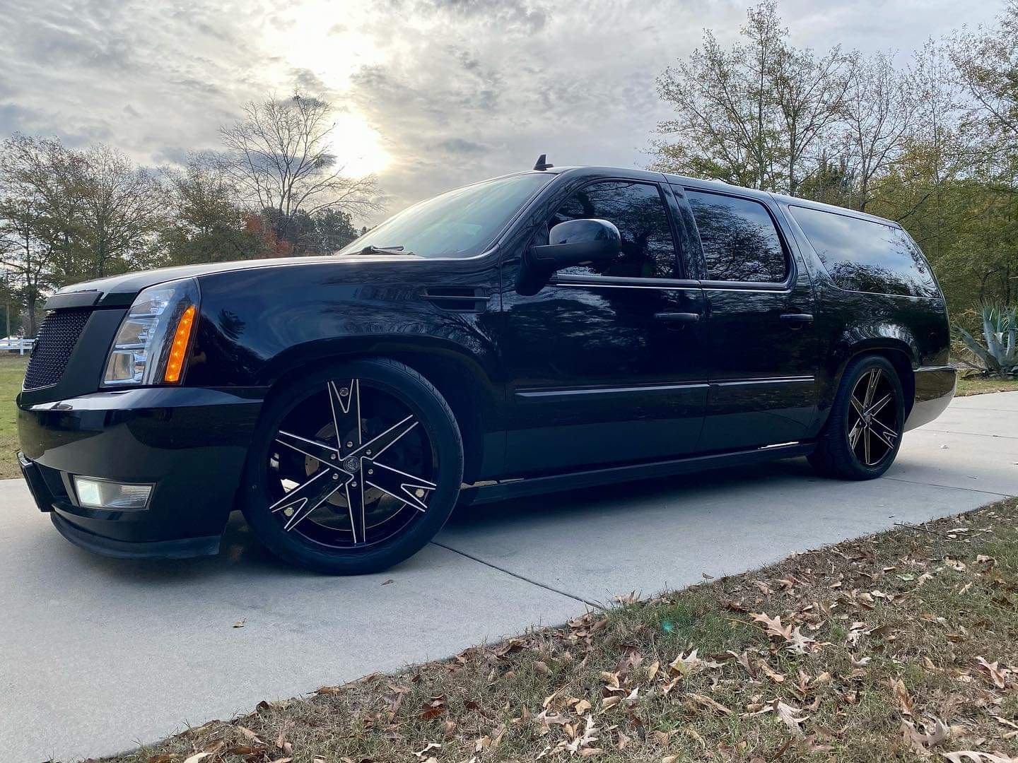

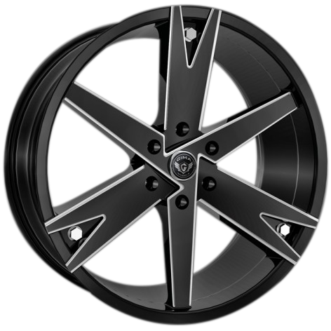

She just got some new wheels - Gima Warriors with a machined lip - still 22x9.5 tho. Hopefully these will clear the ZR1 calipers and 16" rotors. :D

Keep us posted on the updates. I want to see it with the new wheels and brakes.

The 285/40/22s worked out perfect. Having a shorter sidewall means it rubs less. Yes, they are a bit narrower than the 305s, but not enough to make much of a difference.
Had to get new wheels to fit the brakes
A 22" wheel makes any rotor look small but they are 16".
