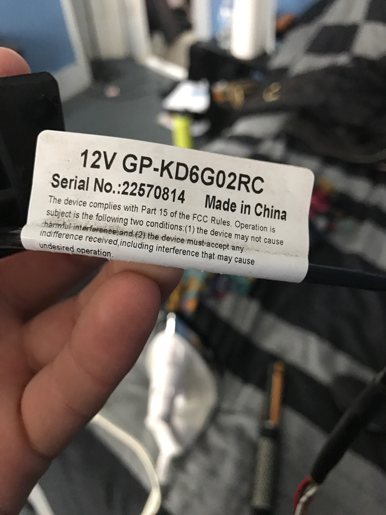

i have an oem camera im installing in my vehicle.
Does anyone have the wiring for the six wire factory 12v camera?

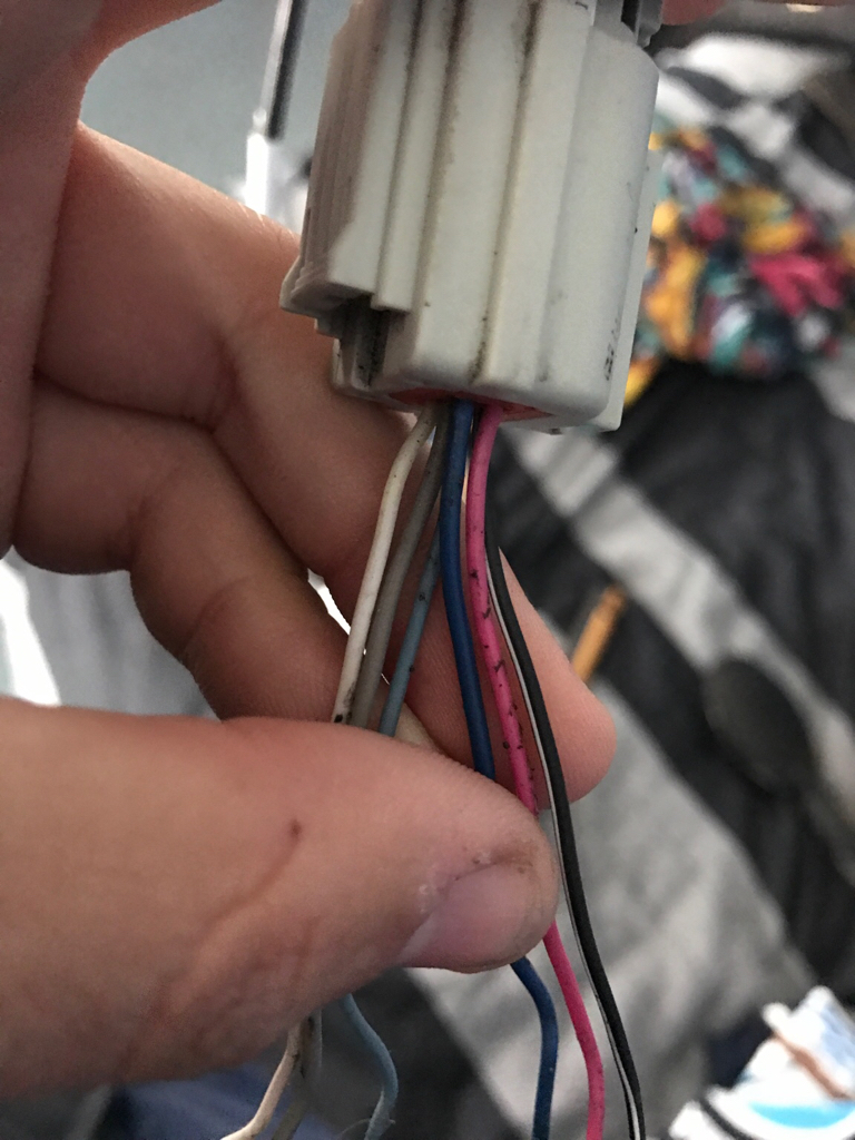

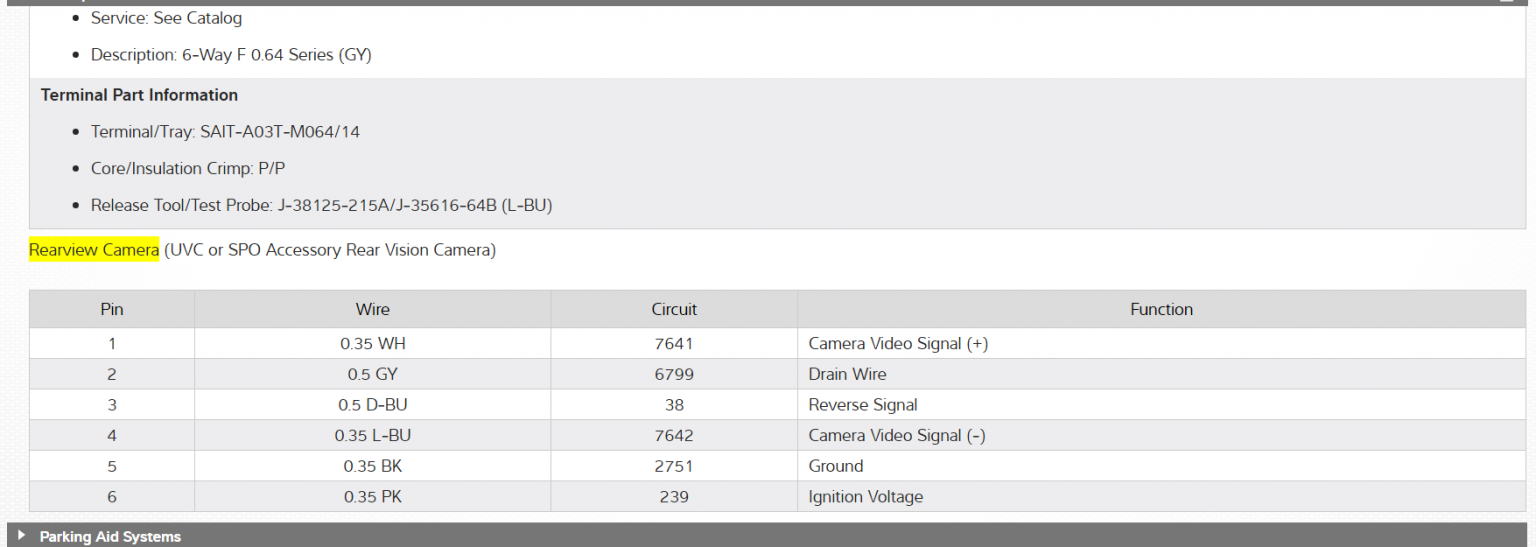

Hey I Figured I would try to help out if your still looking for info on this.I have access to a great database for everything on the these SUVS Here is s what I found for the camera output.This is for a 2009 Yukon so It should be the same.
Hope I helped!

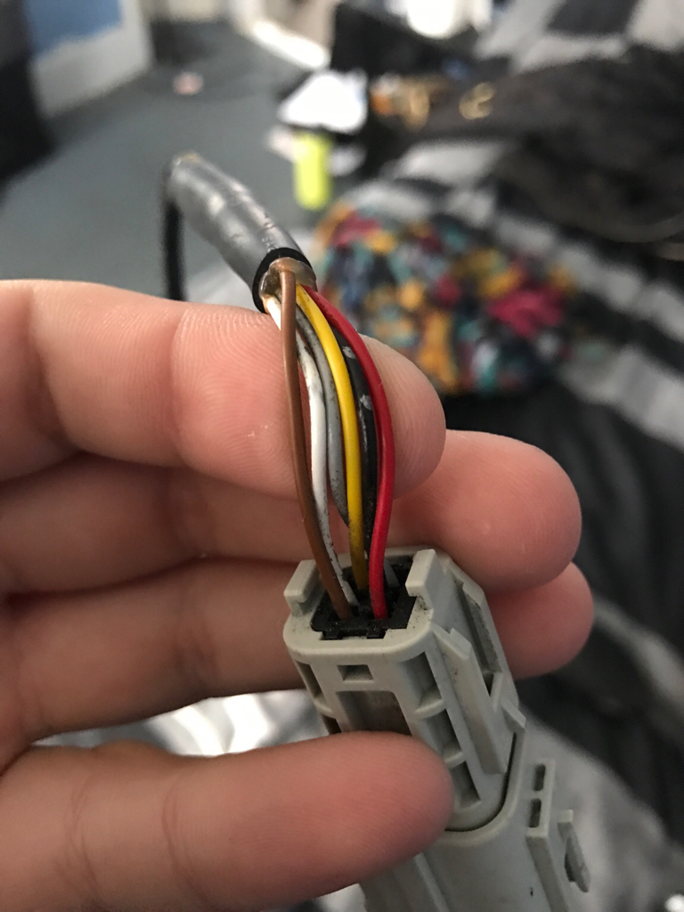

Thank you, I'll try this out. I had come up with something similar and ended up tearing the wiring apart and it looks like the camera has four wires that turn into six wires with the ground going to three of them which seemed odd
Is it possible the reverse signal is negative switched?

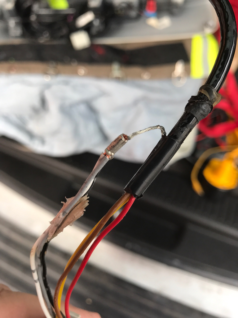

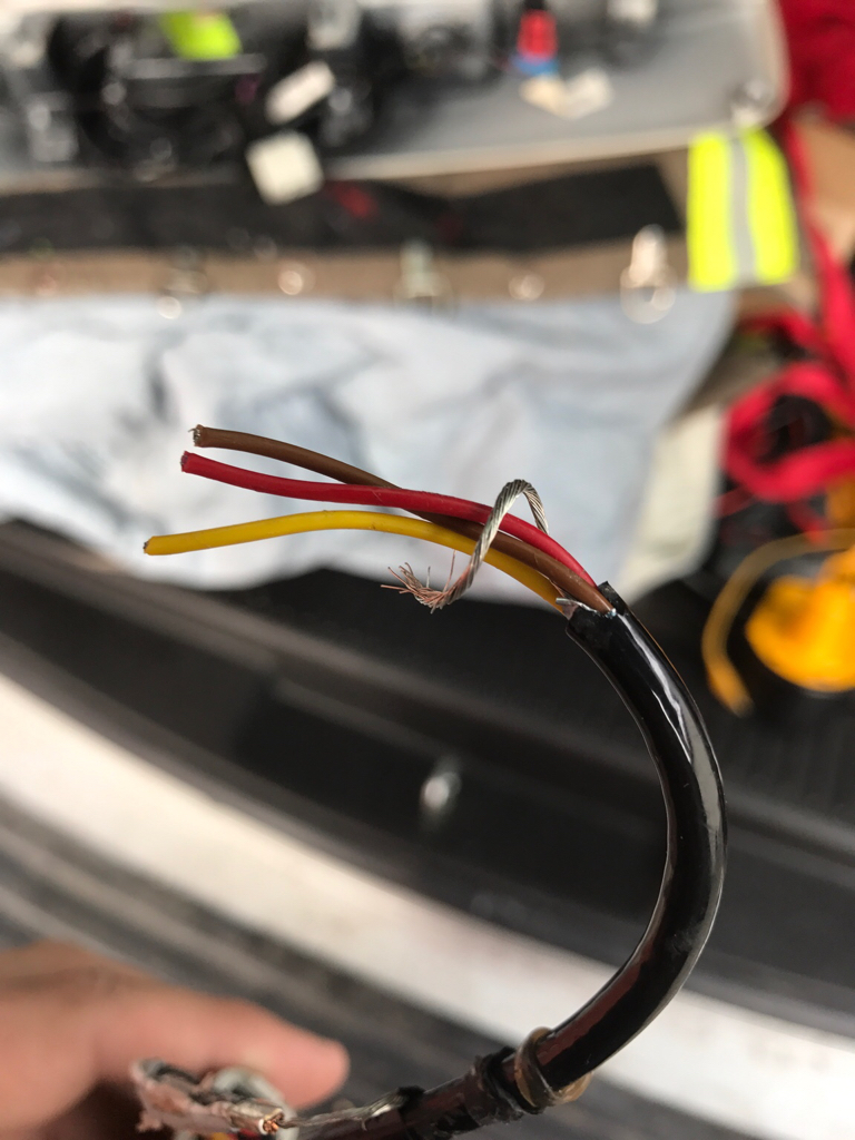

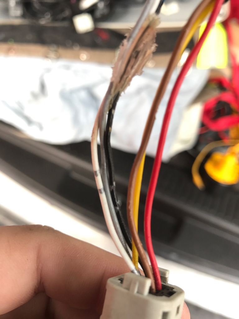

Okay, so here's where I'm at. I ripped apart the camera wiring and apparently there's only four real wires going to the camera. Red Yellow Brown and a Drain wire(GND)
The drain wire goes into a crimp that connects to Black Grey and White. And then goes into the plug.
So shouldn't I be getting a video signal when hooking the camera up to power with a battery with the red wire positive 12v, and the black as ground? And yellow to video positive and brown to video negative?
I'm confused at this point and really debating just going to an aftermarket camera with all this struggle. Please help

I know this is a very old thread but it helped me out so I thought I'd comment.
Installed a Pioneer AVIC-W8600NEX which has two camera inputs but works with the factory camera. In addition it has a camera view option to see that camera view (or the second one if I add it) by pushing a button. That latter feature gave a blank screen. I figured out in another thread I needed to trigger the camera on. Enter that wiring list above,. I tapped into the switched pink wire and jumped it into the dark blue (D-BU) listed. Now the camera is triggered with the ignition and works with my radio.
