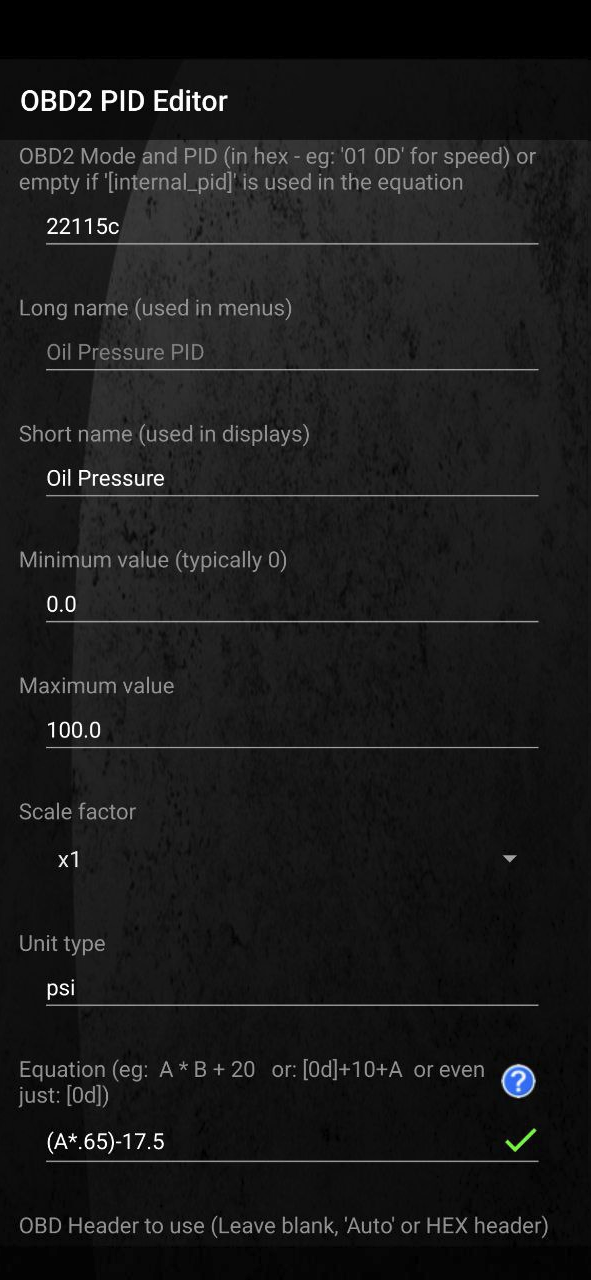

Help us first. What exactly is the "low" oil pressure reading at cold start, idling as warming up, idling after warm, rev engine in park, driving and when accelerate? Have you attached a scanner for readings or a pressure gauge? You may have great pressure and wrong readings.
I'd be surprised to find an oil pressure PID in an NBS. Prove me wrong, please, or at least surprise me!
