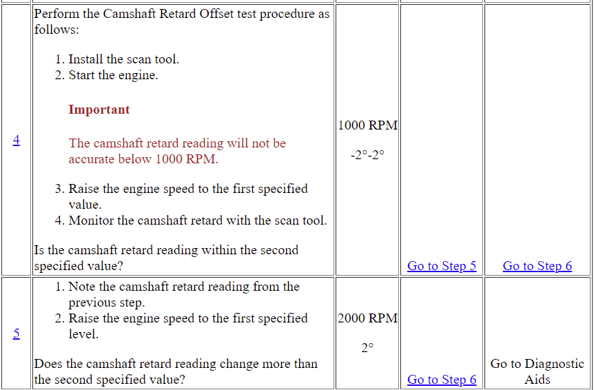

Plus the mechanic said there is no adjustment for this distributor, just like in the screenshot above (which is actually from Mitchell OnDemand) where it says the distributor is installed in a fixed, nonadjustable position for HVS (which I may or may not have??). So, of course, I'm utterly confused...
Some aftermarket distributors come with a fixed hold-down bracket which doesn’t allow the CMP offset to be set. The fix is to swap the hold down with the original one in order to do the replacement correctly. Not sure if you have that one or not.
P1345 is the CMP correlation, as others said it is adjustable on these.
For P1351, the factory manual has the step-by-step diagnostic tables for it. This site has PDFs of them for most years up to 1998:
An alternative would be alldatadiy.com which is a subscription site and has the same information (verbatim generally) as the factory manual. They went up in price recently (it’s now around $60/yr) so I let my subscription expire or I would copy the sections for you.
Edit: here is P1351 from the 98 PDF manual…

I took it back over and told him we've got to get the cam retard set regardless and to check the connections while he's at it. Gotta peel the onion and the first layer is that offset.
D
doncaruana
Apr 11, 2016
192
72
