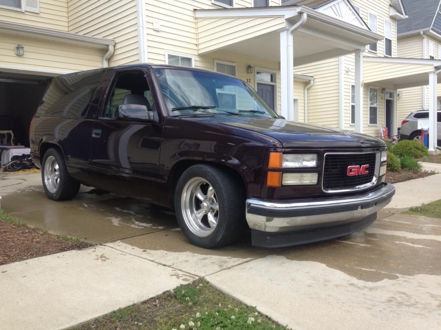

ill add mine to the thread! :D
belltech street performance shocks, djm flip kit and mini notch, 2" djm spindles, belltech drop springs 3" with coil cut, 20x8.5 boss wheels wrapped with 245/35/20. poly urathane bump stops. few other mods as well. and ill be polishing brake cali's this weekend

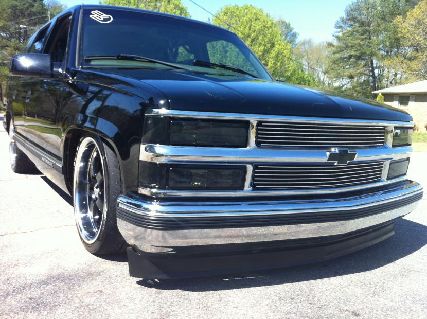

Dropped 3/5 on 22s. I bought this all stock two and a half years ago and i have done everything myself also have four 15s and a massive box inside

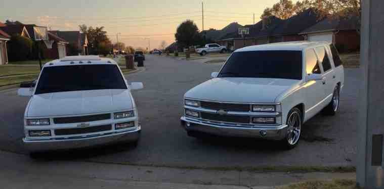

5/5 drop with 255/50/17 gonna go lower and smaller tires 245/45/17 fronts and 275/40/17 on the rear

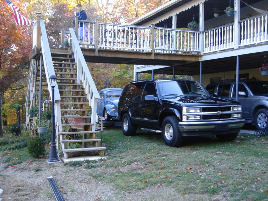

Here is mine......
This is how it was original setup. 15" centerlines on 32" tires stock suspension.
Picked up the 20's dropped the step bar.
Then did the 4/6 DJM drop, had to add 1" helper hangers to level it out.
