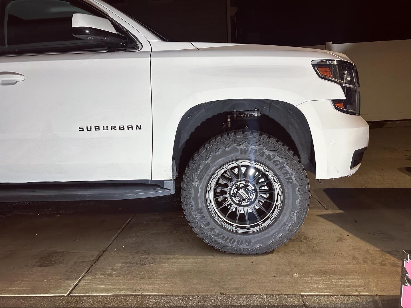

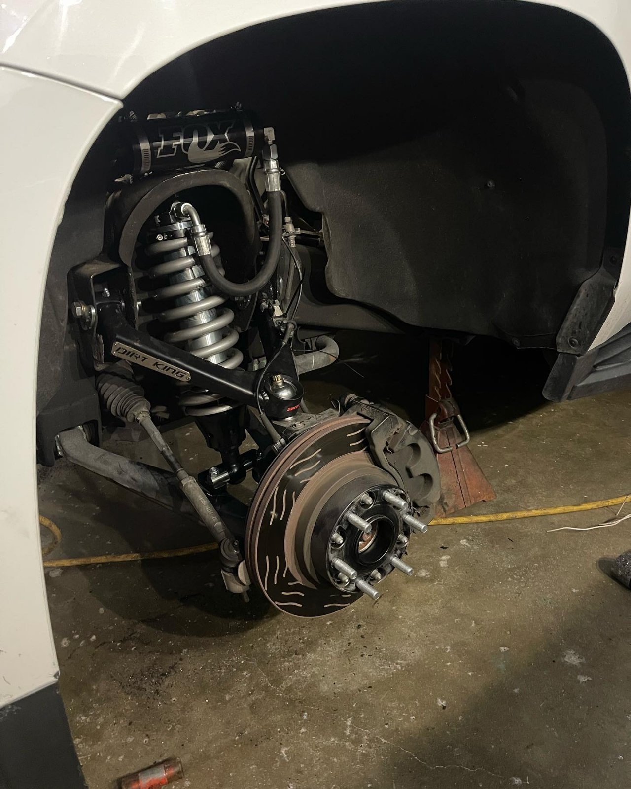

You may get the upgrade itch after living with the live for a while… here’s my setup, very close to 3” up front, 275-70/R18 0” offset wheels. I’m ashamed I have no pics of the rear but I have a 2” lift puck and Z71 springs with piggyback fox’s
