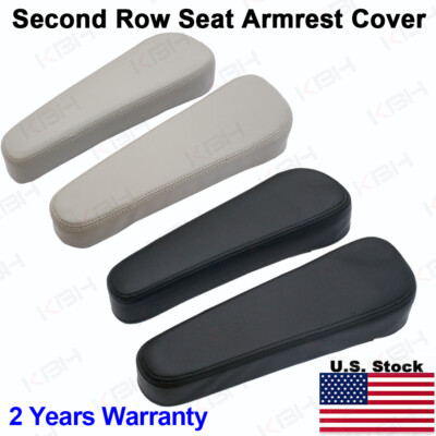

here are some arm rest covers

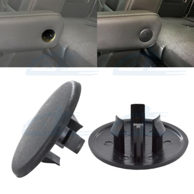

these are the hole covers, there are different colors on ebay, they sometimes just break when you pull them off

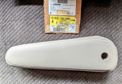

here is a deal on a left one I think, in cashmiere (the cover can be changed), normally a new one is $150-200, which was why I just "fixed" mine
