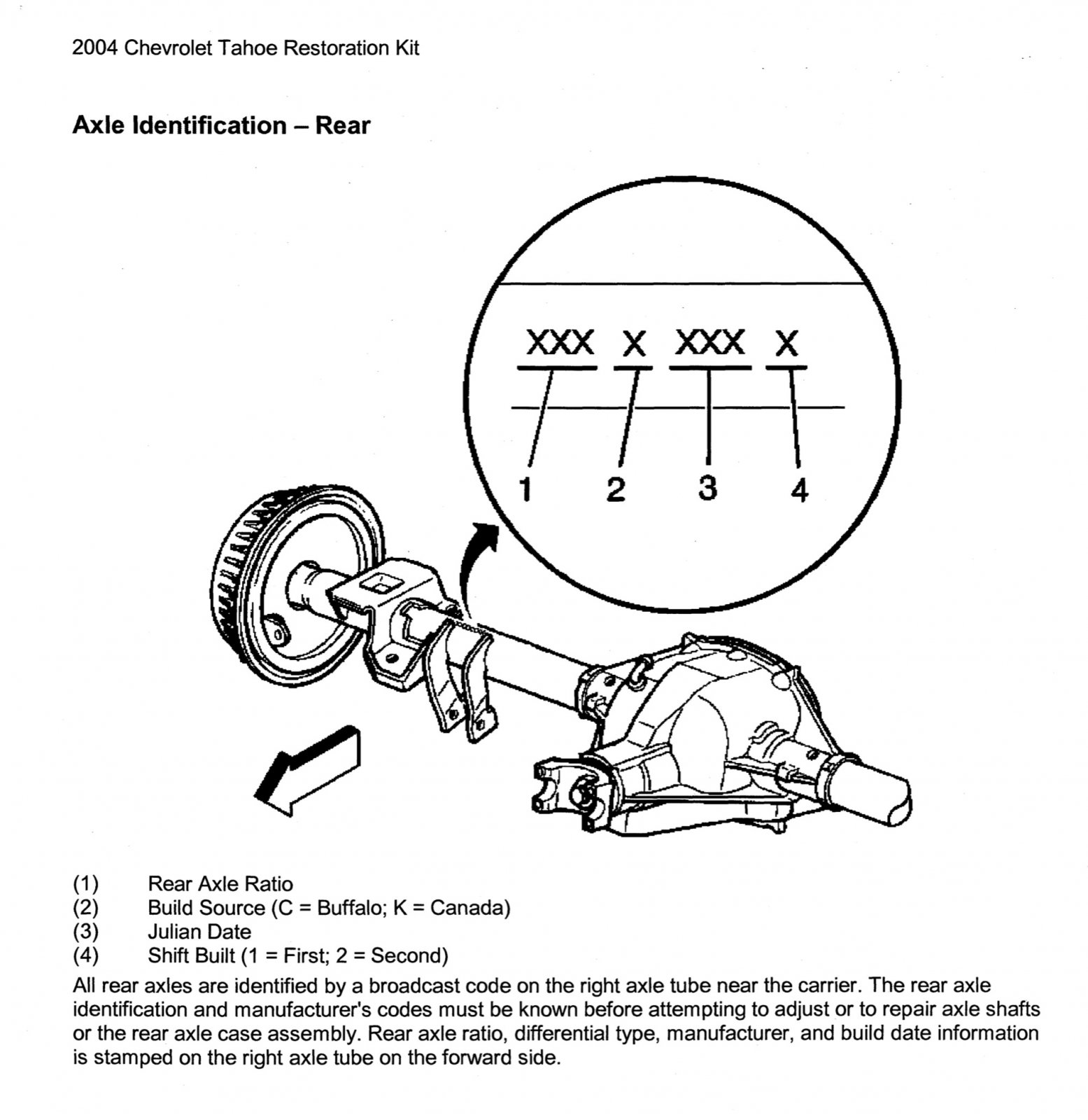

Should you find an axle and don't have an RPO code to reference, I've found this online while looking for a rear end last year.
