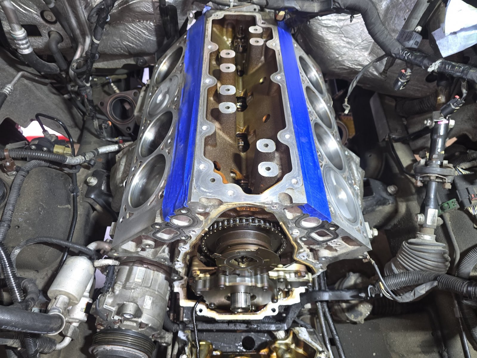

On my path to doing the AFM/DOD delete, I'm at the point where I need to remove the cam. I need to walk the chain off it so I don't have to remove the oil pump. I've seen people do it on YouTube, but after trying it, I feel like it's too much force. I've decided to go ahead and drop the oil pan and replace the timing chain and oil pump since I've gotten it down this far. Does anyone have a link to the procedure for removing the oil pan? I'm not finding anything on YouTube about it. Everything I found is pre-2015, and the pan looks different. For starters, there is a smaller pan bolted to the regular. Thanks!

This was precisely what I'd been looking for, and he did a great job explaining it. The only difference in my car is that I've got a 2WD, which means the engine sits lower. I have to remove the steering rack bolts to lower it down to get the pan out. This is an excellent video on removing and reinstalling the oil pump and oil pan.

I hear that's the best way to do any major engine work, but I have limited space, so working on it in the car was really my only option. I'm glad I pulled the pan off because I cleaned it well and replaced all the rubber gaskets inside.
