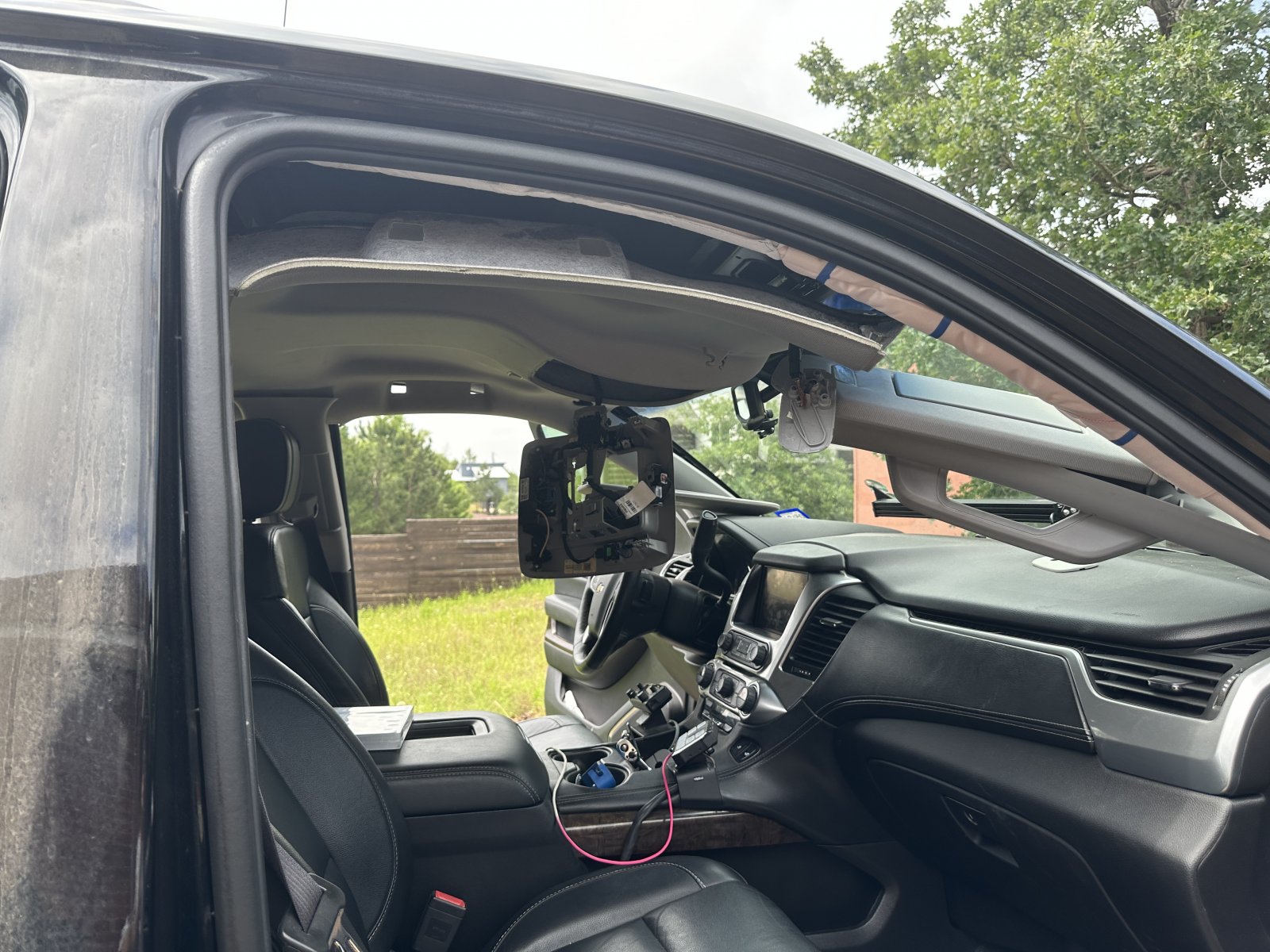

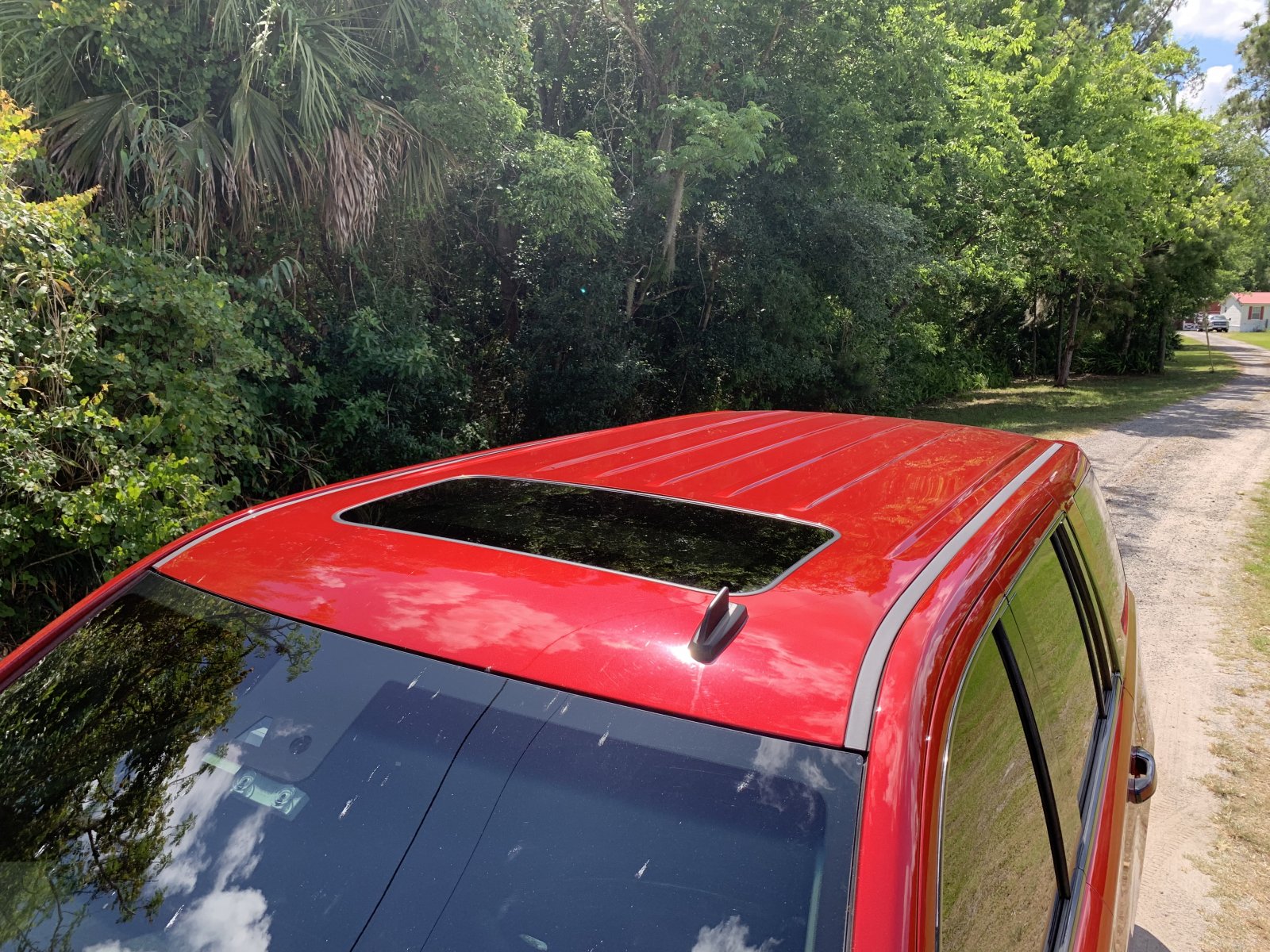

I tried the search...... I am still not coming up with a thread that shows a removal, I am not a roof rack guy and would really like to get rid of mine. From what I understand it has to be removed from the inside. Has anyone tackled this job yet?

I'm very interested in this as well. I remember sometime ago coming across a post somewhere (this forum or another) where they said it required a lot of work and that you'll have to fill in the holes after removing the racks. Like you, I've tried searching and could not find enough information.

I really didn't want to remove the headliner......

On 14 back you do not need to remove headliner, screwed down from outside, just need to seal the holes and come up with a cover, I have used nice round head allen bolts and painted before, also sealed with paintable sealer and painted to match, the one with the molding looks killer to me

yeah, I used to have a 11 Denali and took off the roof rack with ease. Not with this one....
