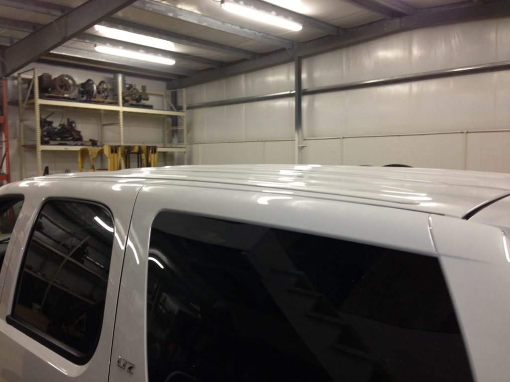

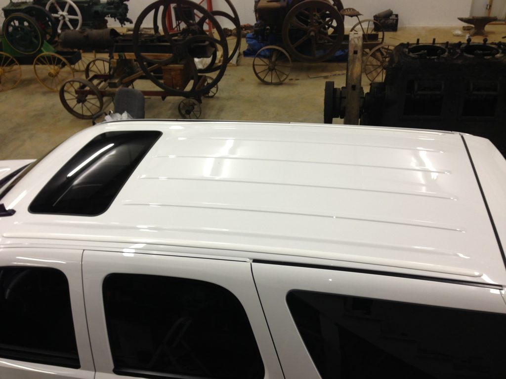

Well, now I don't have to post my deleted rack pics! :)
Let me know if you have any questions about it.

Sorry, hope you don't mind me reposting your pics, I did give you credit though :)
I did have a question though, I just posted it on your thread as well. You purchased the moldings that are beveled on both ends, right? How did you cut it to the length you wanted? Just cut a chunk out of the middle and have a seam? Is it visible? Or did you just cut one of the beveled ends off?
Not a problem at all!
Check the other thread -- I just answered the question over there.

that looks awesome dude. im going to have to look into this now. is it all one piece?
Thanks!
Yeah, it's all one piece. I would have liked to make it shorter as it didn't need to be this long (7'). But that's the only length they offered it in and I didn't want to cut a chunk out of the middle and have a seam in the molding.

That looks smooth AF!
Thanks.
