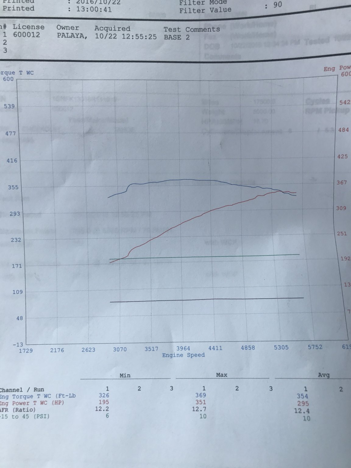

Results are In. The tunes from Justin at Black bear are perfect. The tunes are consistent through out the pulls. Max hp 320 max torque 330 @ 7 pounds boost on the 5.3. Stock dyno pulls on non modded Tahoe was 178 from what he shown me from another dyno pull
He shown me another Tahoe that had a callaway super that was similar to my set up. With the ARH headers, I made 30 more horse than his.
