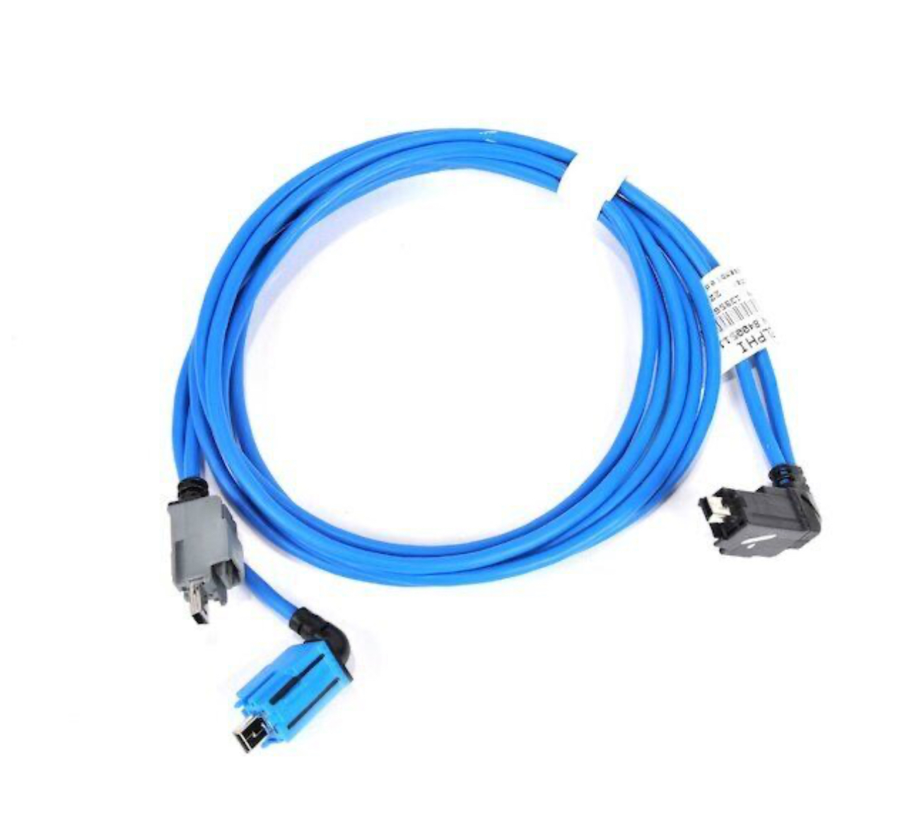

If do you want my advice, change the wire that connects HMI and headunit .
This issue has been fixed with me .

So I had the same issue brought to gm I had to replace the screen however the new one worked but cut out again they jumped the video cable and it worked they said it was the video cord now I'm trying to find one as gm doesn't even know the part number ugh

Unfortunately not yet. The screen worked again for a short while before dying. I put a DVD on the other day and it played on the touchscreen so at this point I’m leaning towards the cord or HMI being bad. I haven’t had the time to try and play with it just yet
