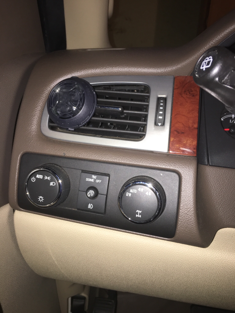

I have a dial which mostly stays in Auto.

Is it awd or 4wd?
Awd uses dexron VI
4wd uses auto trak II
F
farhanm
Aug 15, 2014
88
Oklahoma City
It's 4WD I believe, I thought only the denali's with a 6.2L ver AWDs
