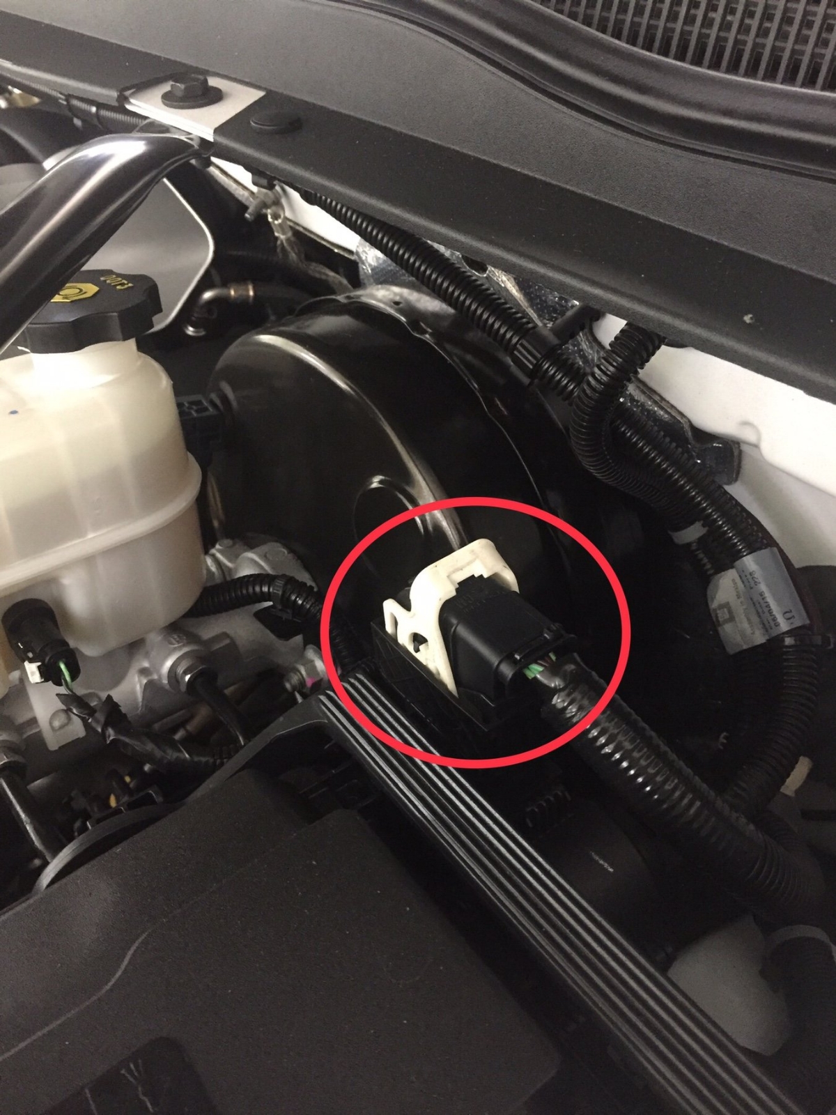

You’re correct. The boards can be physically swapped. The switch to the left of the steering wheel needs to be swapped too. The wiring is part of the chassis harness. So you’ll need a custom harness made which I can do. I’ve made one for my Yukon.

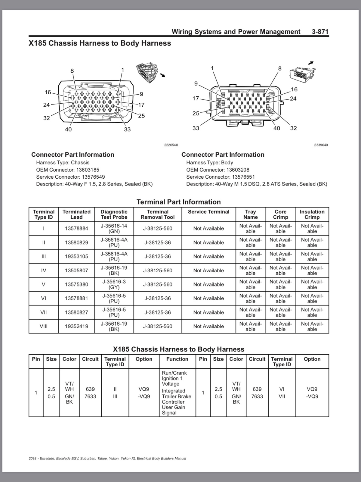

First, we need to see if the appropriate wires are present on the main harness. In the engine bay, there’s a connector behind the main fuse block. Release the latch and remove the top part of the connector. You’re looking for terminals in positions 8, 34 & 39. Let me know if they are present.

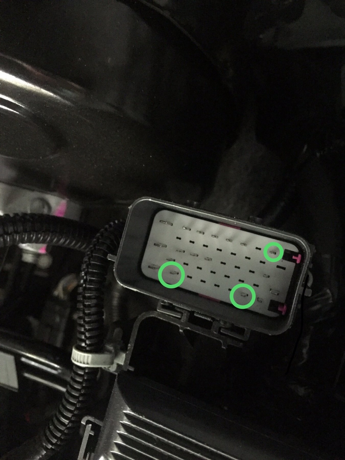

Would you do me a favor though and see if those pins I circled are present in your connector?

Or just grab a picture of the connector pins like mine and I can see if they are there.

You’ll need to see if the connectors are present. On the driver side, look behind the running board. Find the main harness next to the frame. There should be three on that side. I doubt they are there, but if they are, they’d be taped up to keep dirt out.
If they are not present, look at my earlier posts and see if those pins are present in the connector under the hood. I can make you a custom harness that will allow you to add the power assist steps.

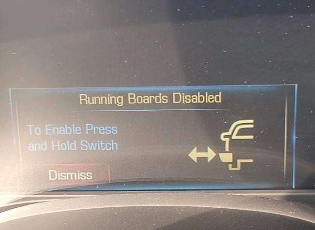

Hello I just installed powered running boards using YouTube and used pin 39 and 8 but never used 34 as you mentioned, what is this pin for? I'm now getting this alert which I assume I now need to swap the switch too please tell me what is this pin 34 for if possible? Btw yes I checked and i have the pin 34 on the male side
