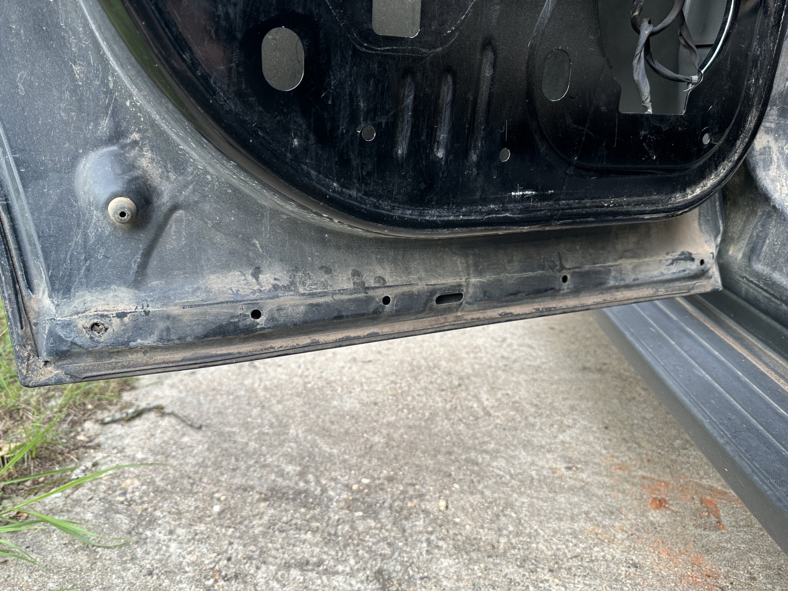

yes eventually rust will form, there is a drain hole that gets clogged up, you can clean out.
I have one door that was persistent in holding water so i drilled 2 small holes one at each end. problem solved

It's just a small hole on the very bottom edge near the outer edge, I park mine backwards on a incline so I made a new hole on both ends.
it's common for dirt to clog up the oem hole it's pretty small
I don't think any damages would happen unless the door became a fishtank

@iboughtatahoe23 There’s an old thread about it. Many of us have removed the plugs at the bottom of the doors.

Just opened it up this morning after a heavy rain last night, and it just started pouring water out of the holes where the weather seal goes on the bottom. I see one drain hole on the left but it’s like half closed from the factory. It looks like, maybe it wasn’t drilled correctly? Also looks to be a lot of mud and dirt in the bottom of the door.

So, in reference to this, basically I’m trying to figure out if I can drill that hole, bigger on the bottom, somehow clean that out all that mud, and figure out where the water is getting in.
