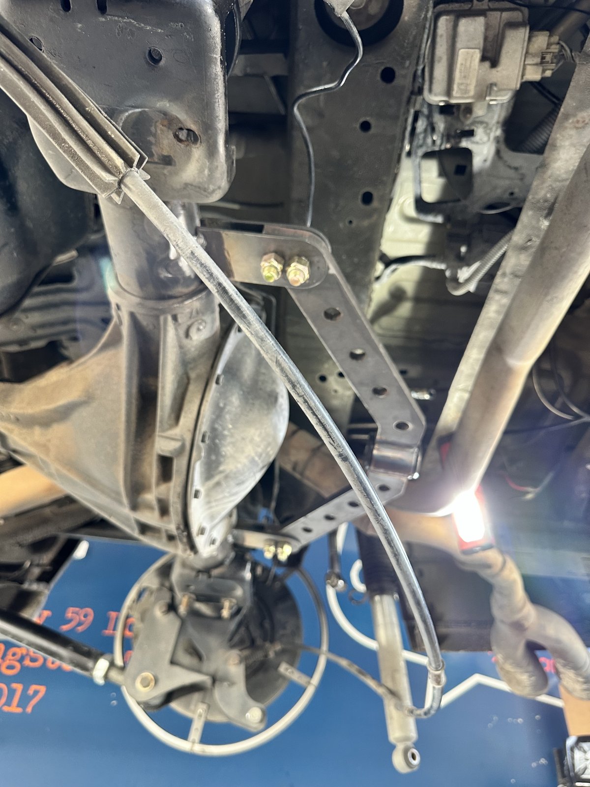

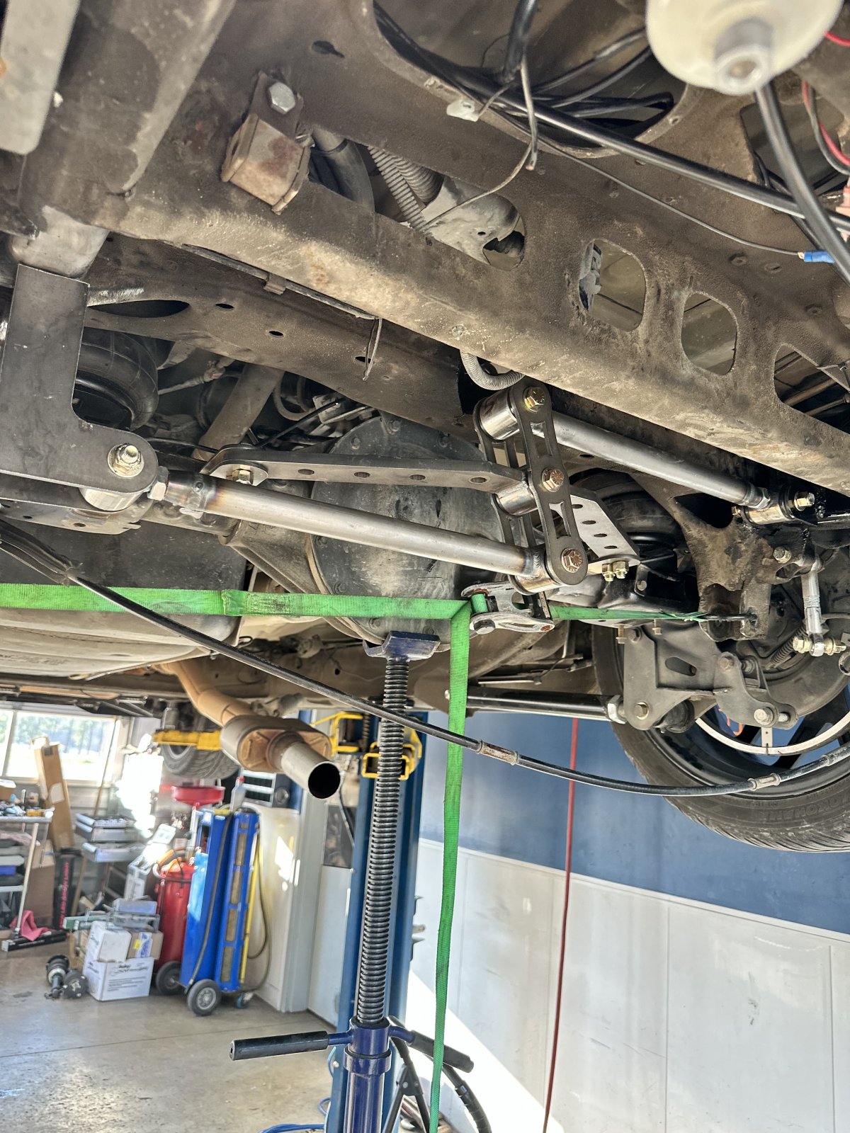

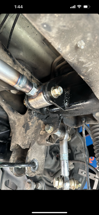

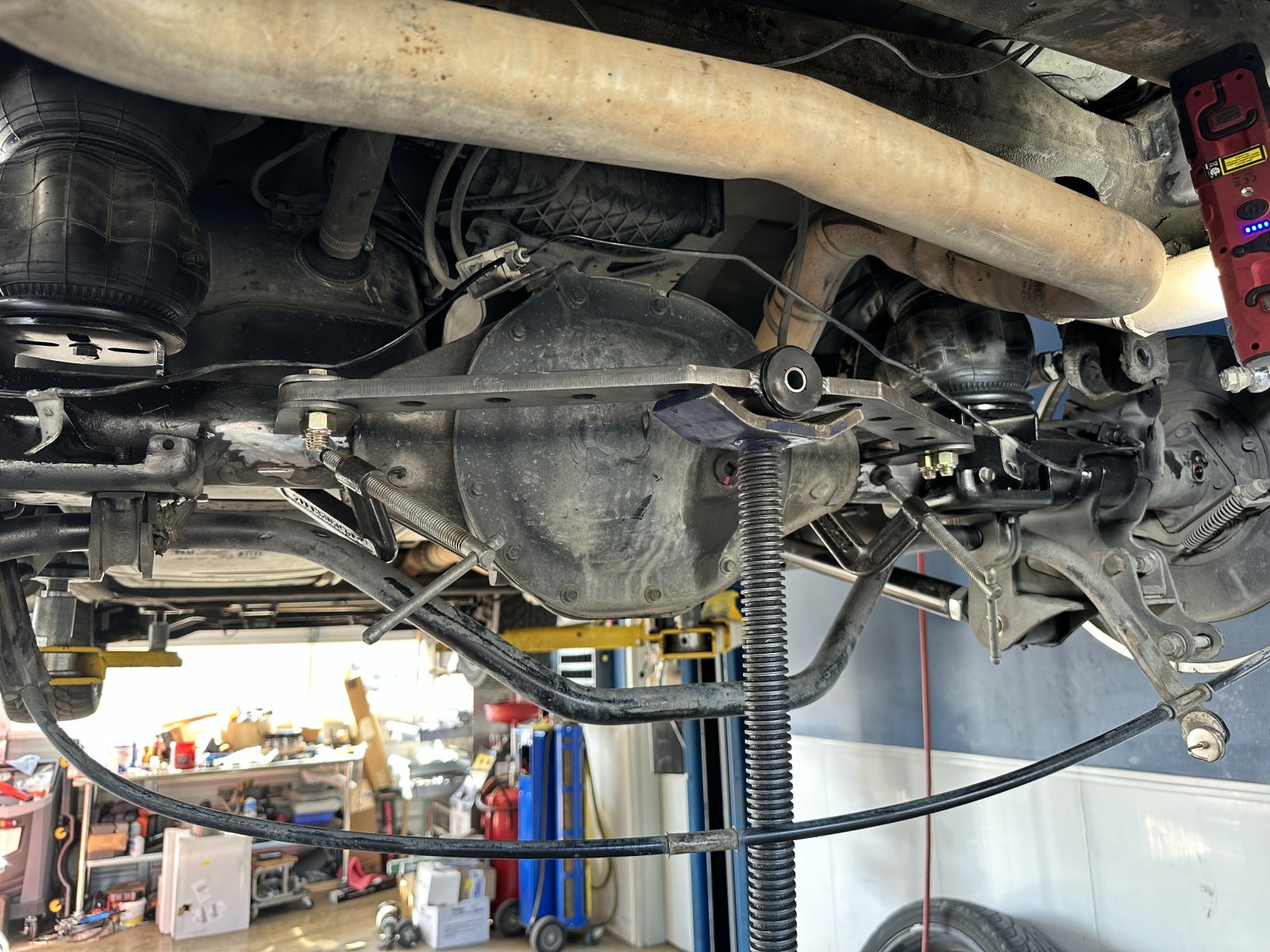

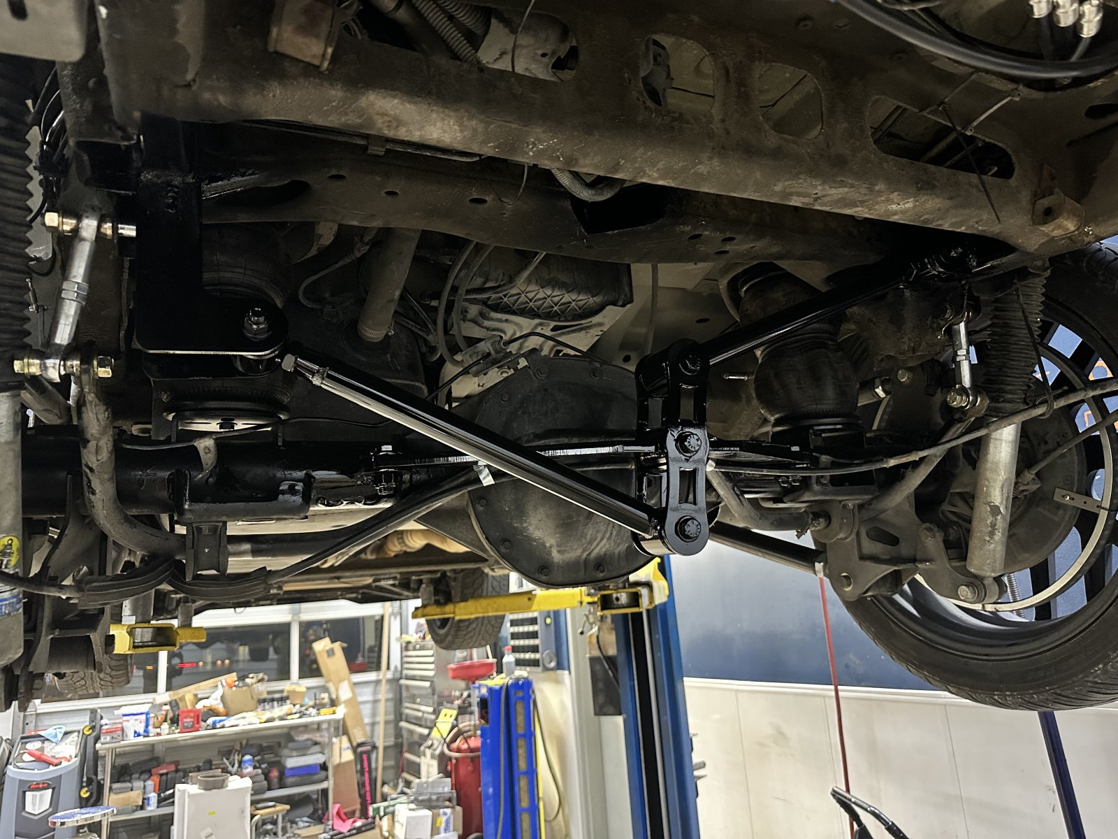

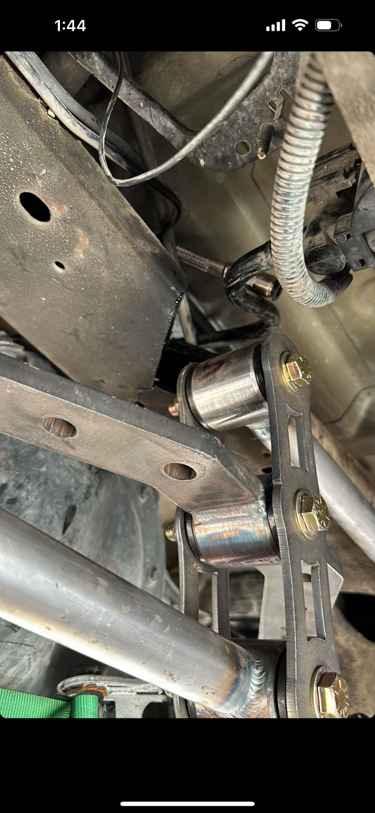

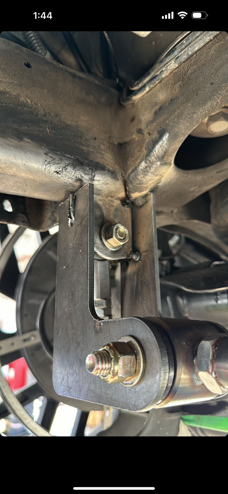

Watts link installed
Andy Schmidt
Jul 10, 2019
25
27

This is fantastic! You run custom length bars or just standard? Does it clear the sway bar? I’ve been looking at relocating my panhard bar, but this is much better.
A
Andy Schmidt
Jul 10, 2019
25
27
I messaged the guy that makes them on instagram. Alexvmetalworks. He had me measure full inside width of the frame and did his thing. The axle mounts I had him extend them 2” to make sure the sway bar cleared.
