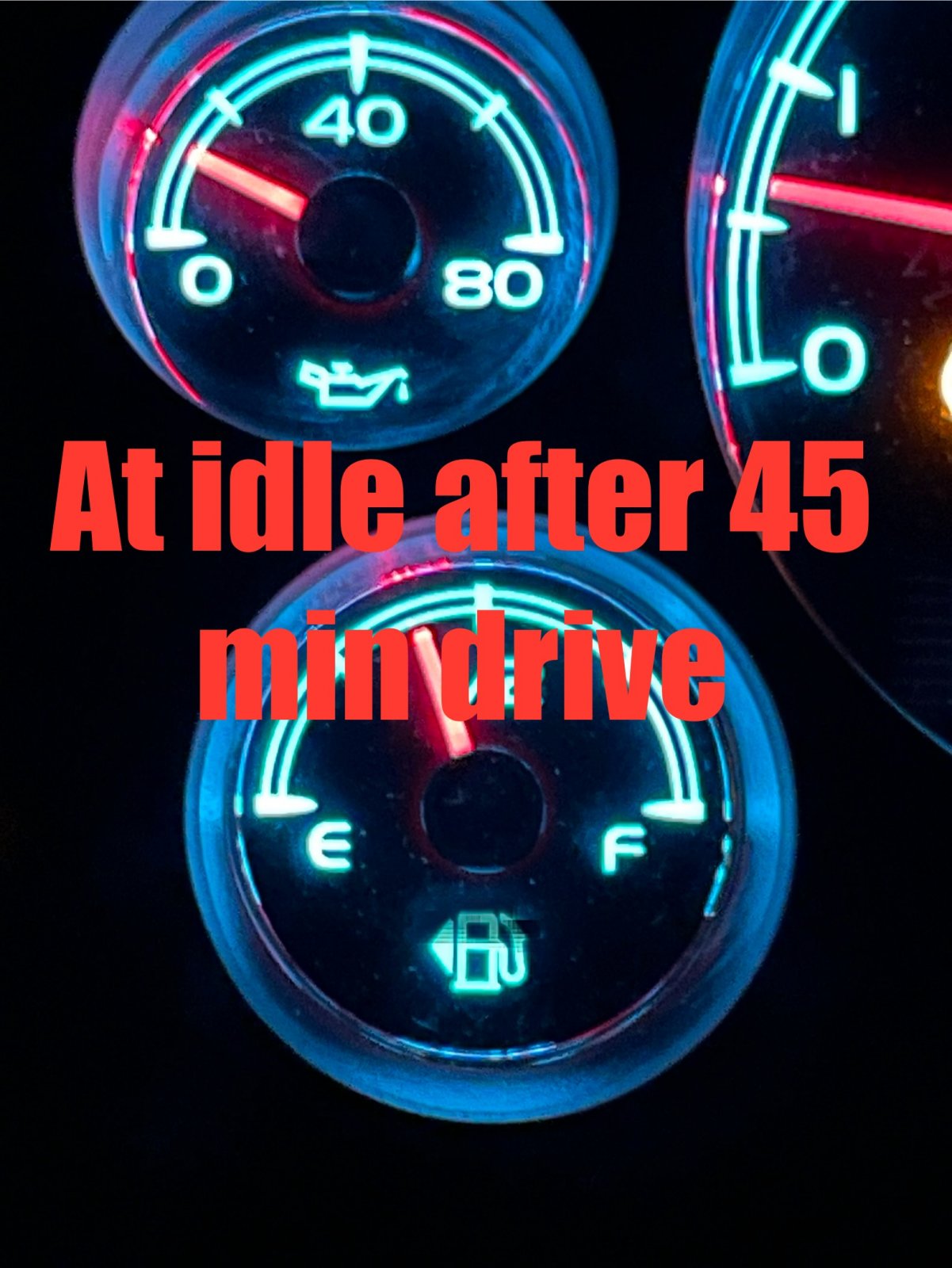

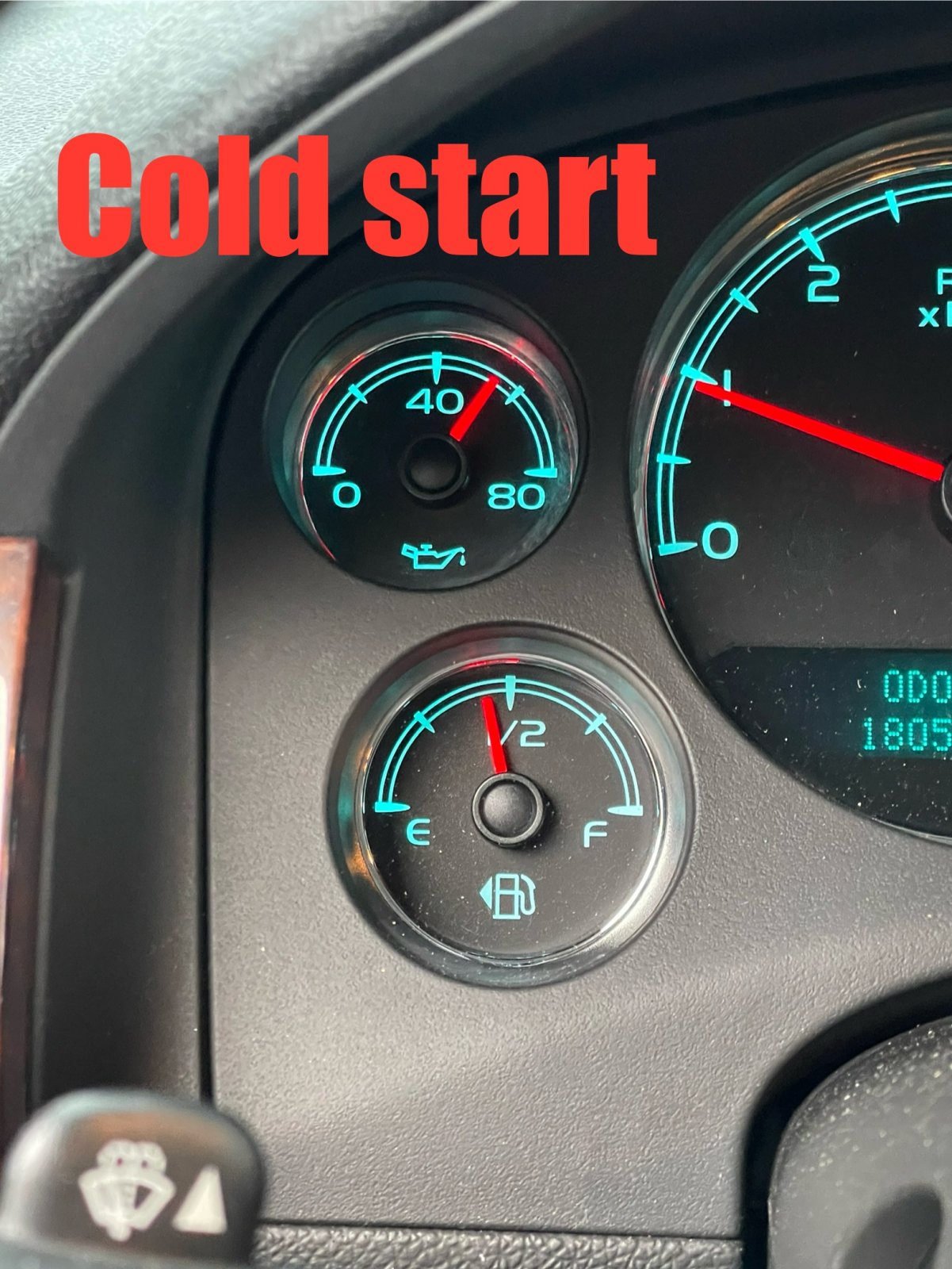

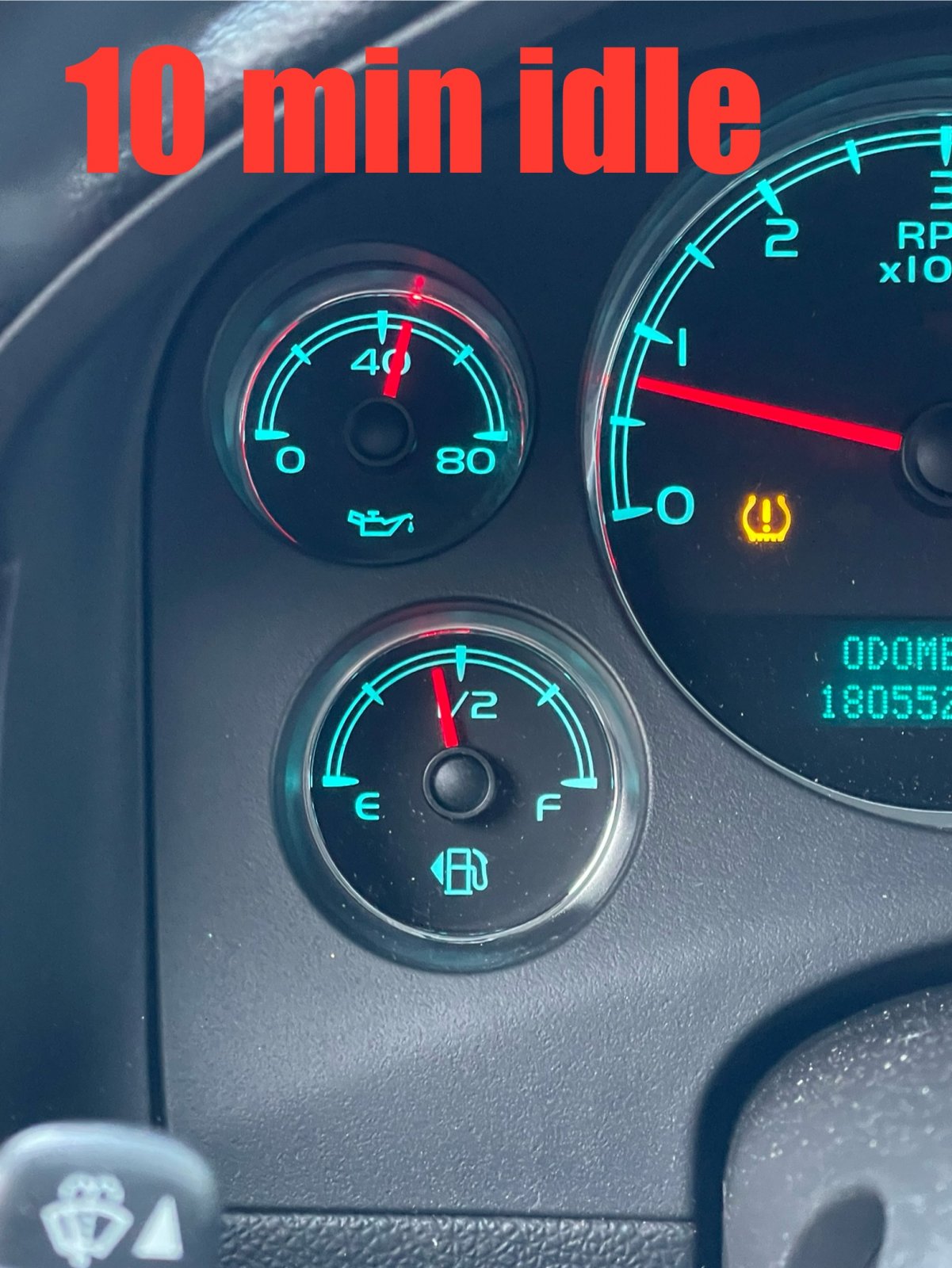

Bought a 2008 GMC Yukon XL with the 6.2 engine with 111.000 miles on it. After a couple of weeks I got the ticking noise at start up and the oil pressure drops after a short drive.
Ticking is worst at cold start, after 10 min it will be less significant. However oil pressure starts at 40 psi (according to gauge) and after a short drive it will drop to 10-15 psi at idle.

Thank you. I did read about this issue as well in other threads, might be worth to look into. Probably wouldn’t hurt to get that fixed given the low oil pressure at idle when engine is warm.I didn't see any mention yet of the oil pump pickup o-ring. Those dry out and crumble causing loss of oil to the pump. Hard to get to though.

Thank you for your input, I will be looking more into the oil pump and I ring thing, maybe that’s the main reason for the low oil pressure.My 08 YXL Denali had a classic case of piston slap. When it cooled down at night, the cold start ups sounded horrible. It was truly just scary noises, not damage occurring.
Once the broken exhaust mani bolt was replaced and the intake was cleaned, it almost disappeared. As previously mentioned, check the oil pump o ring by TEMPORARILY over filling the motor with oil and NOT driving it to see it the oil pressure stabilizes.
