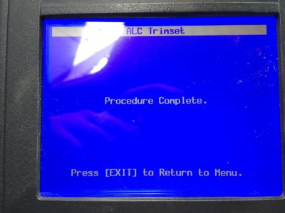

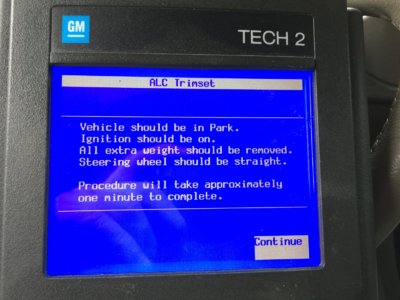

I remember back when I was trying to figure out why my service suspension light kept coming on, I read about the trimset and bumpstop calibration but nowhere could I find what exactly it did. The error turned out to be the spoofing resistors on my Arnott Shocks which I fixed by wiring some resistors in. Today, since I have a Tech 2, I figured I’d give it a try. And after I did it, I still have no idea what it did. The Tech 2 just says it takes about a minute and then it says it’s done. I tried a different procedure, recalibration, under the suspension menu, but it said I needed to use SPS and I can’t find the SPS menu. I was able to test everything like the compressor, exhaust solenoid, etc. and everything works but I already knew that. If I have any future problems the Tech 2 will sure help me troubleshoot.

...it said I needed to use SPS
SPS in on the main menu, right under diagnostics. But that is programming from either TIS2000 or TIS2Web. Speaking of the former, I'm still working on it. We had another laptop but it was not set up properly so I'm doing that now and when done will try that copy on it. As for the programming, unless one has TIS2000 or already has a subscription to TIS2Web, I wouldn't bother. Well, maybe, it would be there in the back of my stupid mind, wondering just what it could possibly be that needs doing that everyone gets away with not doing!!! LOL
