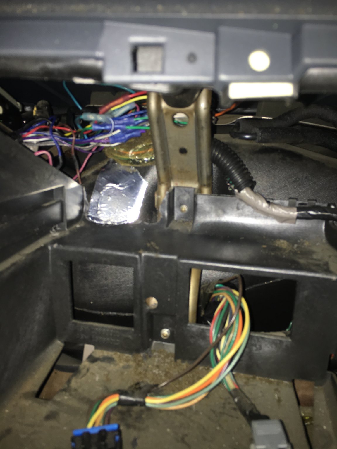

Ok so I found out that my no sound issue was caused by the factory amp. This Tahoe doesn't have Bose so for the first few days I was stumped. Did some digging and even posted a thread on here and no replies with no luck. I fellow member actually posted a thread on bypassing the amp a long time ago but i was nervous on cutting wires so I did more digging. I found out that the amp signal wire Is the pink wire shown in the pic. You can by pass it by tying the remote wire into it as shown...now I'm not sure if this is safe or not? So if you see something wrong with this please speak up lol.

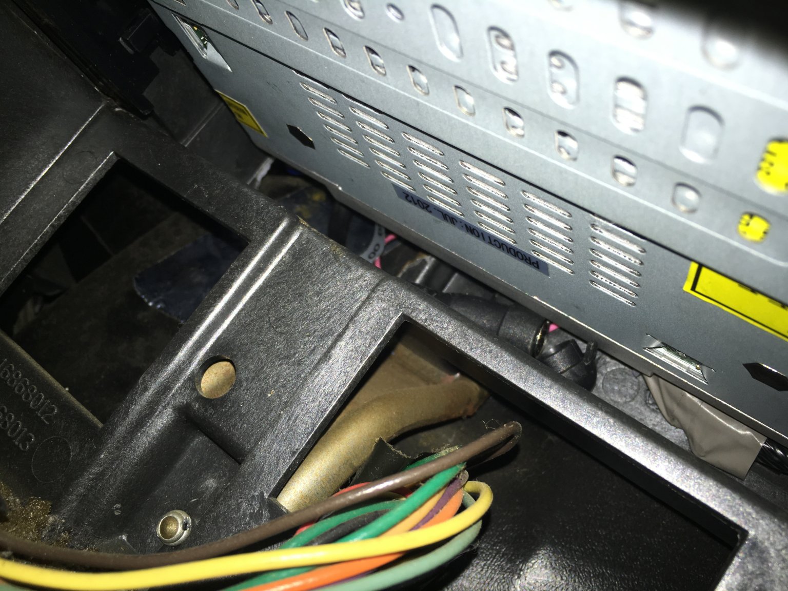

The end result is nice. The biggest pain in the ass in this was fighting all the wires behind the radio :Stupid Me: So far the only complaint on this is the screen hitting the gear shifter when I crank it. I may be able to go in the setting and change this I'll have to check into that

I may do the 03-06 swap later on put as long as this one works I'll try and stick with it beats the hell out of a stock one lol

You should do the Double DIN mod, it's easy for that truck. The 03-up dash bezels are on EBay all the time for a reasonable price. My Denali one was hard to find but yours would be easy to find.
