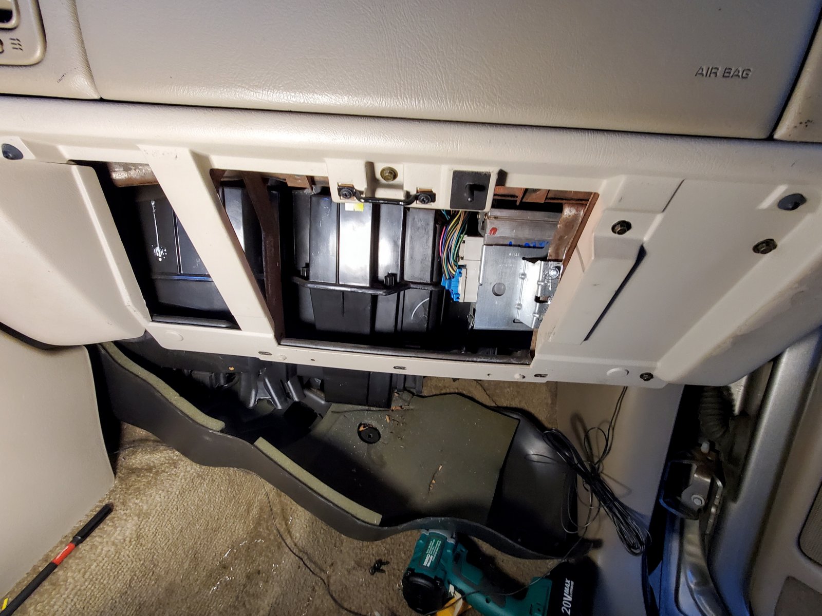

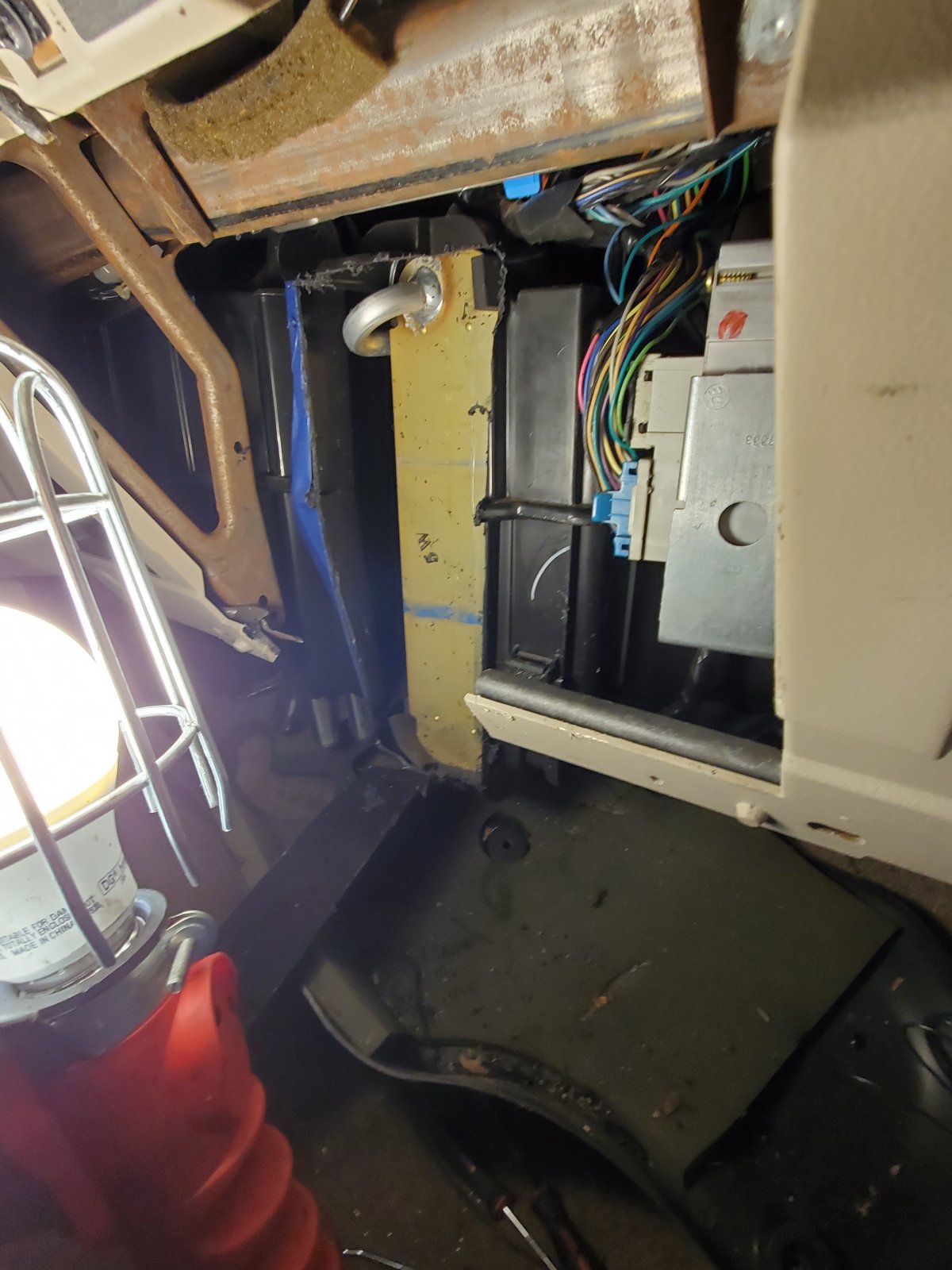

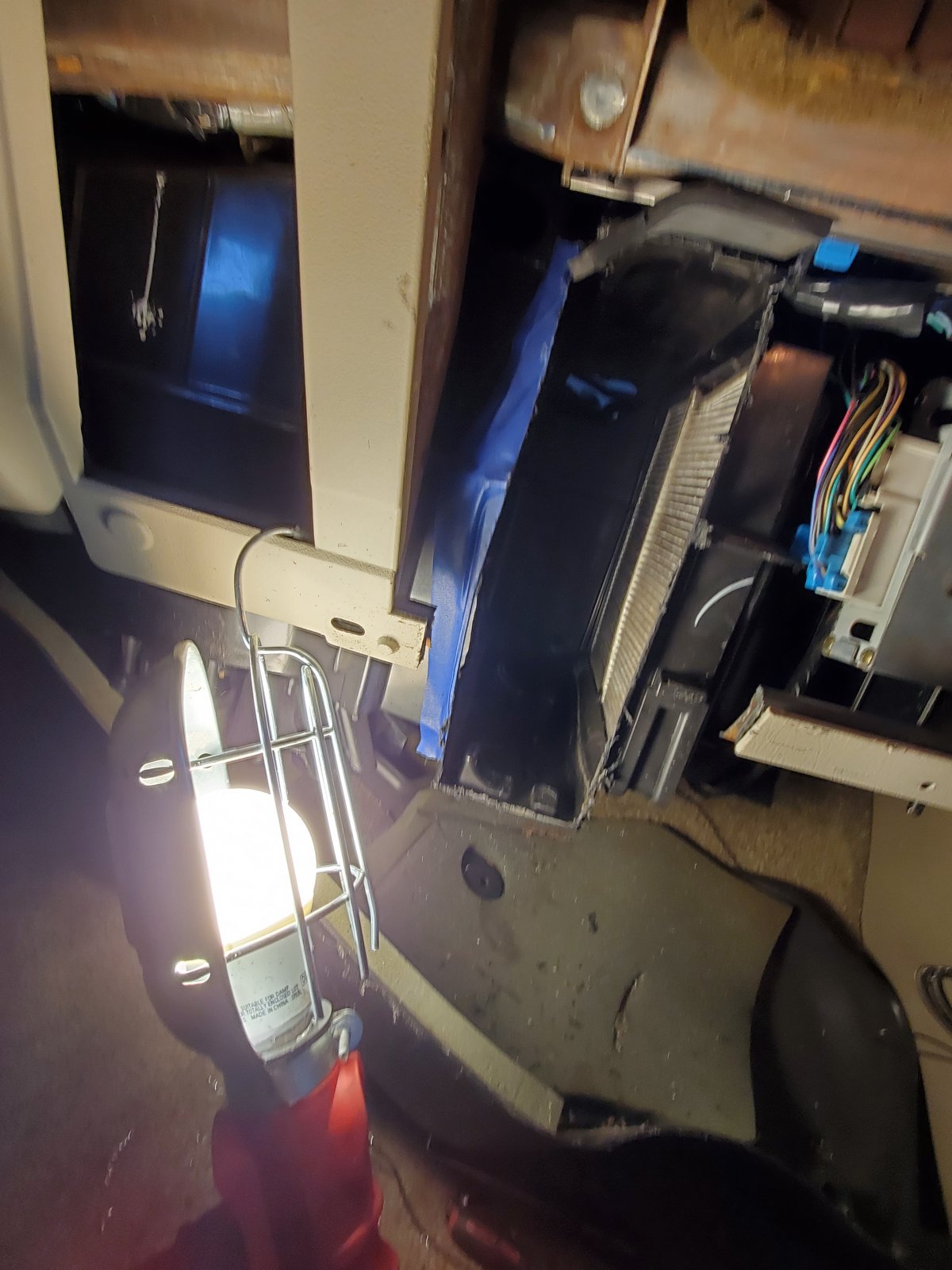

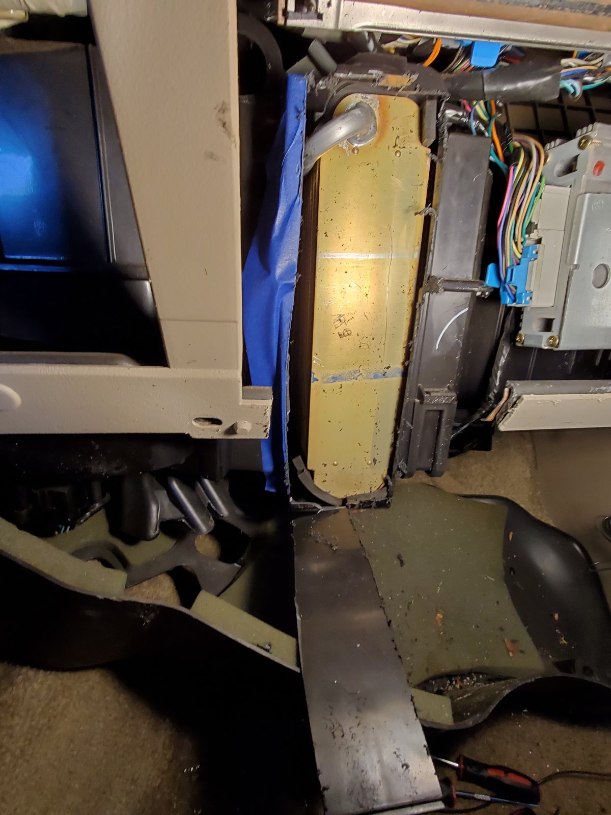

Nice. I did the same job last weekend using the same video. Have any issues doing yours? I tried putting the factory bracket back on the evaporator, but it kept fighting me--so I left it off. I hated to cut anything, but it beat dropping the entire dash.
I didn't have a factory bracket. Just rubber underneath the core and around the edges.
My new core came with new rubber
donmauldin
donmauldin
Jul 6, 2015
29
8
Not really a bracket, it was also made out of rubber and plastic.
I would have never found my leak if I hadn't put air pressure to it. I could hear air pushing out of the core when I put my ear down next to the dash.
