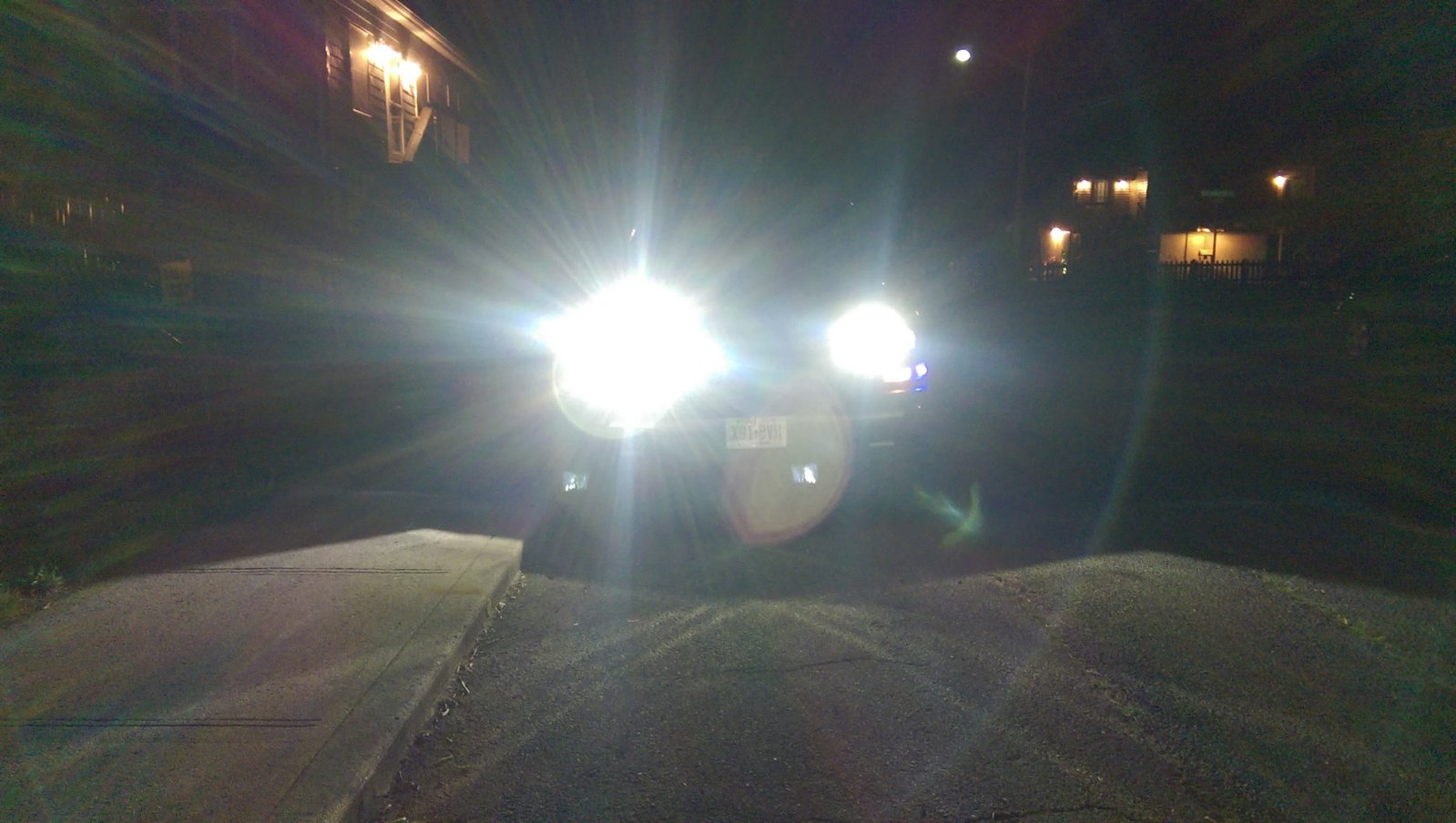

I suppose I COULD tell you that. However, I would be lying. $200 for the bulbs, ballasts, wiring, etc. and $65 for labor. I kinda figured out on my own after a week or so that I may have overpaid...But eh...is what it is and I also don't know the brand or the quality of hardware used either.
I will be going back to the shop come spring time to let them know the setup did not meet my expectations. How they choose to handle my concerns will be the true testament in how I view the $265 I spent. If they work with me to help reach my goal with the lights then I'll consider it money well spent. If not, well it's a lesson and one that I only have to learn once.
How so? Would you mind explaining how LED's in the highs will reduce the warmup on the HID lows? Sorry, I just don't quite understand how that works.
I wasn't trying to be a dick man. Thats just a ton of money for plug and play. I wpuld go back to them asap.
As for LEDs they don't need to warm up like hids do. Once you hit the highs they are at max brightness. Just like LED bulbs you have elsewhere.

Lol. Nah, you're fine. I didn't take it that way at all. My setup currently is exact opposite of this. My highs are halogens and my lows are HID. So basically I would have the brights on for a period of time, until oncoming traffic appeared and when I hit my lows damn near complete darkness for what seemed like forever but was probably 4-7 seconds. FWIW I bothered to look up what I think I purchased: Hylux 35w ballast with Diode Dynamics CNLight 9005 bulbs. So who knows?

Oh absolutely. I hope I didn't come across as wanting to be an ******* to the shop. I'll give them every single opportunity to address the situation. And to be honest, it could entirely be my perception as I have never owned HID's before so it might just be a simple adjustment that would solve my issue of the lights not displaying enough road in front of me. But I can't hang with the no light for several seconds as I transition from my hi beams back to the HID lows. For now I'll just throw some LED's in there and when I have some more time I'll likely go bixenon.
Do you remember what temperature bulbs you got. For best output stick to 4300 or 5000k any higher than that you get more color but sacrifice output

Let me know what you decide cause I'm having the same dilemma with the lights I have.
I installed HIDs and Had the same issue, when to Painless website and bought the wiring kit to have all 4 lights on when on high, not in the dark 3-4 seconds anymore. They will burn the leaves off of trees at a hundred yards!
