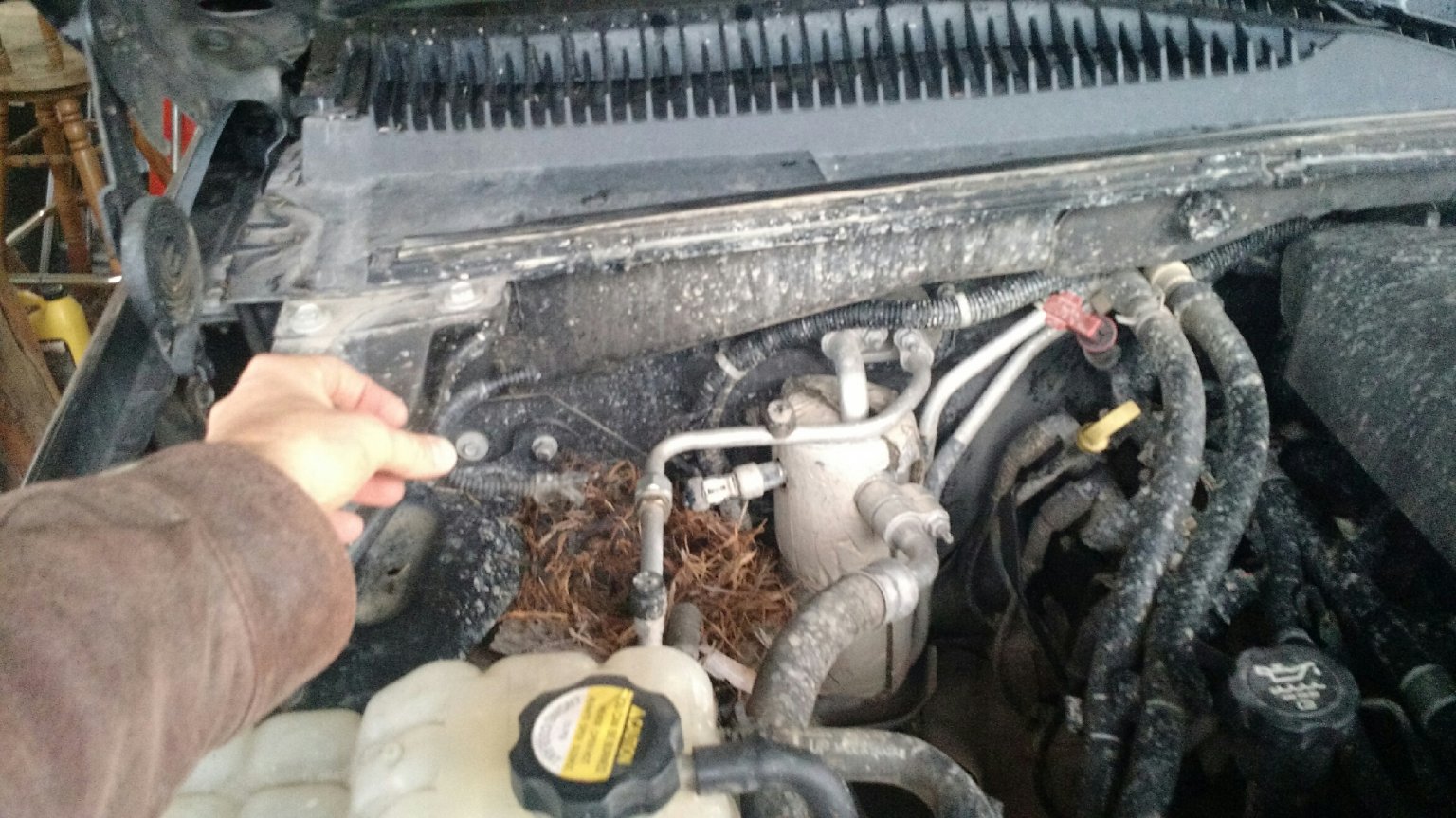

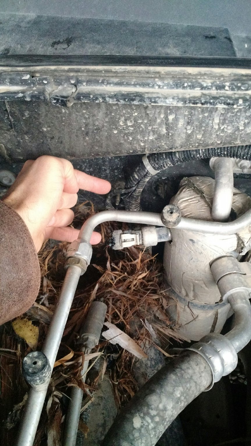

I live in the country and a wood rat built a nest under the hood at the passenger side firewall. I've attached photos. There was one wire set that was damaged, as pictured, and I repaired it and reconnected.

At first I thought the two wires that the rat chewed off was making a strange control circuit and forcing the fan to turn on High and stay on. But I repaired the wire and it still is staying on if the batter is connected.
