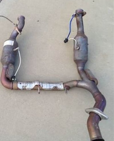

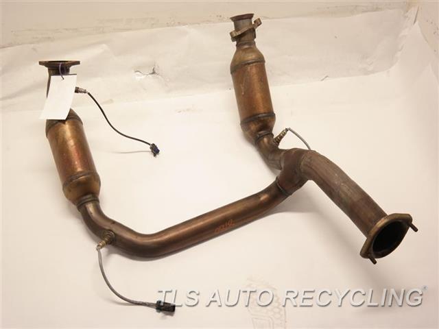

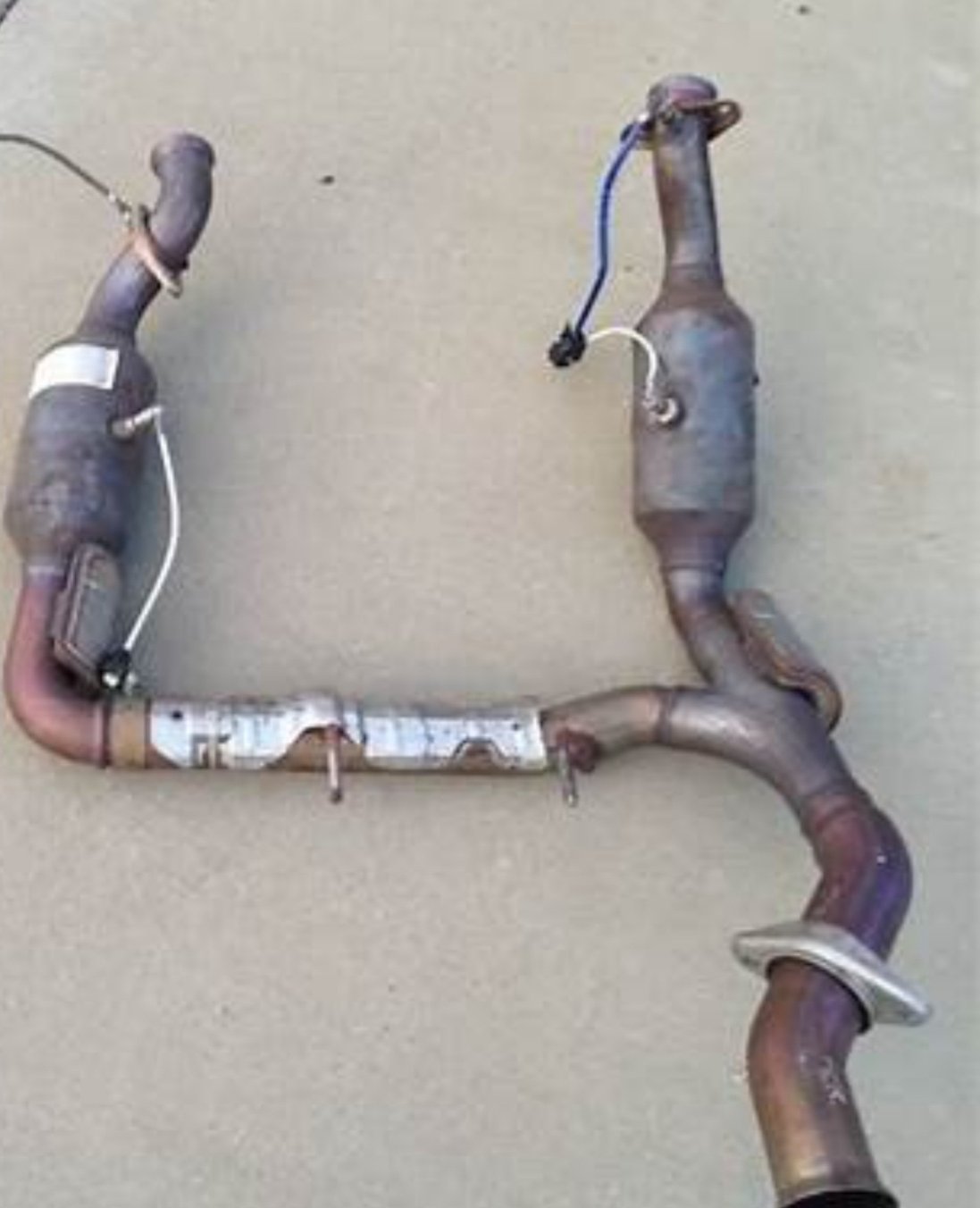

This is what I have found so far. 07 is on the left and 09 on the right.
5 things I notice
1. O2 locations
2. extra hangers on the 09 in the center section
3. 09 has a 90 degree bend into the center section and the 07 has a 45 degree. Must be for clearance.
4. not sure what flanges are used on the 09+ looks like 2 bolt, I'm pretty sure the 07 has a 3 bolt at the manifolds.
5. where the two merge is definitely
I'm going to get analysis paralysis from over thinking this.

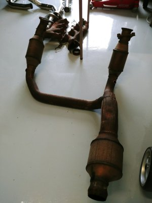

My Y-pipe looked nothing like that one on the right. No O2 sensors in the cats, the angles look wrong for an LS in our trucks too.
@badandyturbo has a picture of his cats in the background on a photo. He's not on the forum anymore but the posts... Lemme look...

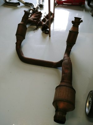

Here you go, there's a pic of a stock 6-speed Y-pipe in here:

I've never seen a Y-pipe like that "09" one. The one James posted looks familiar. Mine from my '08 definitely matches the "07" pic. My bud's '09 is almost identical but has that third cat and ball flange.
I'm glad I posted this. Thank you for popping in, I certainly do appreciate it.
Looking at badandyturbo the 09 I posted looks nothing like it.
Man I can't thank you guys enough for sharing this. I even commented in his install thread haha.

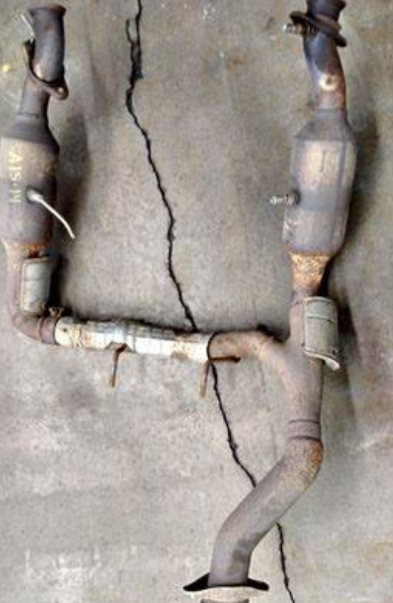

Another 09 + supposedly unless I'm loosing my mind, looks like the same exact one as above but a different angle. No idea what it is off of though.
He sent another one but it was a clamp together 07/08 model.
Looks like I'll be pulling mine off and going from there.

Never in my life have I seen O2 sensors inside the cats. There is no way that's a GMT900 truck with a gas motor.
