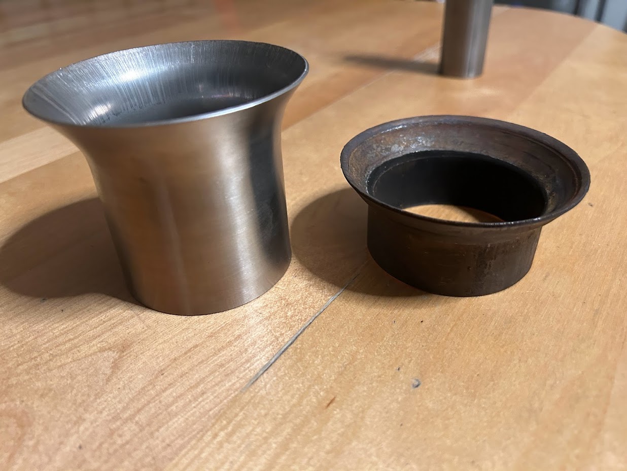

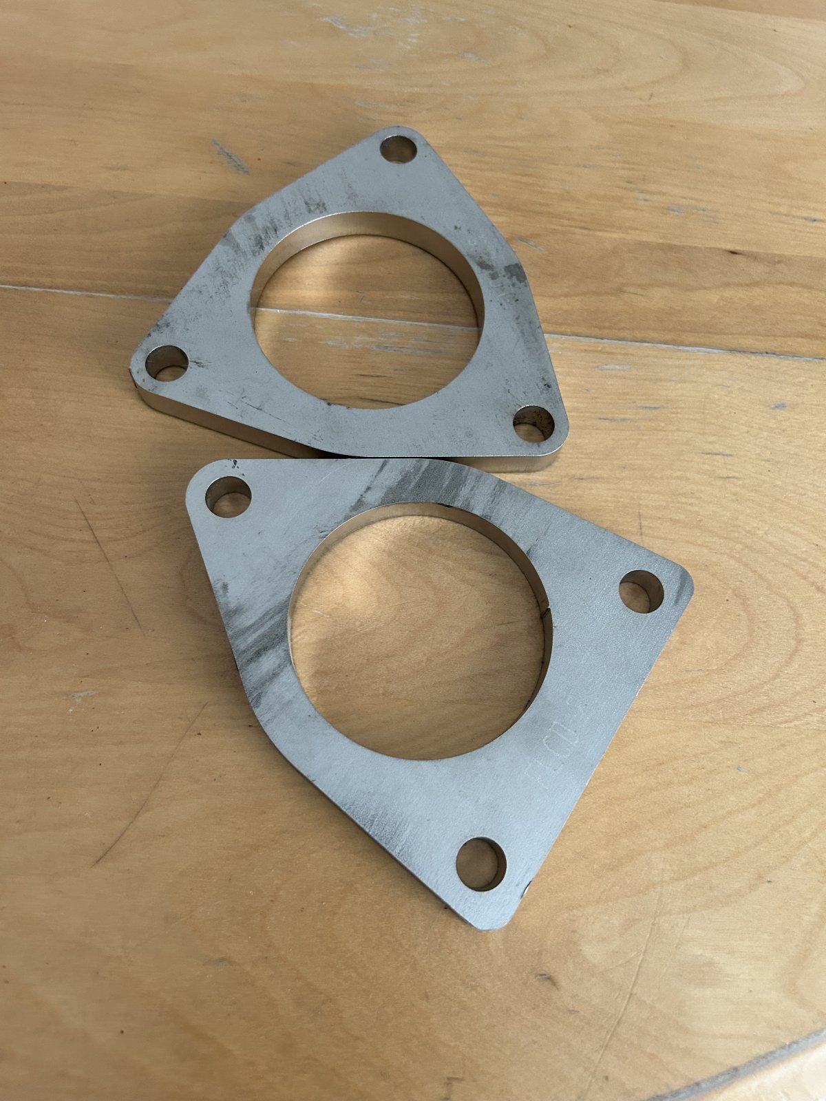

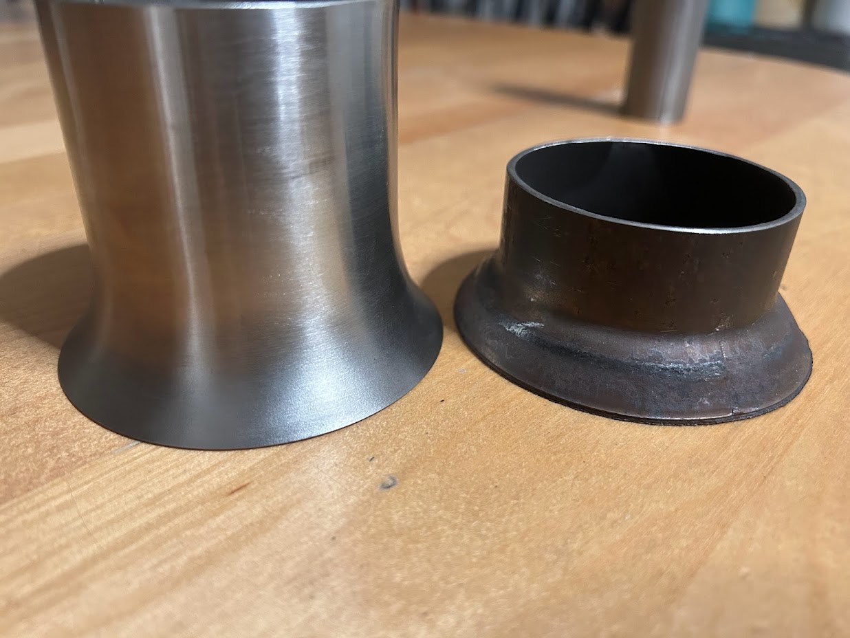

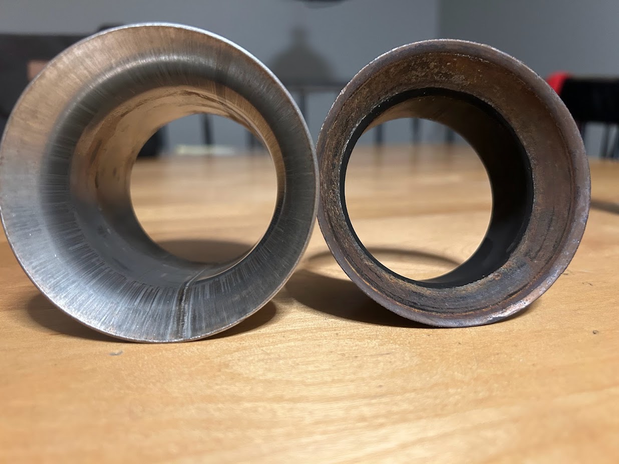

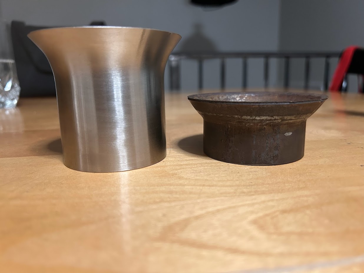

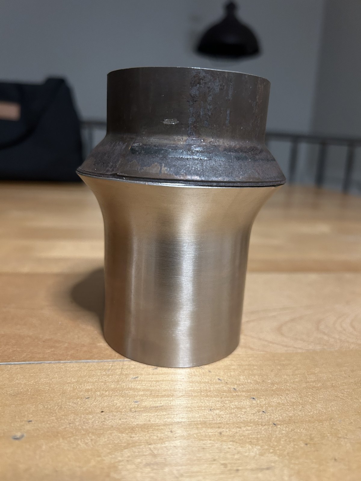

I ended up finding a 6.2 Escalade Y-pipe (it's pricey @ $1199 but it's the only one I could find) last night and wow what a difference, it is dramatically larger than the 5.3. I really don't think I'll be buying it though haha.
Like you that is my future plans for mine as well. In the meantime I was going to be making a 3" system instead of a 2.75". I have an unlimited amount of 3" and I don't think going up to 3" will make that much of a difference besides the sound. I'm not looking to gain anything I'm doing it for the sound :)
If I did buy it, it would give me the benefit of making all available sizes for our model GMT900 SUVs. Between the base models like mine to the Denali and lastly the Escalade with its beef of an exhaust. I think they vary from 2.75 base model to 3" Denali and 3.5" for the Escalade.
