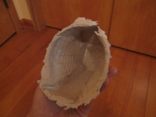

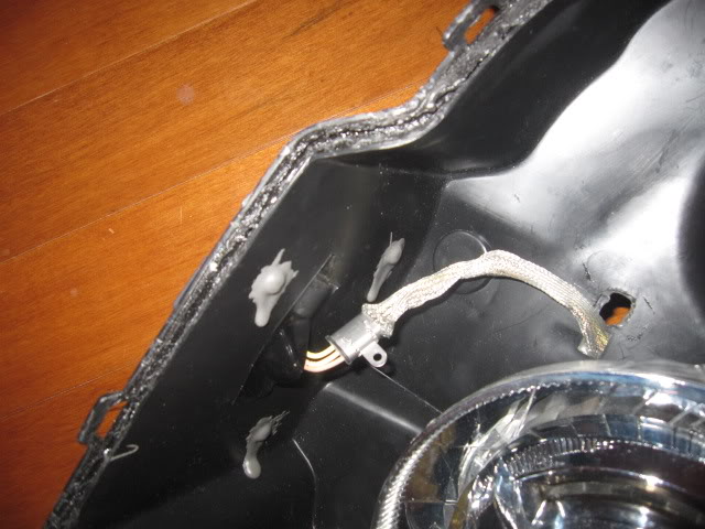

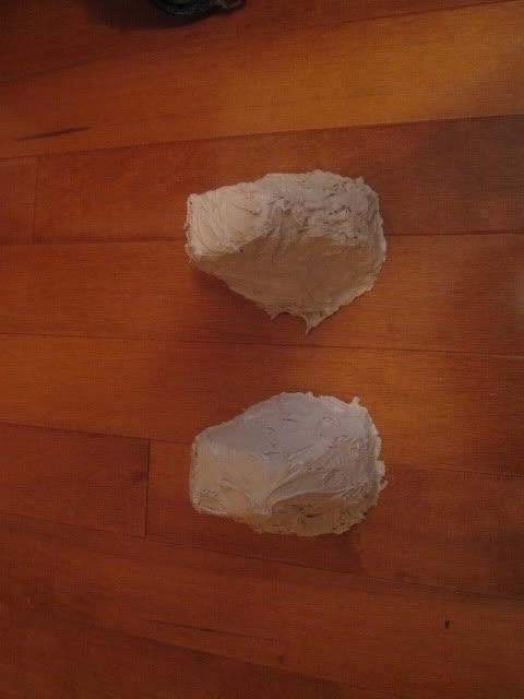

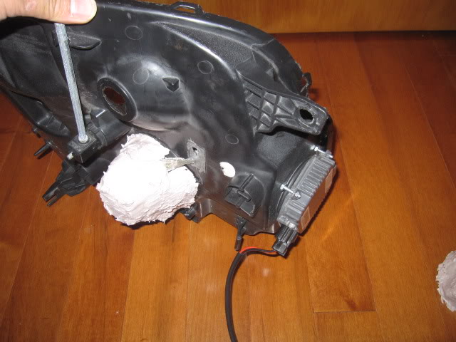

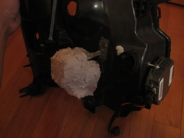

waay too long to finish this project, but I am ALMOST done :). Here is the updates.
I used the extra lens that I had to make a faux projector for the orange light instead of keeping it stocked. I almost ruined it using super glue though. Here are some pictures of the almost finish light.
I tried to resist temptation of adding the halo, but after adding it I think it came out clean.
All that is left for me to do is to seal the back of the housing, then install the front housing and I am finished. Hopefully this thing will be on the truck mid July.
