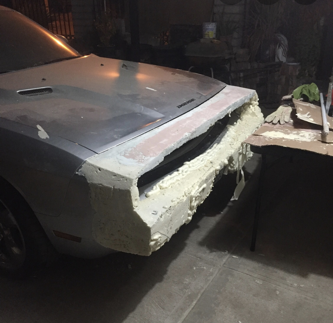

I got to thinking more about this and remember reading about using styrofoam to temporarily attach to the body as if it’s the roll pan and then shaping it the way you want it while it’s attached to the truck somehow. Then you can make a fiberglass mold from that. I do believe I’ll be trying this and when I do I’ll post the results.

Of course you’ll have to glue a few thick pieces together and reinforce it to include both the quarter panel areas.
