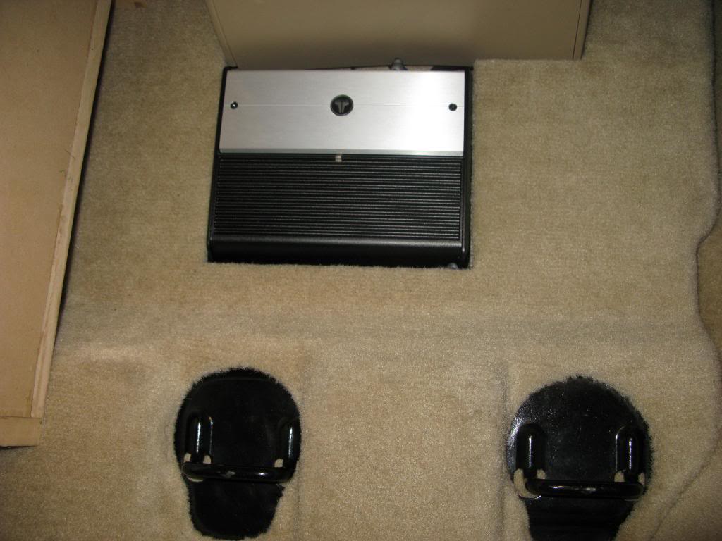

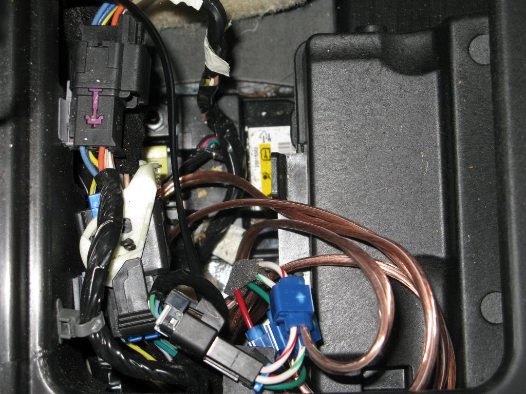

Tapped into the signal going to the factory Bose sub...this is located right under the cup holders. I ran the speaker wire to a Stinger LOC that I mounted under the plastic cover under one of the second row seats. Found out later that my amp didn't need a LOC...

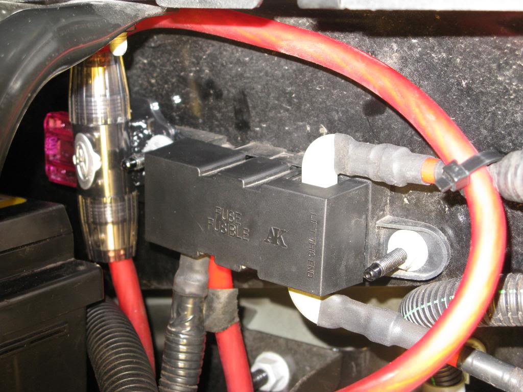

4 gauge power connected before the main fuse...

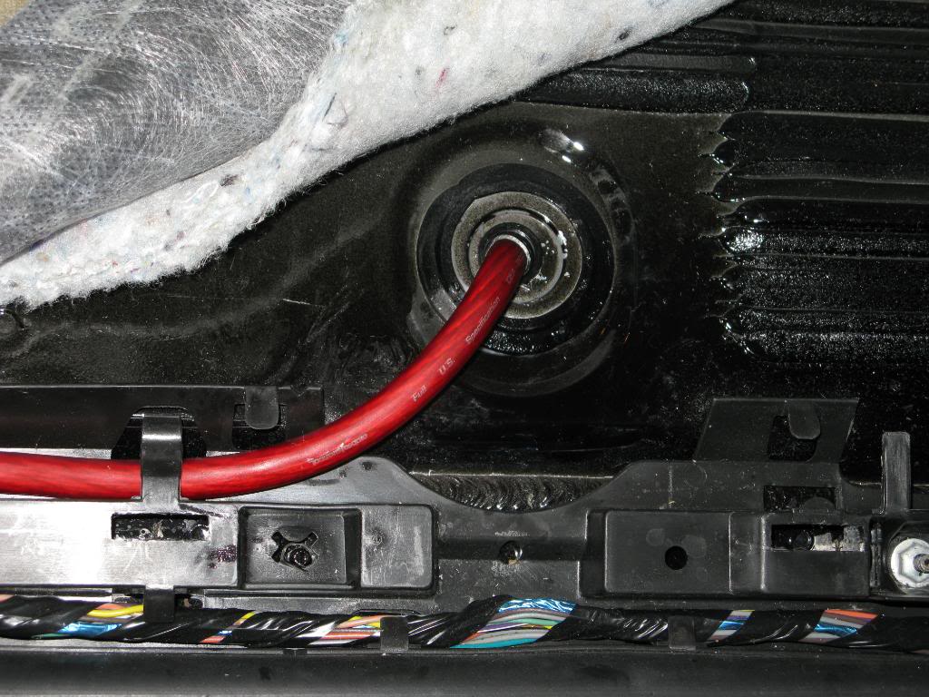

Brought the power cable through the passenger side floor
Got the 12v remote from the sixth pin (zip tie pointing to it) on the orange "block" this is located on the driver side above the parking brake...
Amp installed...this thing is tiny

how is the sound quality being tapped in on the stock sub? what convertor did you use?
I think it sounds great. I used this stinger:
http://www.stingerelectronics.com/productDetails.aspx?ProductId=109&CategoryID=3
The retail on their site says $51.99, but you can find one for around $15.
