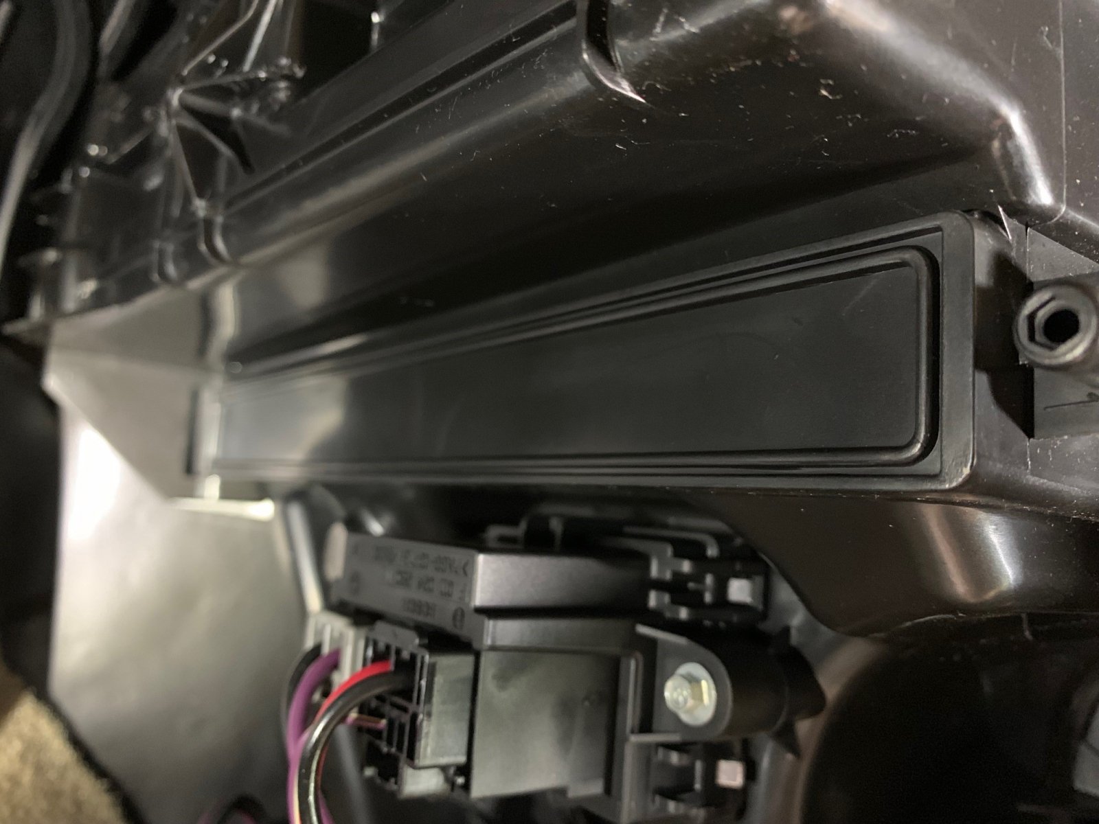

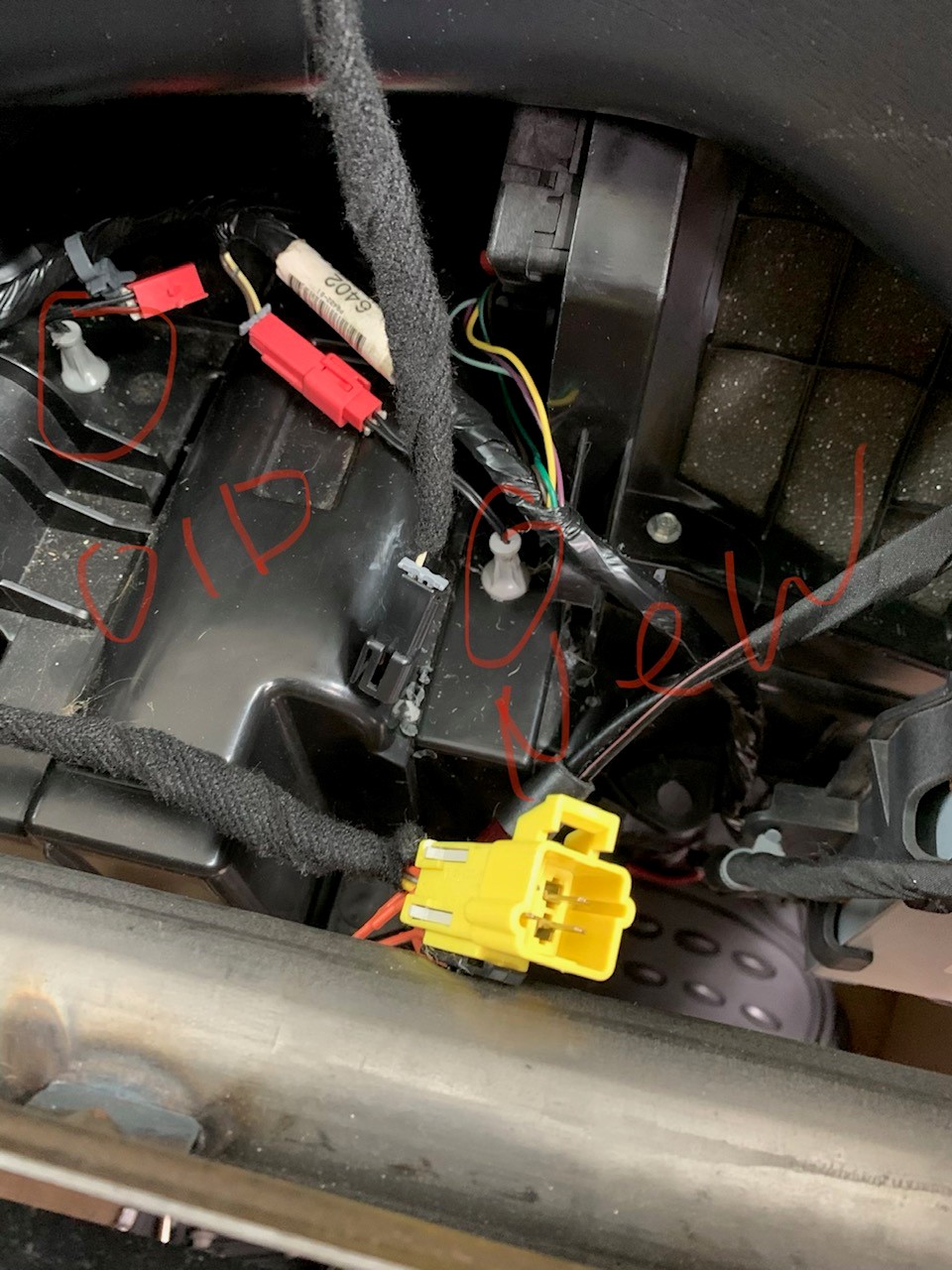

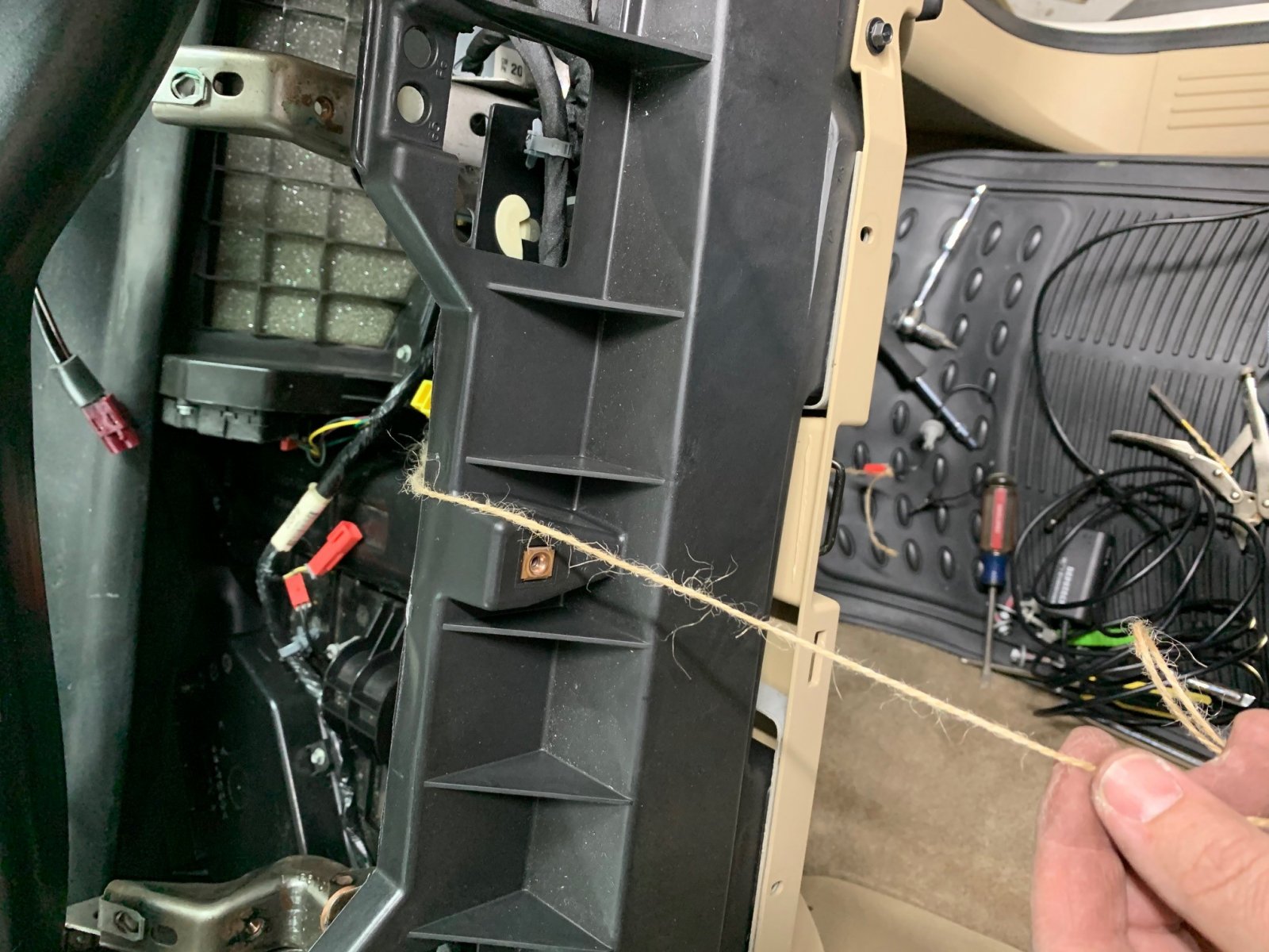

I had a similar situation in my ‘11. The AC wouldn’t cycle off, evaps would freeze over. Nothing would blow through vents even though fan motor was blasting full strength. I tried resetting vent flaps/recalibrated actuators/etc. Turning off the compressor briefly would solve the problem for a few minutes, then I’d have to do it again once it froze over again. Shop checked pressures/drew down/recharged. Everything ‘worked fine’. What I was doing was essentially ‘cycling’ the compressor myself. Found out eventually it was a bad evaporator temperature sensor. The sensor was ‘telling’ the HVAC computer the evap temp was 189 degrees. So it was always running. Never cycling off because it ‘thought’ it wasn’t getting cold enough
. Sensor is like 12 bucks....but it is mounted inside the air box completely in-accessible without removing the entire airbox...16 hour shop time per manual. Major $$$. I did Replace mine by doing a little cutting/drilling and placing it where the air filter is supposed to go on the accessible side of the evap. Took about 1.5hr total in my garage. You Need to remove airbag and need a dremel, but it’s doable without a major job. Completely fixed my cycling issue. Now it cycles on and off as I would expect it. Hasnt frozen up since. Can send a write up of what I did if you think it might help.
