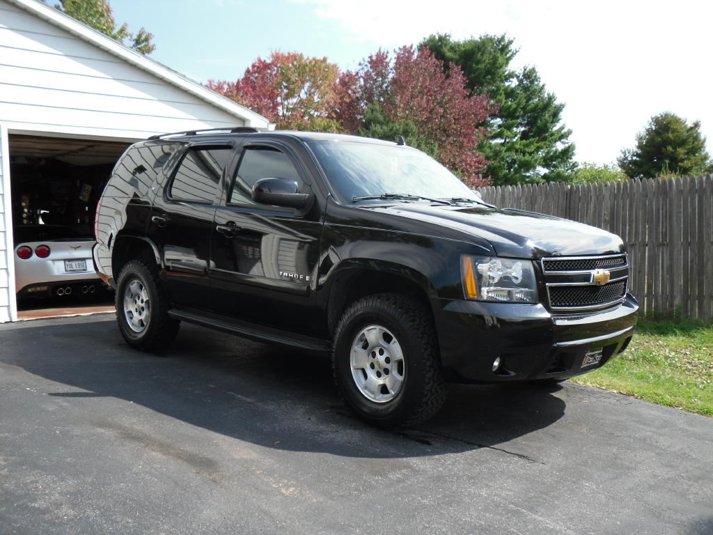

I did the 2.5/1.5 Ebay kit on mine. It was a piece of cake to install... and in my opinion, puts the truck where it should have been when it left the factory.
I have BFG 285/70-17's on mine and they have plenty of room to spare. Probably could have gone bigger yet.
Really didn't notice any loss of performance with the taller tires...(I also have 3.73's) but it rides much nicer now.
