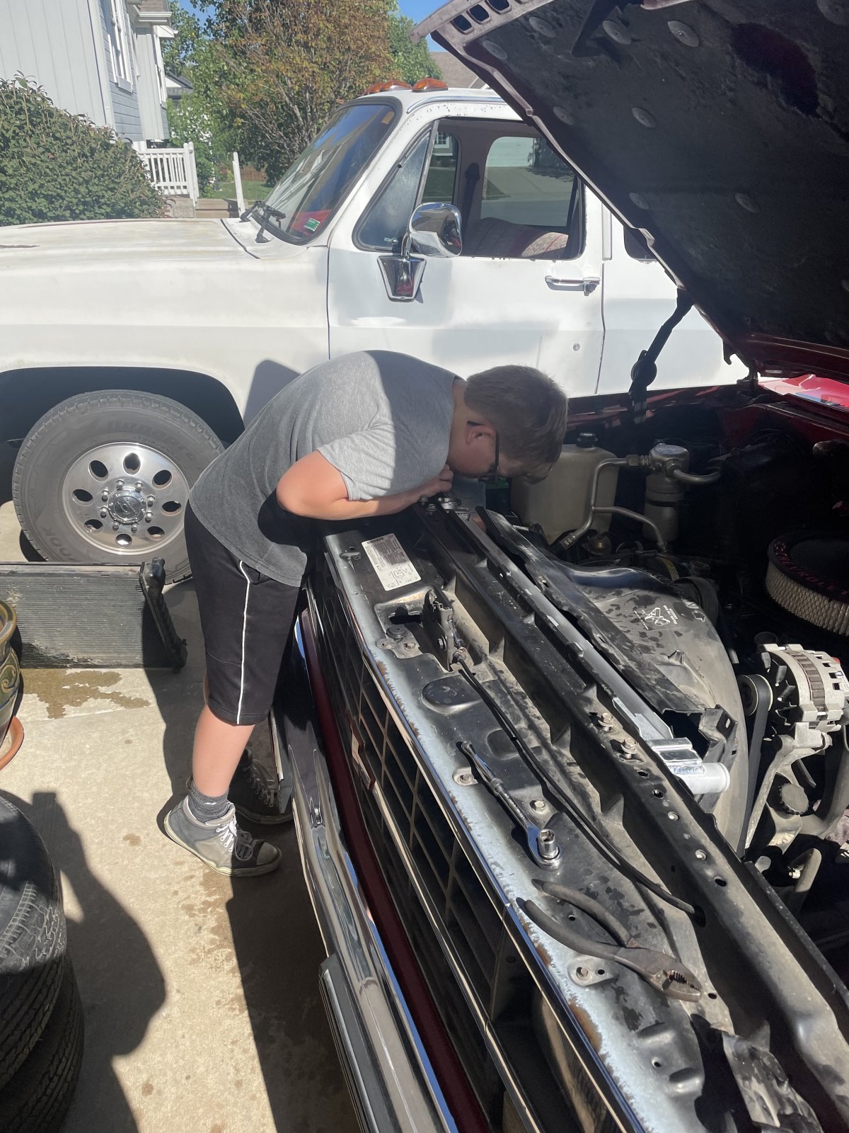

Ordered an Aluminum radiator and hoses off Rock Auto. That order should arrive either Wednesday or Thursday
About to order up some new gauges (Dakota Digital HDX) and some replacement helper bags. Hope to have that stuff ordered by the end of the day.
I guess there goes that idea of not needing to tinker with it much :happy175:
Gauges and helper bags ordered tonight. I’m being told that the gauges may take a couple of months but that’s ok.
Also rear, has some Belltech nitro drop shocks. I’m going to throw those in the trash and replace them with some stock size Bilsteins with shock extenders when I replace the bags.
FedEx says radiator and hoses should show up Friday. Plan is to knock that out Friday so that I can get to driving it again this weekend.

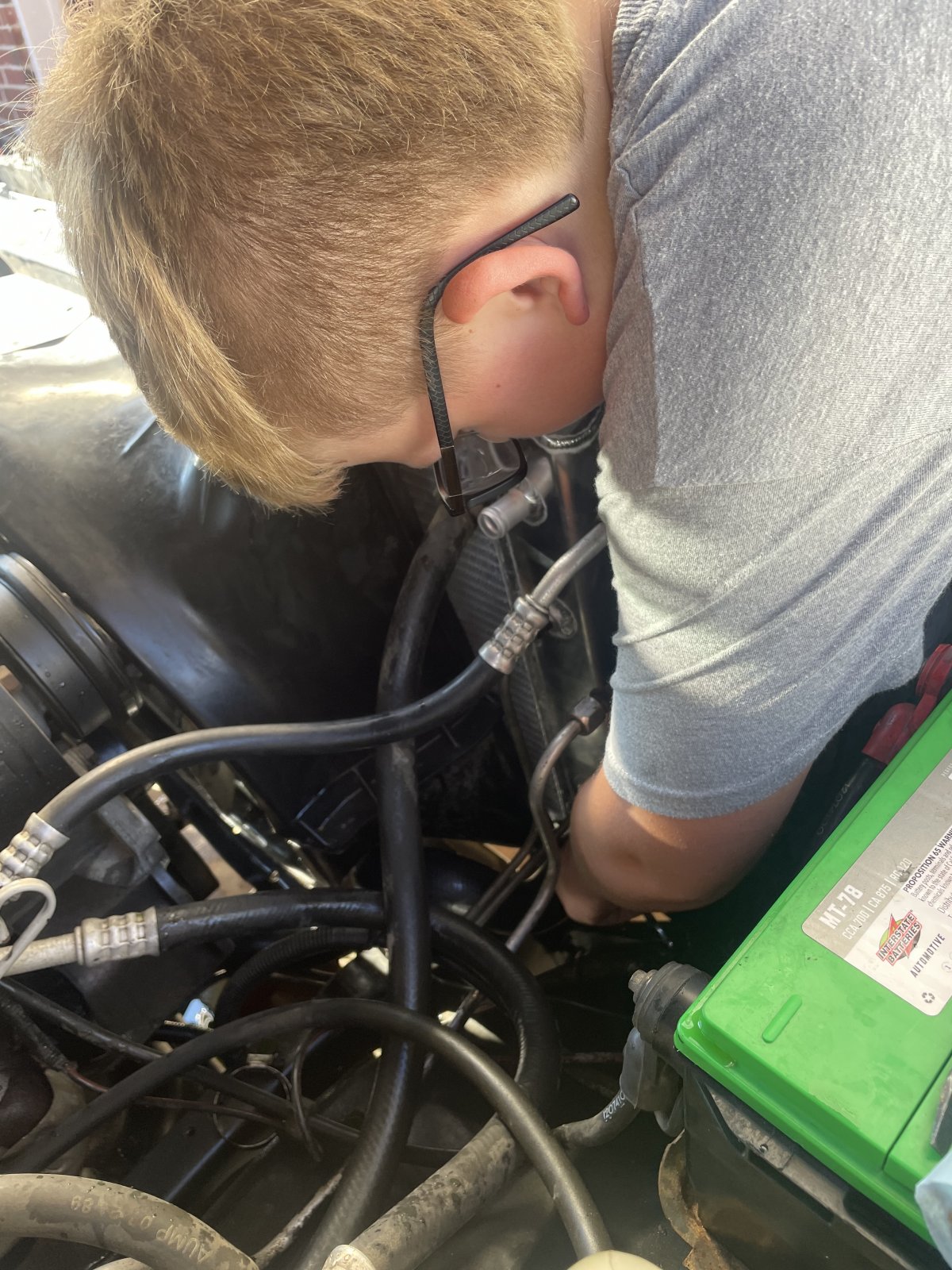

13 yr old has asked to help with install so we’ll tackle that today or tomorrow :)
