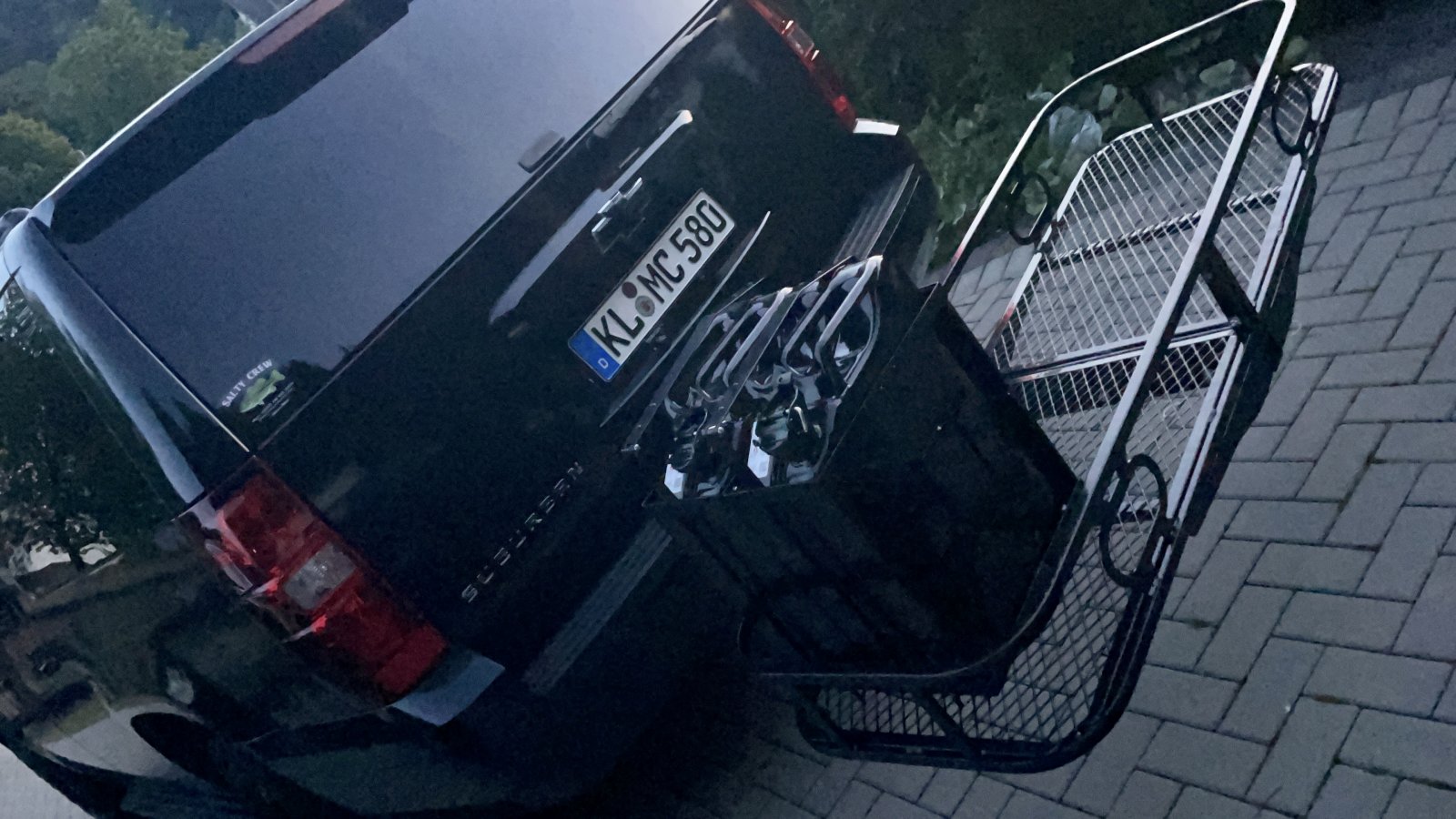

I’ll be going on this trip alone, so plenty of room to take stuff,
was going to take a proper Jack and Common Tools aswell as 4 jerry cans and two spare wheels,
Just outfitted the truck with CB and ham antennas aswell as LTE booster antennas.
