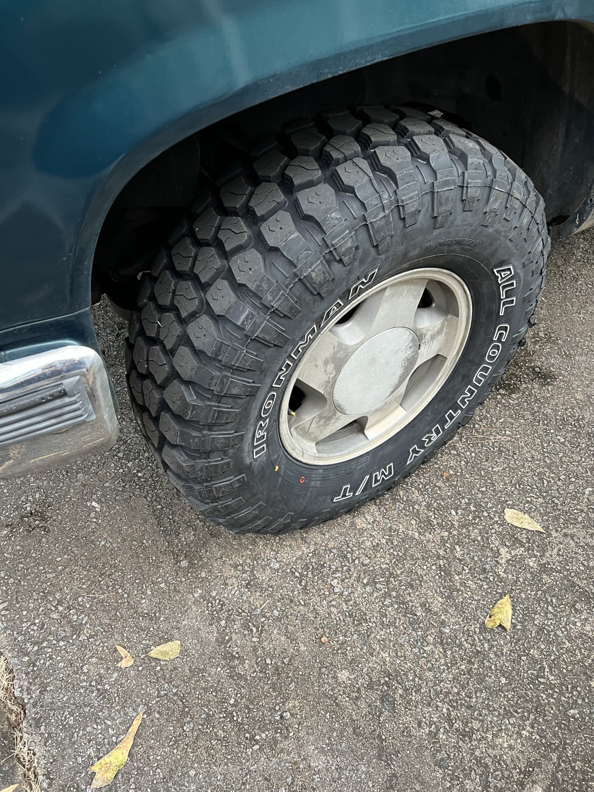

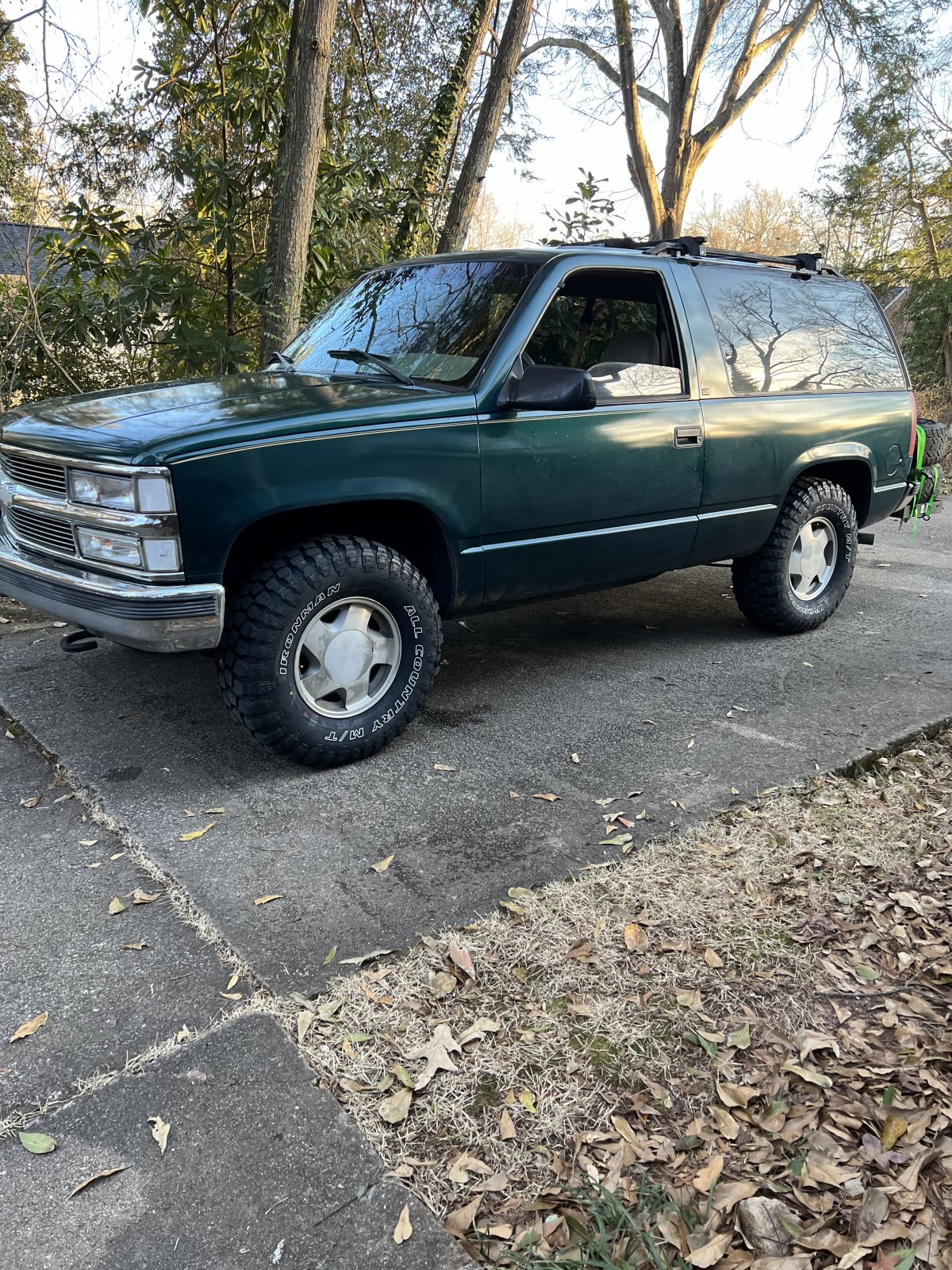

Got the Tahoe back from paint and installed the new starter. The ticking has stopped thank God. Next will be some new crossbars and then will probably start on front suspension and steering

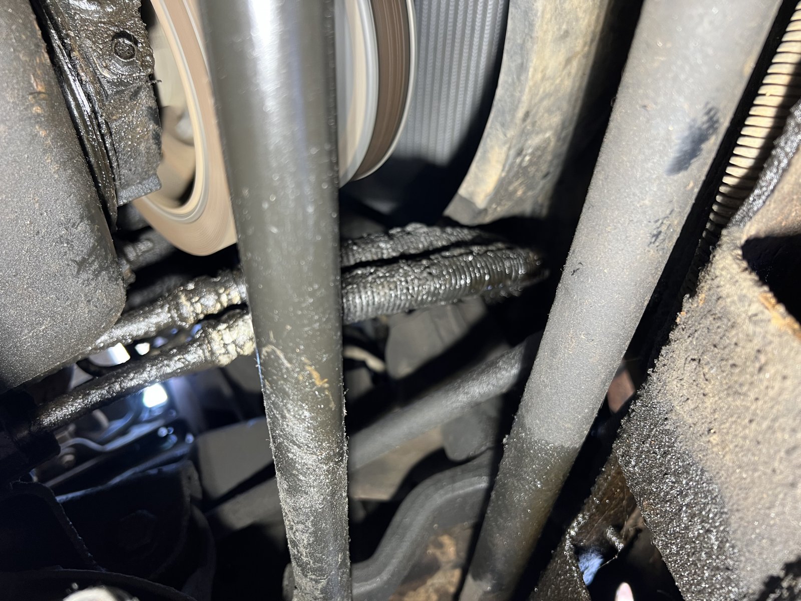

I got the roof rack installed other night. It’s a simple one from sportsman’s warehouse. I also installed new 4x10 speakers in the rear. The Tahoe is going into the shop on January 16 to have the front end completely replaced. I wanted to do it myself but decided against it due to work and other time factors.
One thing I’m puzzled by currently is on the passenger side floorboard the carpet always seems to be wet. I see nothing leaking and haven’t found a source of the moisture. Has anyone seen this before???
