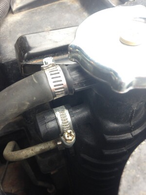

Just a heads up, most aftermarket radiators have a port that is not used on the 5.7 vortec. They’ll install a cheap rubber cap that will crack and leak after a while. The one in the picture was maybe a month old. So, replace it with a silicone cap and it should be better.
Or, get a GM/Delco radiator which doesn’t have the unused port. That’s what I eventually did with mine. One less thing to worry about, you know.

Thanks for the heads up. The current radiator on the truck has that port. I did have to replace it a while back. I ordered the Denso radiator. From Rock Auto. Hopefully it will work out.
