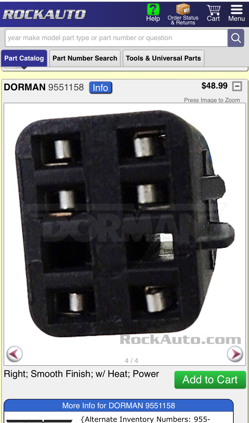

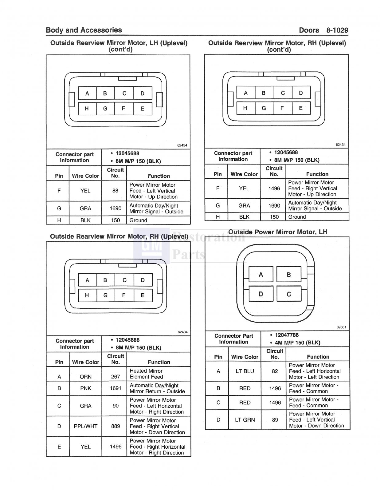

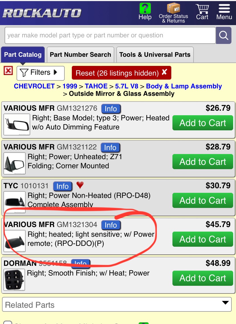

Looking at Dorman’s listing on Rockauto, it looks like they just delete the two pins for the auto-dimming function. Those are B and G in the connector view below for a 99 model.
So, yes, it looks like they would connect. I see that Rockauto has another listing for a mirror with the heat and auto-dim. I’d question whether those actually have the auto-dim given the comparable price, but it may be worth checking into.
Aftermarket mirrors tend to be hit or miss with vibrations in the glass so save your receipt. If you happened to find a GM part that would be the way to go but they’re pretty scarce from what I understand.
In case you were wondering, the standard non-heated or dimming power mirrors use a four-pin connector and wouldn’t match your eight-pin.

That's crazy if true. Worth me calling them to confirm at the very least. Thank you for that and the pinout!
